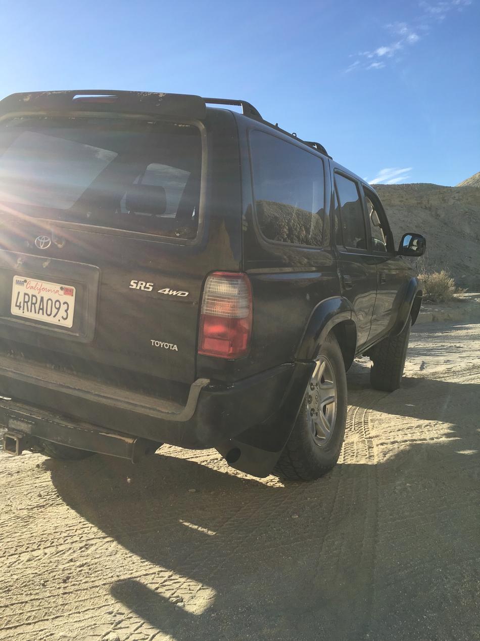

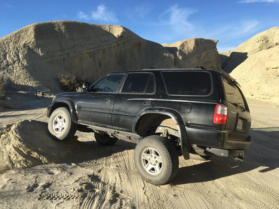

Hey guys just looking for some input on my flex, or lack there of.
Icon coilovers/shocks front and rear. Have them paired with OME 890 in the rear. I purchased these springs with the intent of adding extra weight but that has not happened yet. Has anyone had these springs limit flex at stock weight?
Here are some pics from earlier today. Front sway disconnected, rear connected but with longer links. This was max flex before the rear tire would lift. You can see im still about ½ inch or so away from my extended bump stops. Not the first time I've noticed the issue but I didn't really think about the spring stiffness being the cause.
Thanks in advance!

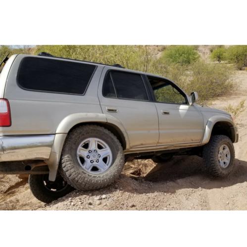

Here is a pic of my 3rd gen on 890's with the truck completely empty/ No added weight.

Really appreciate the feedback. Process of elimination does indeed point towards the sway bars. I will disconnect and report back what I find.
