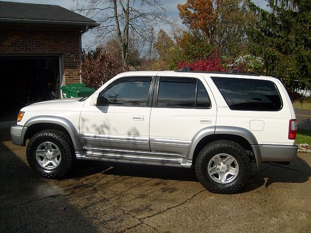

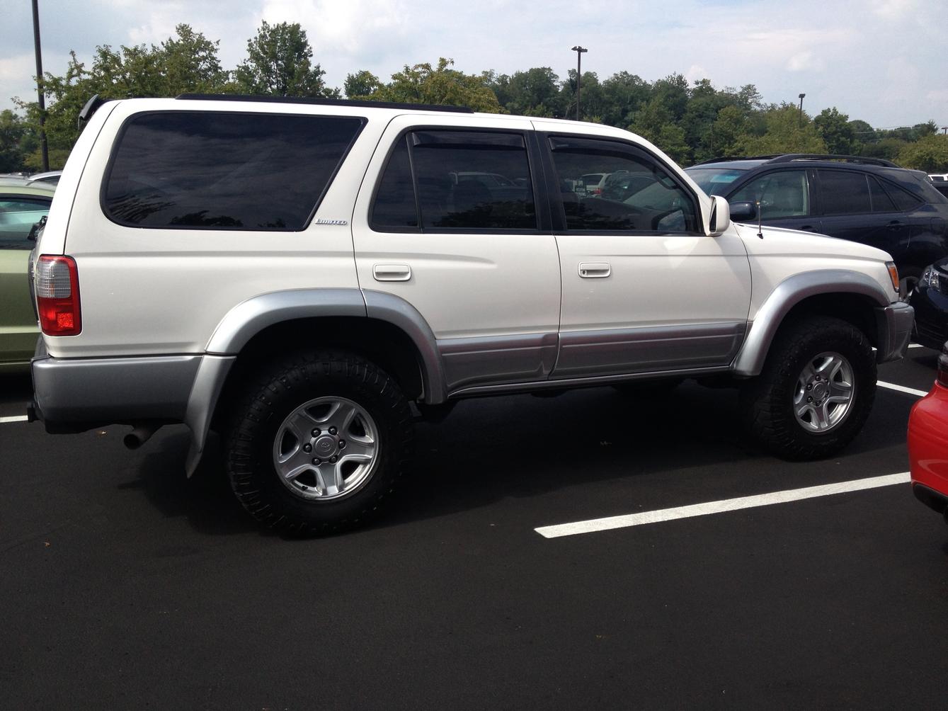

The new springs are in and I could not be happier. The ride is much more stable but not too stiff. I loaded down the rear with 200lbs of weight and it only dropped about 1/4" inch. Before it dropped about 2-3".
2" of lift is a joke though. I now only have 1/2" rake which is perfect in my opinion. The front is 36" from the bottom of the fender to the ground and the rear is 36.5" respectively.
Before and after pics.

There will be some rake. If you want it dead level, get the Toytec 1/4" top hat spacers up front. I ran this combo on my first '99, I loved.
No, do not do this, if you run with any weight in the back it will level it out over time, and long enough it will sit lower than the front without the spacers.
