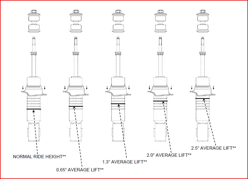

You are wrong. Bilsteins don't have a spring. There is an adjustable perch which affects ride height. There is plenty of info here and all over web. Just search. YouTube videos might help as well.
The Bilstein 5100 compresses the front coil spring to gain height. It will increase the spring rate, but only slightly. It will be a firmer ride, not stiffer like a heavy duty spring.
To answer your question, YES, you can keep bumping up the clip to gain height, but you WILL need an aftermarket upper control arm to allow for proper alignment. The 5100 series Bilstein (part #24-186711) has 4 clip settings. The lowest being stock, the top being 2.5". They go in 5/8" increments. I would start at 2nd clip from bottom and go from there. Remember the height will settle (slightly) once installed.

I agree with AARONR, start on the 2nd setting .85. 2nd setting with OME's will prob be 3" lift
Here is an easy description of how the 5100's work. These are not the 5100's for the 4runner, these are Tundra ones, but its the same concept.
