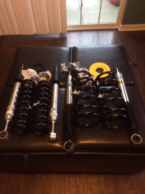

Christmas in July:

Happy America day everyone...
Hopefully someone can help me out with this, I can't seem to find a straight answer for my application anywhere.
1) What is the correct orientation of the washers/bushings on the front AND rear Bilstein shocks? My shocks came with all the hardware, but no instructions on order of the parts. I've seen many posts with different instructions, just want a straight *and correct* answer :becky:
2) The rear "trim packer"(yellow spacer in photo).. The opening in the middle does not look wide enough that my cone shaped bump stop will fit through it. Does it go: body, spacer, bump stop, spring? Whats the order for that?
Thanks again. I'm going to hit some BBQ's today and tackle this tomorrow. You guys have fun and be safe!

This shows the orientation for the front:
2005 Toyota 4Runner Parts - Conicelli Parts Center
And on the rear from top to bottom it should be nut, washer, bushing, frame, bushing, washer, and shock.
For the rear trim packer, you have it correct. The spacer sits on top of the bump stop. The trim packer is lower in the center than outer edge (there is a top and bottom).

Thanks ARK.. So the washers are cupped, I'm assuming this is the way they should sit. Also, the bushings have a raised center, assuming that will fit into a spot on the frame as well.
