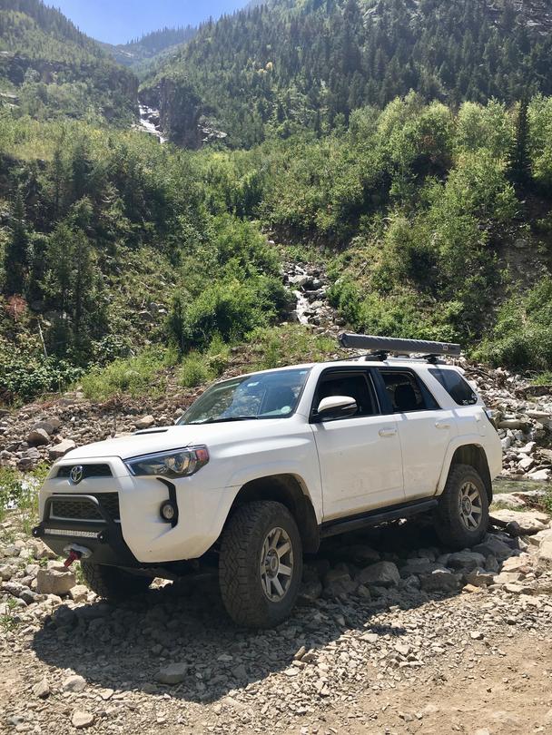

I have almost the same setup and have been riding on BP-51's for 3-4 months. They are as quiet as the stock suspension (not sure why people say different) as in I never hear anything, smoother on and off road, especially when loaded up for a weekend in the mountains and mine were about $800 less than the comparable adjustable Kings. Just sayin...
