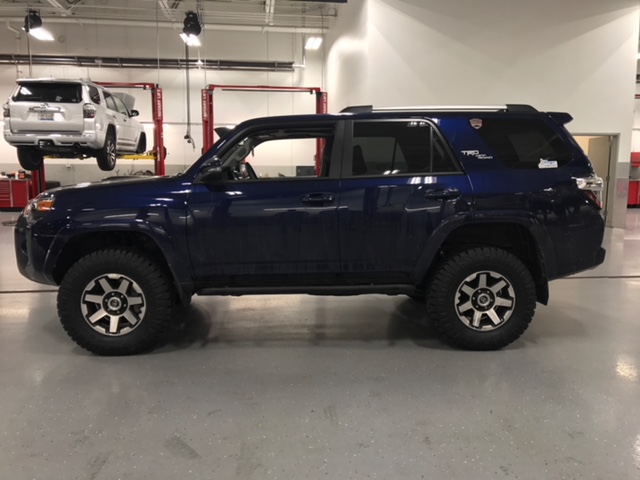

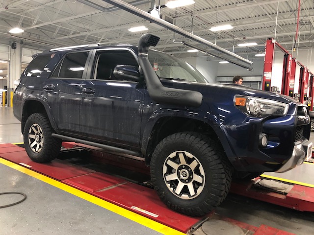

I did that kit and went with the medium load springs (885) for the front as I will be putting on a front bumper in the next few months. Here is how it sits. Tires are 285/70r17 Ridge Grapplers. It has a slight rake but I like it. When I tow my snowmobiles it will level out nicely
Pictures were taken right after lift and tires were put on
Thanks SR5Bart. How is ride quality on the 885s without a bumper? Now that I think about it, I do want to get a Southern Style bumper possibly in future.
The ride is good. Little stiff which is to be expected but I really like it man. I chose this kit over the Bilstein setup for what I intend to do with the truck. I will also be doing the southern style bumper

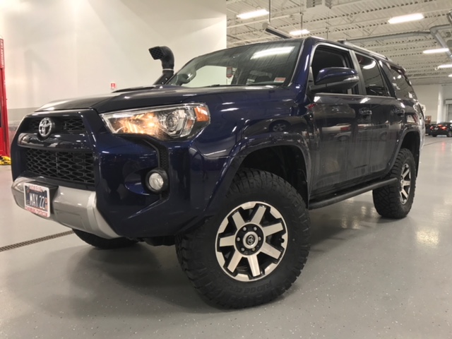

I have these on mine
OME 2884 - Front Springs
OME 90010 - Front Struts
OME 60080 - Rear Shocks
OME 2889 - Rear Springs
I think it ended up about 2.5" of lift. No front/rear bumper yet but do plan on adding those --I was told that these will do just fine with the additional weight.
The ride is really nice. I have the BFG K02 285s on the truck. No complains so far.
Any pics you can show us??? :D
