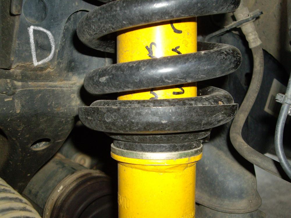

So I had my OME lift installed by a shop Monday. Everything seemed OK until I got to work today and thought that the settling of the suspension looked more like sagging. The front was really raked compared to the back. I looked underneath and noticed the front spring perches on the shock body seem like they are unstalled upside down. My understanding is that OME spring perches are like a "bowl" and they cup the spring. On mine, the "bowl" part is facing the ground. They don't look like the attached picture, borrowed from another location since I couldn't find a good close up shot.
Obviously I'm taking it back to them to fix. My questions is, for anyone who may have encountered this situation- will any damage to the strut assembly occur if I drive it for the next couple days until I can get it in to the shop?

After looking at it again, it shouldn't be a problem to drive it until Saturday when the shop can get at it. I can't see how the spring can slip off the perch, despite how bad it looks. The inverted perch has the same indent as if it were installed correctly. The stock spring perch on the XREAS shock was just a flat ring, so if the spring didn't pop off, it should very well stay on the OME shock. About the only thing it's hurting is ride height.
