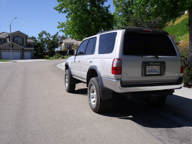

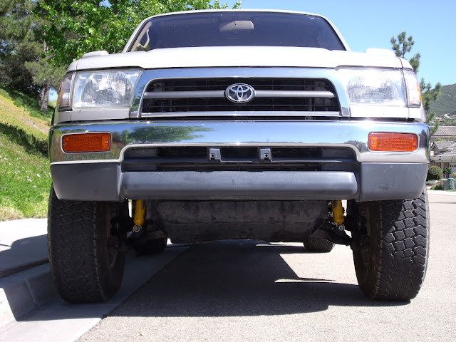

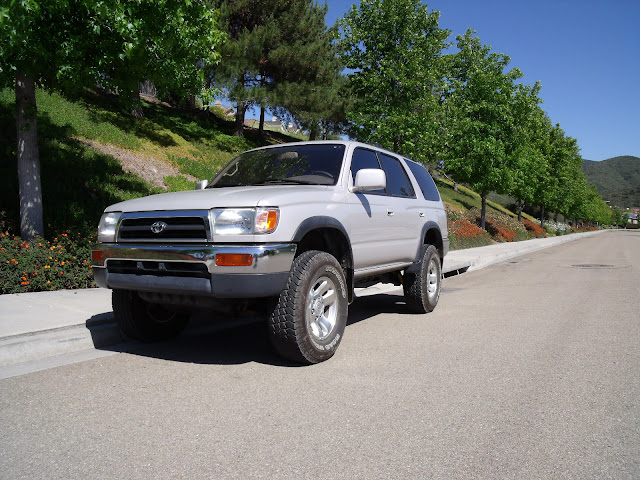

OMG what a difference! It feels like i'm driving a different vehicle. It feels more stable, its more responsive, and braking feels so much better. Before when I hit the brakes my truck would nosedive but now its rock solid. Love it!
OME 881/890 w/ OME Nitrochargers and Toytec Diff Drop

The install wasn't too bad. It took me and a buddy 4 hours on the front and about 6 on the rear over 2 days. That's including various breaks for food and such. We also had to make a couple tool runs to home depot. I think with more people and the right tools it could be done in one day for sure. We had to get a strap wrench for the rears but it made our life easier. Can't wait to hit the trails!

looks great and appears to be sitting very level. Many of us have the 881/890 combo and love it.

It was satisfying to do it ourselves. When we ran into issues we just stopped, looked at it for a while, and figured it out. I had only done suspension on hondas and mazdas so this was definitely a new experience. Yea when we first lowered it off the jack stands it had a HUGE rake but it has settled nicely since and I am very happy with the stance. I am in need of some mod bug repellant haha...I am already thinking of roof racks, off road lights and the like.
