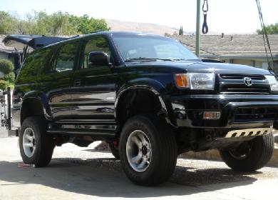

for me it was just to clear the tires more. when i had only 3" suspension it pretty much looked like stock hieght but leveled out when my 4runner was loaded. the BL is alot easier to install then it looks. you only had to move the front bumper up 3" with a plate that is included. for me the suspension was a bit harder due to the fact that i needed a srping compressor. i acctached a picture of 3" suspension.

hey man. thanks for the pics. I can def. see the diff. now. Do you think I will be able to fit 33's w/ just the 3" lift? I don't think I want something as extreme as 3" BL on top of the coils, but maybe a 1" or so wouldn't be bad....
You can fit 285s (33s) under with a 2.5" lift but a solid 3" would be better but remember you might need a diff drop and watch those front CV angles since those can be an issue.
33" would fit on 3" lift, but you might need to do a little bit of trimming if its just suspension. it will rub at full lock in reverse. if you go with a 1"or 2" BL i dont think you would need to trim anything. Yes, do get a diff drop if you do go 3" suspension.
