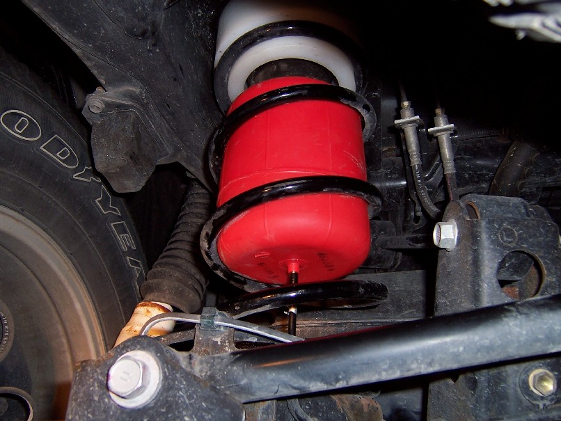

I wanted to know if I could run both a OME coil spring and spacer. Not sure how much lift the springs will give unloaded but, I would like about a 1/2 in to and inch lift over running just the spacer. As of now I just pump up the air bags to gain that little lift but the ride is a bit firm. If it's too tall with the spacer and new spring I figured I could cut the spacer down to get the desired height.
you should be able to do but it will depend on the rear spacer type you plan to add. I know the daystar one that cups the top of the coil will not work as the OME coils are a fatty.
I believe cornfed is an add on that just sits on the coil so that should work? I dunno quite honestly which spacer will fit.
but if you can fit it, it will work.
some things to consider: make sure you extend the rear brake lines or else you'll end up yanking them when you over-extend.
also get longer shocks to accomodate for the taller coil/spacer combo or you'll over-extend the shock and blow it out.
good luck!
GT - good info.
I am running the Revteck spacer in the back (see the white at of the coil in the photo).and it has a seat carved out of the plastic to hold the spring. Did not think of a the OME being a fatter a coil coil?
I also have on the shocks that came with the lift. I figures I would sort out flex after I got the ride height I am looking for.

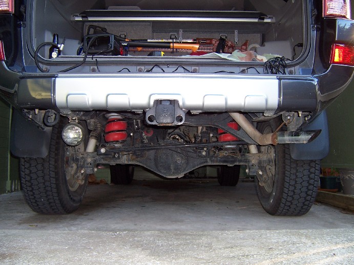

yeah the OME coil is much thicker than the stock counterpart so the revtek spacer may not work. You may have to shave the inside to accommodate for the fatter coil.
Either way it's possible as I had the downey coil + daystar spacer for a few months until I went with a different route.
just make sure to extend your rear brake lines (2) and make sure the shock is long enough w/ the added height.
Are you going to keep the Air Bags? I installed them in my OME 895, and they were a pain to put inside the coil.
