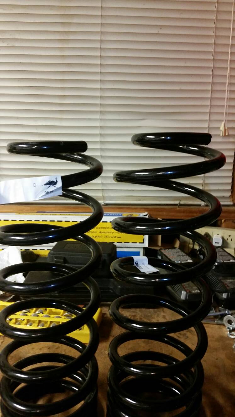

This shows the difference:
KGtFV2MjQ4iXBuIX14sPXuT6Dh-XOxxz3pyblB9Peci6eoNyuq0JOzk-Ny-xLwIojmqvsRgpBEXZueACQ-wmiNBIFmzrPcqYPtvPsbxqvs1HwZdxF73Kv94qreFWHlrlfpfuqhEyDojMLSu8t-F6zkEHGojAZxGtdfVLzSsmkazB6bsI3xHiKE2Wu-JRblnH1jHYXBmTDYgwDzrQe_ihpcWnVXXyvHpP4CZTT72yvaDBrRpMCjP6UqLW80vIsNksC1xSpeEMRaHgZCwxwH53cx8Jn5NLhtyym7LLFWJF54Icq9aas26KAG1Z48XqylH5mwbrOowR6oJ_aJjDEWeMHmooErECyvy04TIi7lT41vOqk4rvBXuaUb8TPSCYod21-0EukcmLPAKxwBbFBoDWQEr9ZiNOVR9irAa_UV_SsvDUASWPrfH25-2BWGkAM2yu7Dd4cIBkCuSpnkRzaxJFiS3Ye-SAjcS3W4KPToEwccNO5SIIpe-pomt40KBUMBJ2BqJu3lUSqlwLVY3ZDYyM3a0-C_nP1ZHqFEASz1PtI8rC93jYIkexvEGedhVZ08kgfcAOapeLMAK3G2lAcE58dTCWD34vnF2RDCyqajDK4ytTHjrfmXnsFM1nGqmiPurWUXcWWDpAd5co6fb7mmdRr39qyZ6ofXK_6k6hBGieJg=w640-h480-no
Or you could not even look at the letters and stand them side by side on a level surface. I just did that 2 weeks ago with my 861's. One was taller by about 3/8" so that one went on the drivers side.
