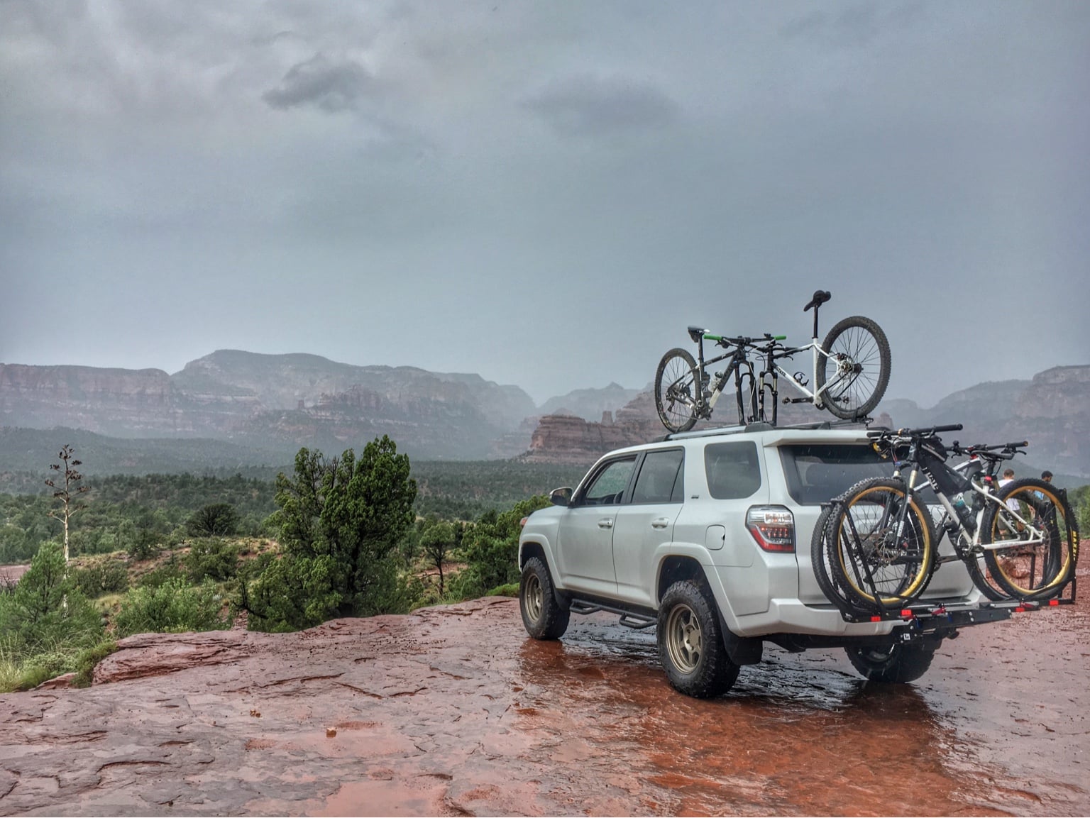

For what it's worth, I did nearly exactly what you wanted and I'm very happy with the results.
5100 all around (front to 1.75)
2895e rear coils. Even with a medium load there is virtually no sag with the rear coils as you can see in this pic. I have the 3rd row, lots of gear in the back, a heavy hitch rack and 4 bikes total & the rear sits nice and high still
Instagram @tcr_89 2016 SR5P 4wd 3rd row - FN wheels countersteer X - 265 KO2 - OME 2895E rear coils + Bilstein 5100 (1.75 setting) - NFab side steps - TRS Morimoto 4300k HID - NOKYA yellow fogs & DRLs - AVS hood visor

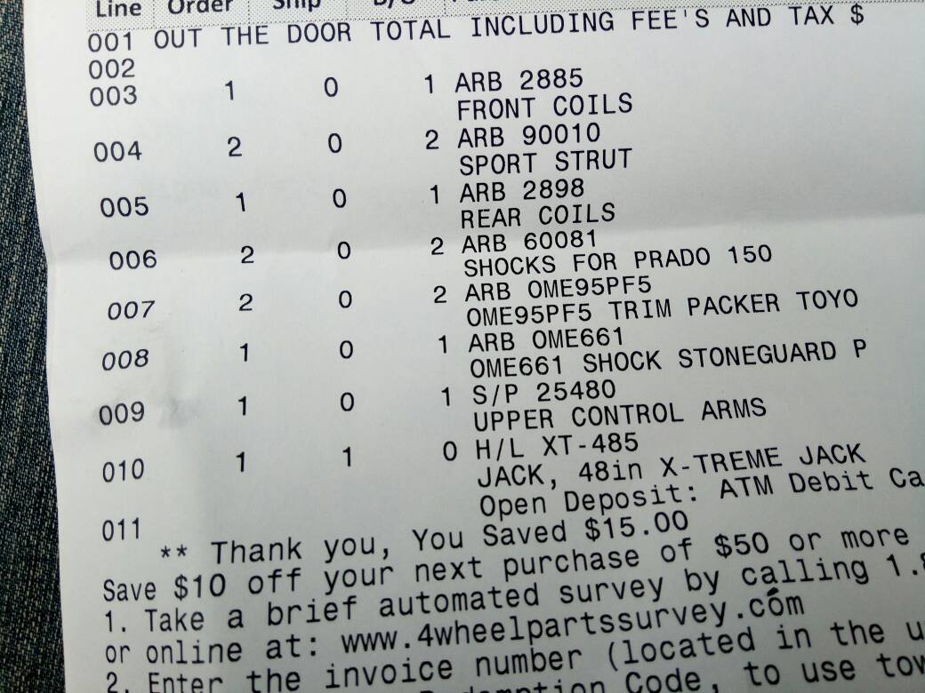

Just want to make sure with you guy that I don't miss anything here.
This is my shopping list:
278,310
3,554,080
