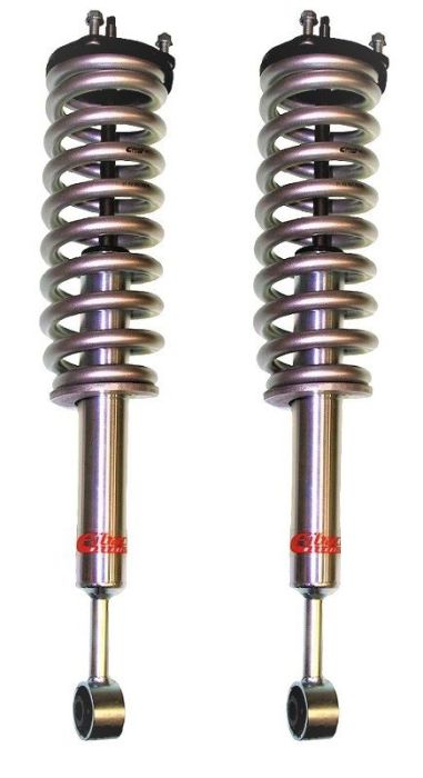

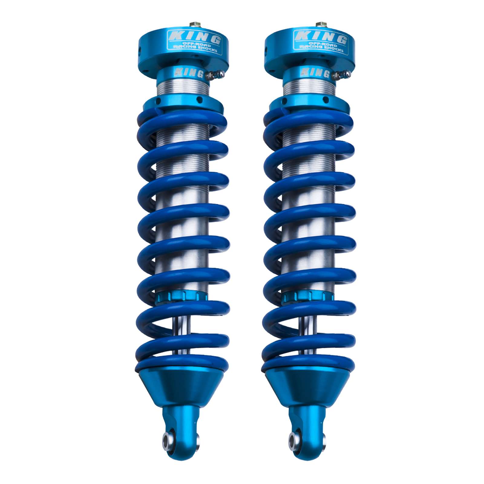

There are threads with a collar that is turned further down on the shock body to achieve your lift height on the higher end shocks/coilovers. There are budget offerings by other brands that have a clip for the coil spring seat with different notches that give you the desired height.
Threaded collar Kings and Eibach clip style respectively. Ben at Filthy Motorsports is very helpful on the phone and has some tutorial videos on YT.
