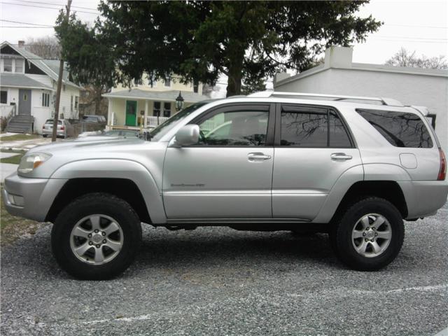

I got the lift put on. I don't have before and after shots. No perfect measurements either. But, my first impressions after going from xreas with 140,000 miles to the new setup are: fj shocks are ok and dont make any noise (they will work until the Bilsteins show up). The rear 895 springs are stiff. I am not loaded up with anything at this point. The 884 in front seem nice. I also got my front setup with I think toytec top mount spacers on them. The front will be better when I get the 5100s in there though.
I gained about three inches all the way around. No measurement though. Makes the 32 inch silent armors look little now. I have to step up to get in. Maybe shouldn't have taken off those steprails?? Lol. And don't forget those parking garages now!!
I have yet to offroad with it.
Looks perfect, exactly what i'm looking to gain. Hopefully if all turns out okay, i'll be installing everything this weekend...we'll see though.
Thanks for the post though, did you run into any setbacks?
Again, it looks perfect...the tires really don't look bad at all.
Yeah, my setbacks were that the back shocks were so rusty I unfortunately could not get them off. :nono: So, doing the work myself did not happen. I believe the mechanic either split the nut off or I believe he cut the shock tube with a cutoff saw or something. Other than that, just the cash was a setback.
The 255/75/17 look good still. I only went with that size due to wanting to keep the spare under the 4runner. Otherwise, I would have gone with 33's I think. 32.4 may be the limit on the spare tire size.
The spacer I am sure helped level the front. Looks pretty level. If I do need adjustment I suppose the front 5100's will give me that anyways.

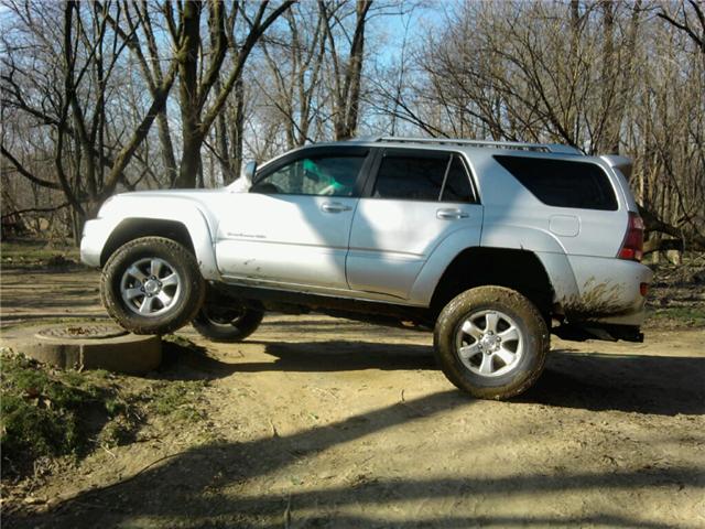

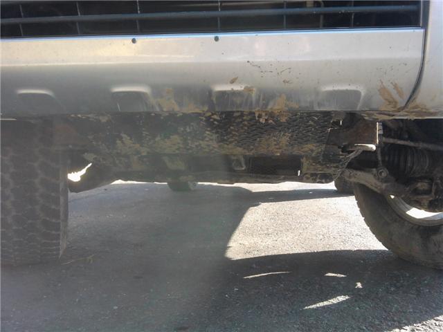

I did get it dirty. Suspension works too!! :lmao: I went through a mud, ice, creek, swamp thing and of course; deeper than expected. With the old suspension I would have been a dead duck. I had enough clearance to bounce across with the ome setup. (of course I never would have tried to cross it either, before) :D The skid plate I made seemed to come in handy too!:naughty:
Have fun when you get your lift on!!
