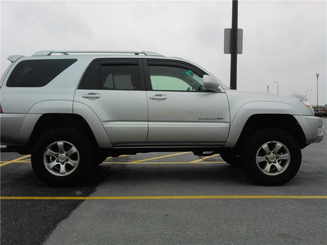

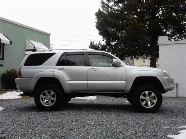

So, my problems are now fixed. It was not bad planning.
To answer your question I got the 884 and the spacer preassembled on an fj strut. That is how I got them both and it is a good match for ride height.
Like I said though, problem solved! This would only happen with a 5100 I am guessing... The mechanic put the coil mount plate in upside down or right side up!!!!:headslap: I mean on most struts it is already attached.
This gave it like 3 more inches of clearance. It was bad. I mean way up there. Anyways, The Bilstein 5100 is now assembled correctly. The keeper ring is on the bottom of the shock for no lift. The topmount spacer is left in.
Now, it may be a tad higher in the front than the back. The shocks did lift it about an inch. But, it will level out when I put on the rear 5100s if they ever show up!!!

First pic here when shocks were put on wrong... not good!
Second pic is properly installed 895/fj shocks, 884/topmount spacer/5100.
Looks real good, eventually i'll go that exact route, because I know what you're talking about regarding the nose dive etc. I can only imagine how much nicer it rides now.
