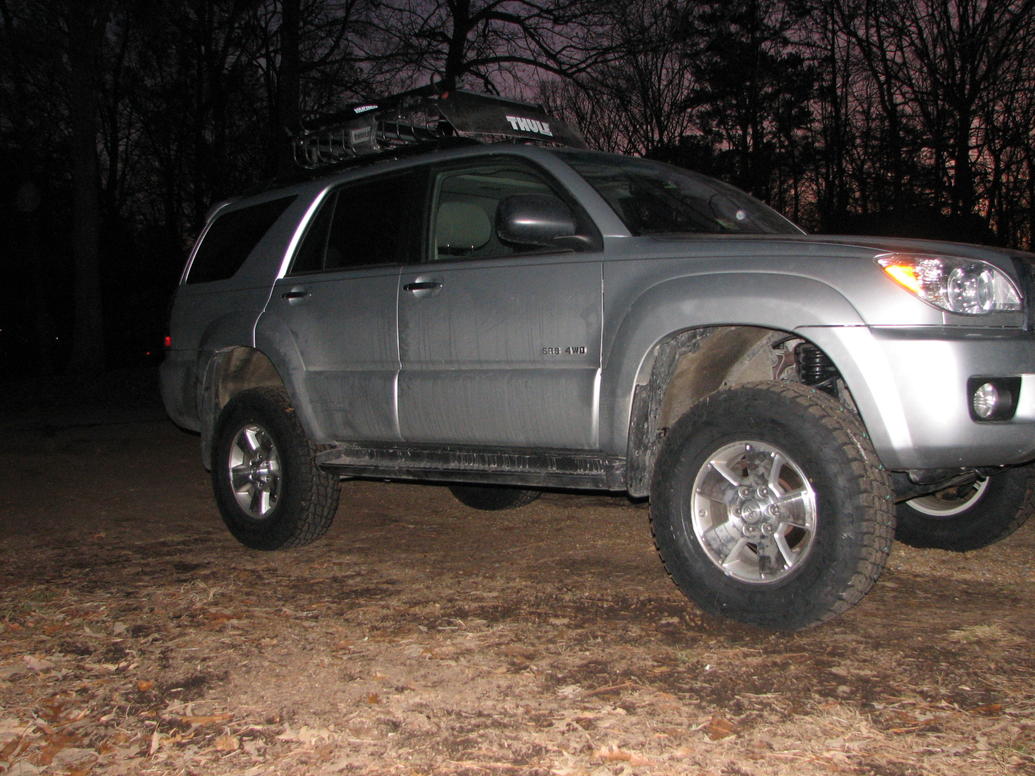

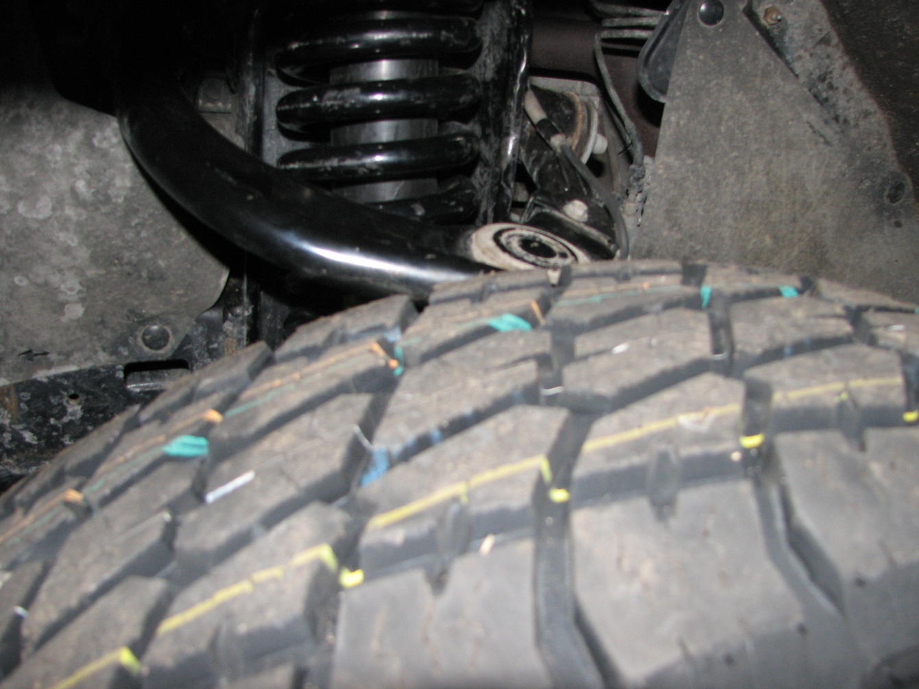

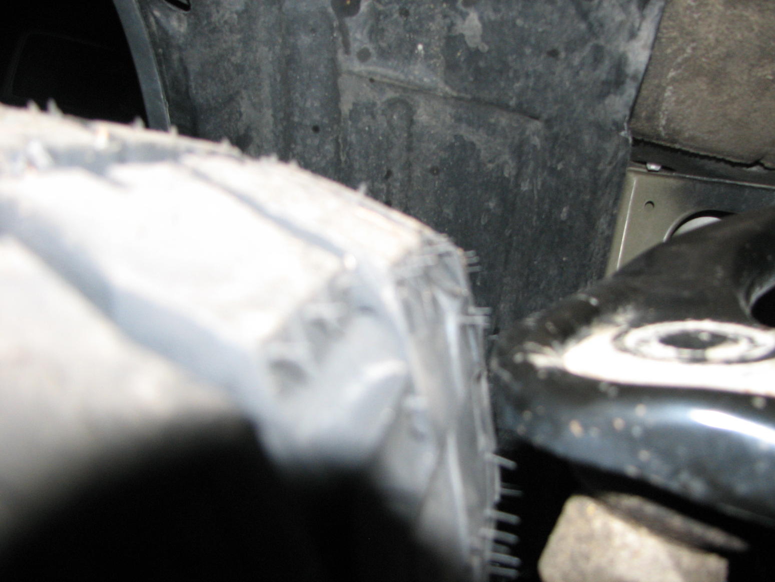

I installed the OME suspension kit (front and rear shocks and springs) giving me about 2.5-to 3" lift and I'm running Nitto Terra Grappler 285/70R17's. I just ordered front and rear 1.25" hub centric wheel spacers because the upper control arms contact my tires's sidewall when I crank the wheel.
Does anyone know if I can add another 1-2" with some sort of spacers? Or will i have to replace the upper control arms since I have IFS?
i wouldn't go any higher with a spacer setup in the front. you will loose any droop left in the suspension. if you want more lift, you're next step is to install a body lift, or go for coilovers and new upper control arms.

These are some pictures without the 1.25" wheel spacers. The last two are in the front wheel well.
