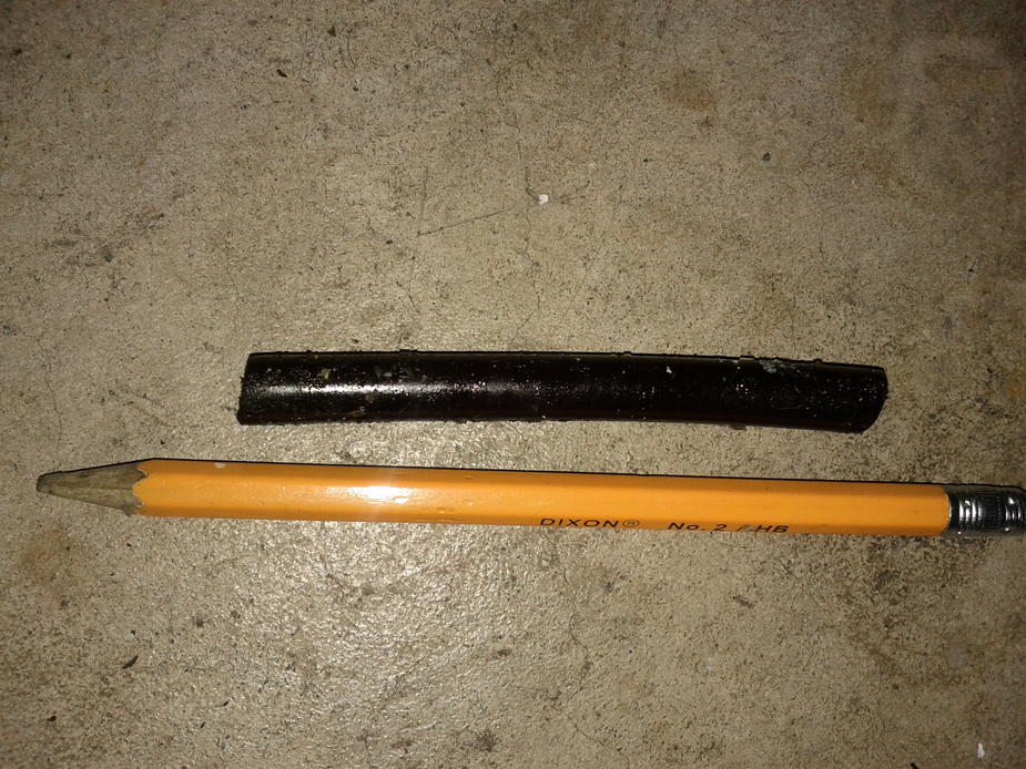

OK sorry for taking so long to update. It out and I did it without having to rip into it. I went out to start on the axles and looked at that camera gizmo I bought, figured why not waste more time. Put it in the fill hole, messed around a half hr or so. Put it in drain hole with the mirror attachment it came with and thought i saw it still the same thing I was looking at before but couldnt tell, or reach it for that matter. It didnt move spinning the tires either so I took a long screwdriver and ground it down so it was skinny, then bent it into kinda a ( J ) picked and pulled at it, spun the wheels some more and by god it moved. So another half hour with some bent needle nose and spinning the tires I fished the B-ich out.
I just wanna say thanx to all you guys that put your 2 cents in. More than anything it helped me from going nuts on what a stupid, boneheaded, move I did. Lol, all because I didnt wanna spent the $10 on a gear oil pump. Anyway thank-you. Here is a pic of the hose. One last thing tho, it actually went thru the gears and it didnt even put a scratch on it. It was an old oil line not gas. Sucker was stiff as hell. Glad its out
