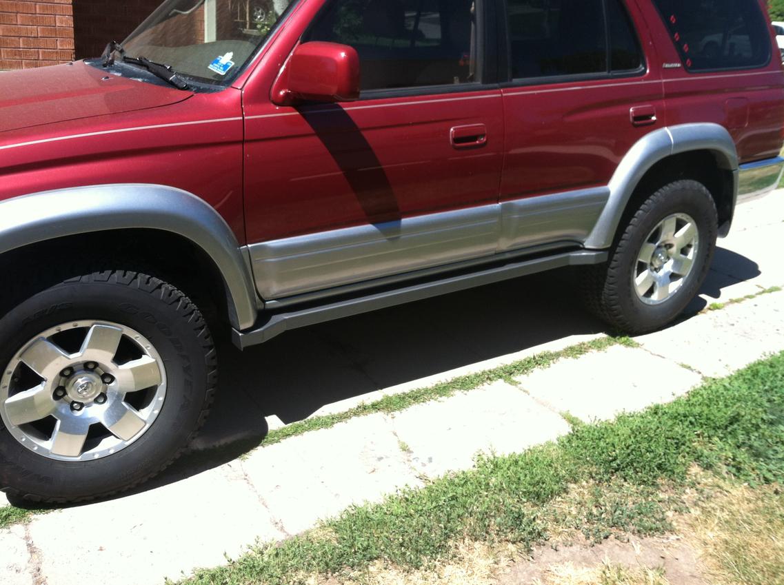

On my 3rd gen I built a different style of low profile slider where I used 2x3 square tube. I intended to use both sliders as air tanks, but never got around to doing it. They could pretty easily be fabbed for the 5th gen with even larger size like 2x4 tubing. It would have decent volume and not take up any additional space. An 8 foot length of 2x3 square tube has the equivalent of about 2 gallons of interior volume. So with 2 sliders you'd have around a 4 gallon tank.
Slick :) Reminds me of old school tube bumpers, you could get voluminous amounts of air in them.
Apart from a custom setup there is really limited space available in a 5th gen, it is kind of shocking for a truck this size. I didn't do much crawling around under my 3rd gen, but man my old 89' pickup could house a small weapons factory underneath.
