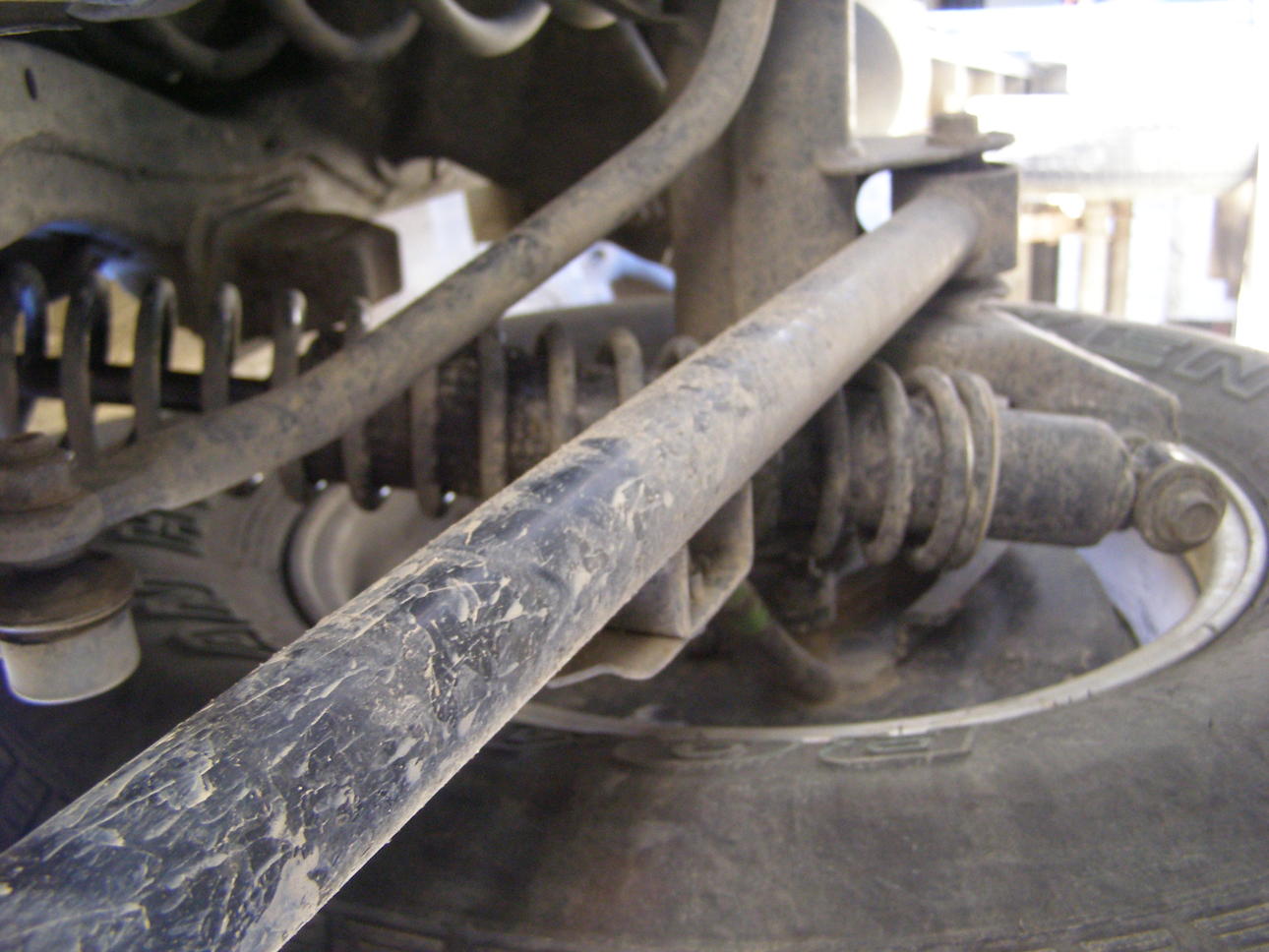

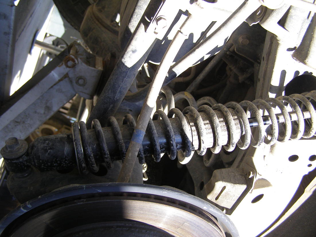

" modified coilover shock in the rear ?? Pics please"
You have to find the right lenght shock to make this work, they had to pull the rubber gromite out of the revtek shoch and insert it into the new one. The Monroe shock lower mounting hole is smaller in size and he had to press it in with special adhesive. This is a black smith spring shop.
The one I used was a fraction taller, that's where the 1/4 inch increase in height came from.
We had to use the factory top plate.
The ride is a little stiffer like having medium duty coil spring and still has the absorbtion like you want. Back end doesn't drop much when under a load. I was a little worried about him doing this, but, a great ride and a life time gauranty on the shocks.
um... so whats the purpose of 4 coil springs in the rear? did you remove the two main coils? otherwise the extra coil springs arn't doing anything other than preventing full tuck.. curious...
Still have the factory coil springs in the rear with the spacer lift. Just replaced the shocks with the modified coil shocks. Makes it like having a medium duty coils and shocks.
