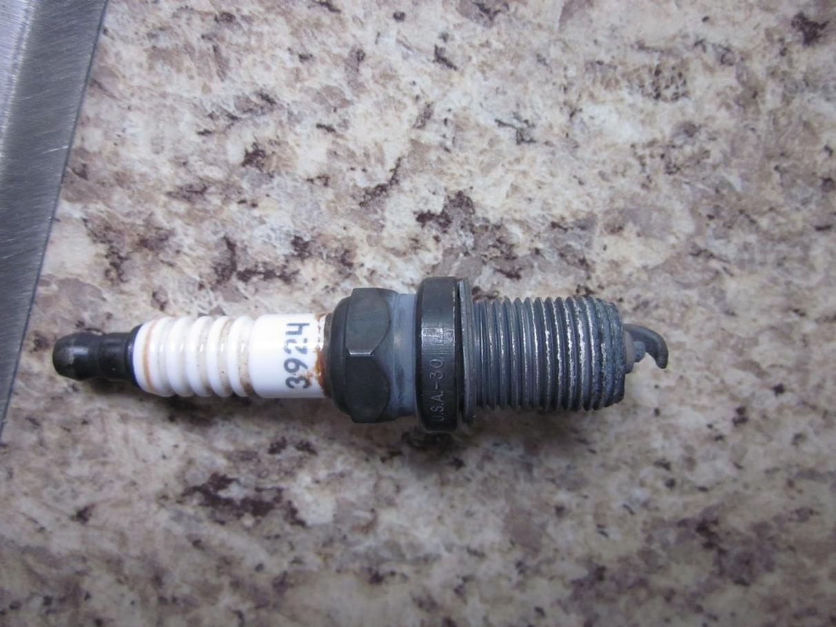

What did the pulled threads look like on the plug that got spit out? I'm wondering if it was helicoiled previously. If not it most likely was overtorqued. You should change the rest out as well and get rid of those autolite plugs. Whoever changed them before obviously didn't care about what they were doing.

Any suggestions on spark plugs? I was gonna throw NGK BKR5E-11 to replace the autolite 3924, but should I go for a higher end spark plug? I know these motors use a weird polarity system for the plugs (I think one side of the motor sends current the normal way and the other three cylinders on the other side run backwards, does that sound right?) so does that warrant the need for iridium or other fancy type plugs? I hope to never do this again so I dont mind spending a little extra.
here is the spark plug it shot out. Looks like the steel plugs threads just ate through the aluminum slowly over time..
