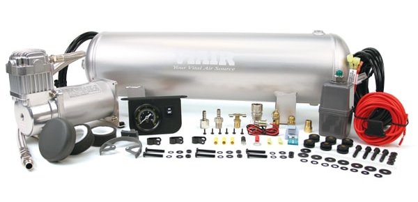

We'll be mounting this onboard air system on our '17 4R and are seeking ideas on where. We'd prefer it to be in the rear in order to keep room under the hood for a second battery and we don't really want to take up space in the cabin. Since we'll be hauling our spare tire on a swing-out bumper, would the space underneath where the spare was a good spot? Opinions and pics would be very welcomed.

I think you'll want the compressor as high as you can get utt to keep it dry and out of dirt as much as possible. The tank can go wherever it fits. I don't use a tank. My preference is to save weight and use something you already have as a tank. Sliders and bumpers for example can make nice air tanks.
