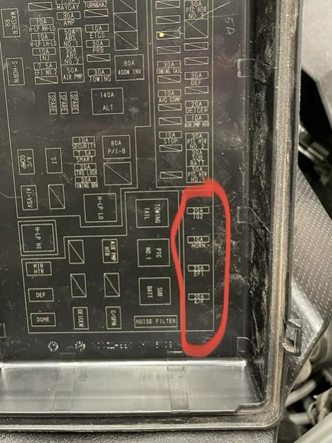

The horn fuse and relay (as well as three other fuse/relays) are located in the "integrated relay" module also known as Unit K and stamped “K”in the engine fuse box.
If you press the horn button and it blows, it’s all working OK.

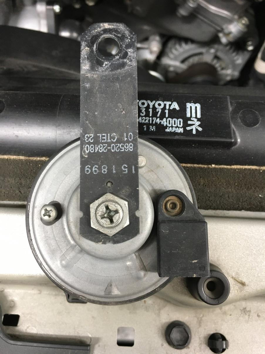

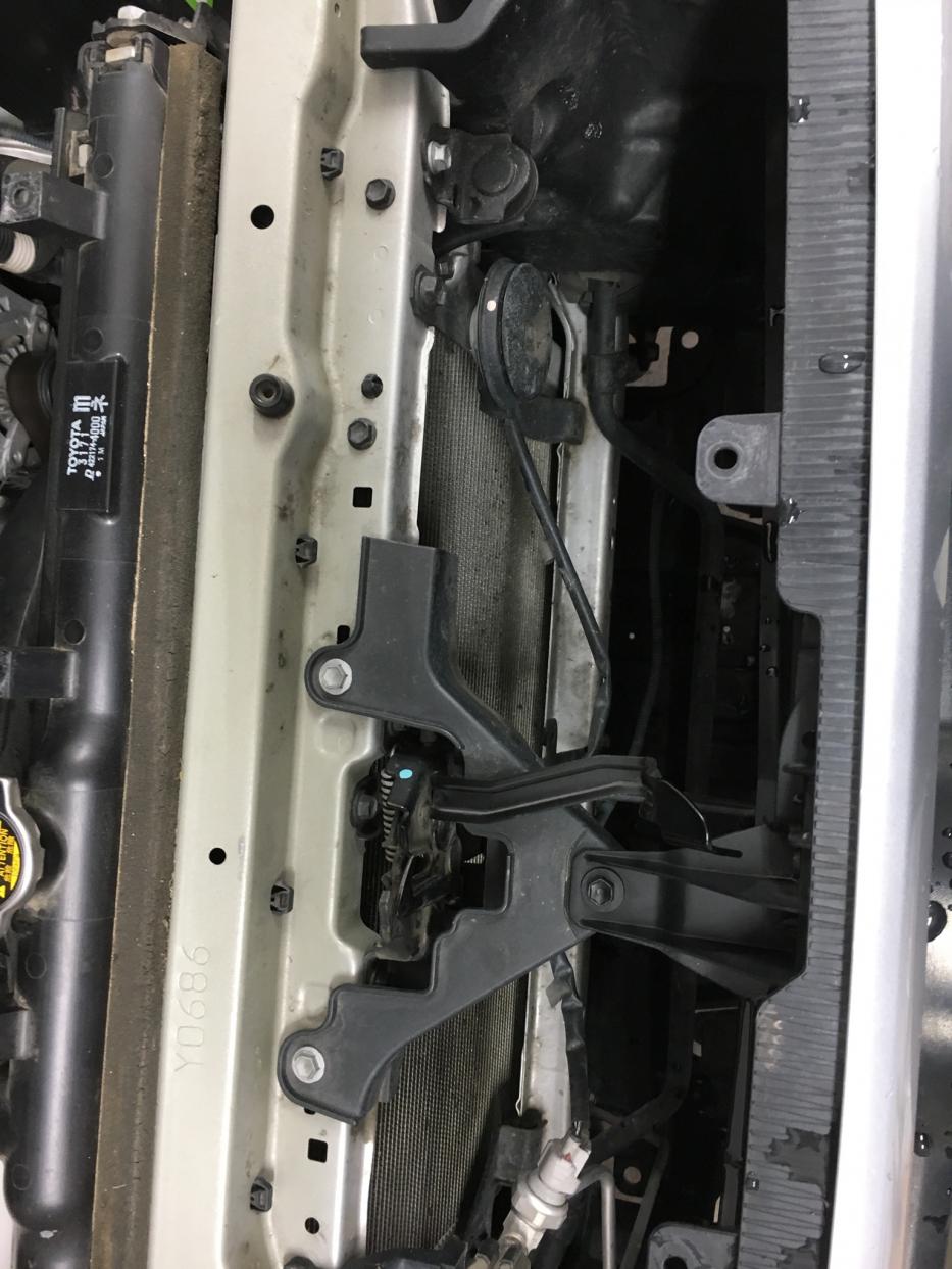

Those pics above are the horns from my 2018 ORP. Each has its own connector. If you look at the wiring diagram PDF I posted above you’ll see that on at least one trim of the 2010 MY there were two horns installed, driven from one relay. So the horn relay contacts should be able to handle a two-horn retrofit.

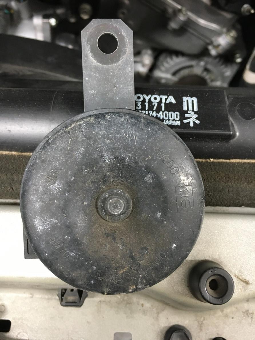

Here’s my factory single horn setup.

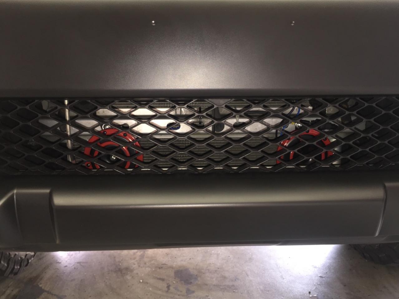

Hella Toy. horns
Replaced mine with some Hella plug & play ones more of a Roadrunner beepbeep sound , l like it better than horn before ! Have a cpl xtra horns now as I took both off of 4r & Venza !:thumb:

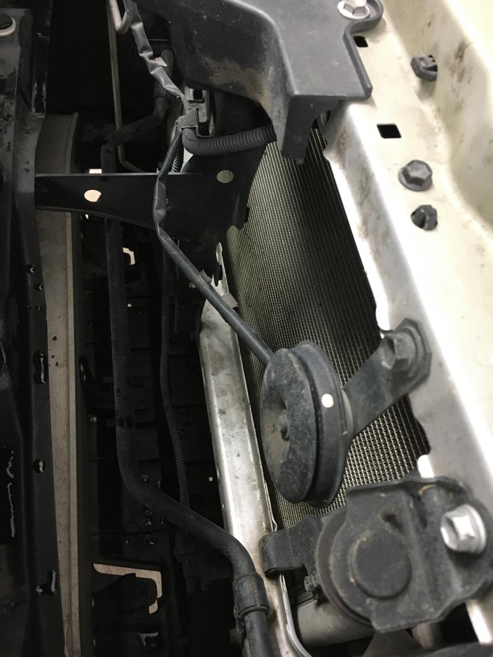

At some point they went to two horns in front. Soon after the 5th Gen intro. If you look back there were a few threads about replacing the horn(s) since they were so pathetic.
True! That's one of the first things I had to change on my '10 TE... worst horn ever. Put the dual Hellas in there with the relay wired to the battery for full voltage. HUGE improvement. Even though my '20 ORP has dual normal horns, I may still swap them out to the raspy loud Hellas.
