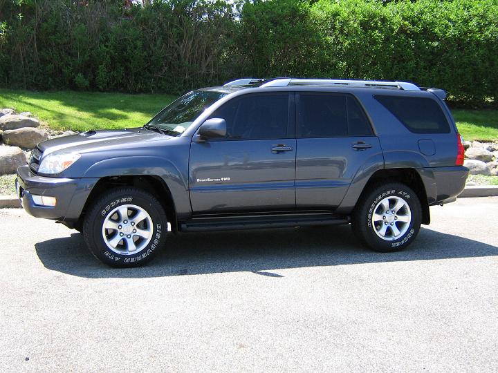

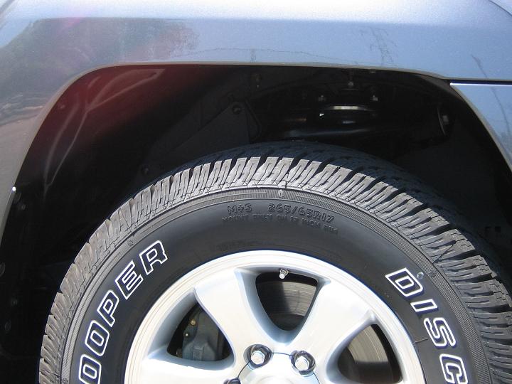

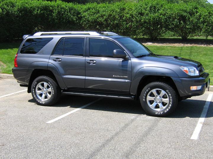

Check out my 4Runner after I installed a 1-inch spacer lift on the front end. The spacer itself is only 1/2 inch, but it gave me exactly 1 inch of lift as measured at the wheel well openings. I also measured under the front end at the tow loops and ended up with just over an inch more ground clearance. About 1 1/8 inch to be exact.

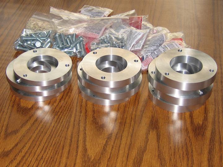

I wasnt sure if Iwould be happy with just 1 inch of lift because my 4Runner seemed to suffer from more than the usual dropped down nose that plagues all 4th generation 4Runners. So my buddy (a machinist) fabricated spacers from 5052 aluminum in 1/2 inch, 5/8 inch, and 3/4 inch thicknesses. After careful measuring, I found that the amount of lift is double that of the spacers installed. Therefore, the 1/2 inch spacer nets 1 inch of lift, the 5/8 inch spacer nets 1.25 inches of lift and the 3/4 spacers nets 1.5 inches of lift.
As you can see from my pictures, the 1/2 inch spacers still leave my 4Runner a bit lower in the front than the rear, but I think it looks fine like that. The 5/8 inch spacers would lift the front another 1/4 inch and make the front end closer to the rear, and the 3/4 inch spacers would make it just about perfectly even. I might decide to try the 5/8 inch spacers in the future, just for the heck of it, but I will probably just leave it the way it is now.
All in all, I am extremely happy with the new look of my 4Runner. It seems to sit more aggressively and just feels bigger on the road. When I pull up next to my neighbors new Ford Exploder, I sit a bit taller than him now! Before the spacers, we were just about dead even. The ride and handling seem 100 percent identical to stock. I dont feel any difference at all on the road. This is by far the best modification I have done to my 4Runner!! By the way, this kit can be easily installed by one person using standard hand tools. I did have to get spring compressors and a tie rod puller, but my local Autozone lends these tools out for free, so it didnt cost me anything. I managed to install the spacers by myself in the garage in just a few hours.

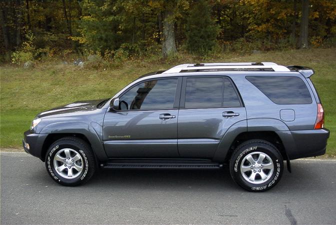

Before the lift (sorry, but I had to use an old picture because I forgot to take a \"before\" pic)
Extra sets of spacers:
