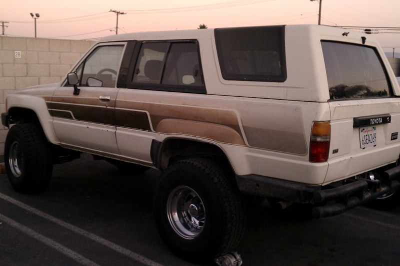

IT LIVES!!! *evil laughter*
So many hours and even more dollars later here we are. Rebuilt 22R-E (did you guys know that milling the head way past the stop mark and using 2 head gaskets doesn't work?:wow:), new clutch, new carpet, new dash, new stereo, muffler, catalytic converter and the correct distributor.
The sick thing is I thought about selling it when I ran across a 58 Chevy Stepside for sale.
Pic is from before I fixed the parking brake. That is the spare alternator filling in for a wheel chock.
Been thinking about stepping the tire size down a bit. Thoughts?

You mean you can't use two head gaskets? I thought two was better than one?!!? :P hahaha
Looks good bro. 33s seem kinda big to me, I think 31s would look decent and maybe help with the mpg too.
Hows she running?

we are all professionals on here, and any professional knows you can not use 2 head gaskets on an over shaved block........ you have to use 3.
Glad to see another one saved from the scrap pile due to neglect.
I agree, RockinRunner, 33s seems a bit large to me too. I'm thinking of 32s or 31s on some nice Cragar 15x8s. But she runs like a champ. Rough MPG estimate is around 24, mostly highway driving.
Hey TOY2G, you mean I could have saved myself the expense of a new head and just thrown a 3rd head gasket on there? Gotta remember that for my next motor.

Nice 1st Gen!

Good looking rig! Welcome to the forum. As for the tire size, I would recommend the 31's as max without regearing. Your mileage is being helped because the 33's are like having really tall gears--only problem is they hurt your acceleration and overall power. Love the "electronic wheel chock"--very resourceful! Have fun with your rebuilt rig--4Runners are great little trucks.:frog:
Thanks for the welcome and input BucknutBob.
I have a hunch it has been geared, probably not for 33s though. But since I don't have a stock one to compare it to, guess I need to open the rear end and start counting teeth. Or could I get away with counting driveshaft-to-tire rotations?

You got it--wheel rotation-to-driveshaft will work fine. After all, they're just extensions of the ring and pinion. You'd want about 4.88's for 33's, to keep the engine in it's normal operating range. Sorry--don't know anyone needing Yota rims right now.
