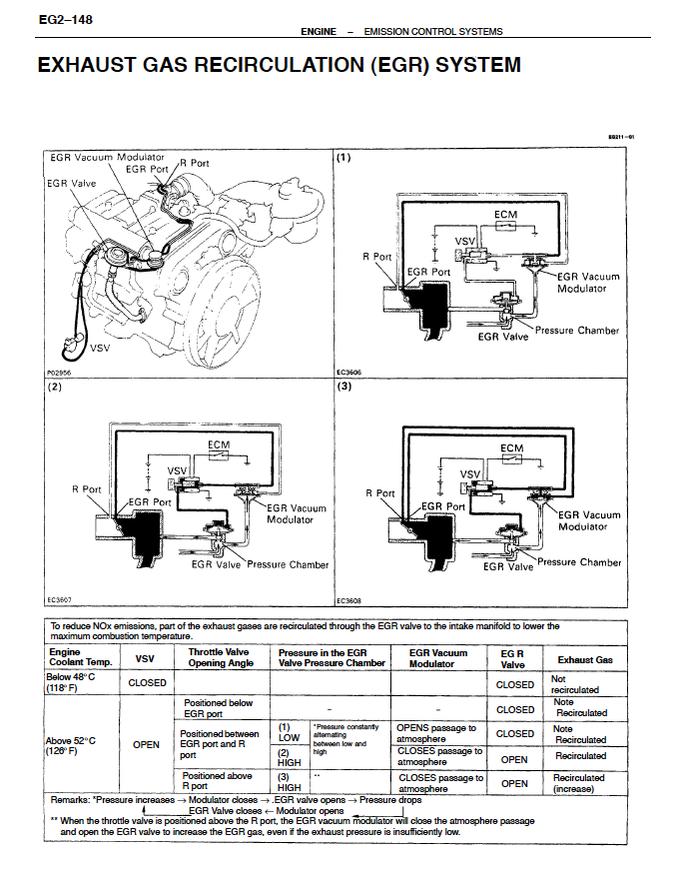

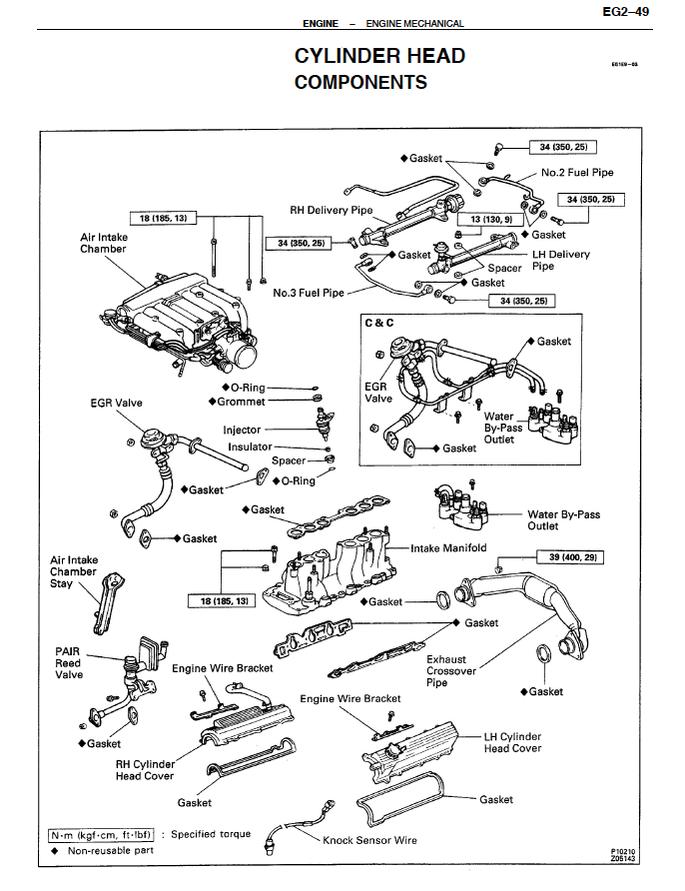

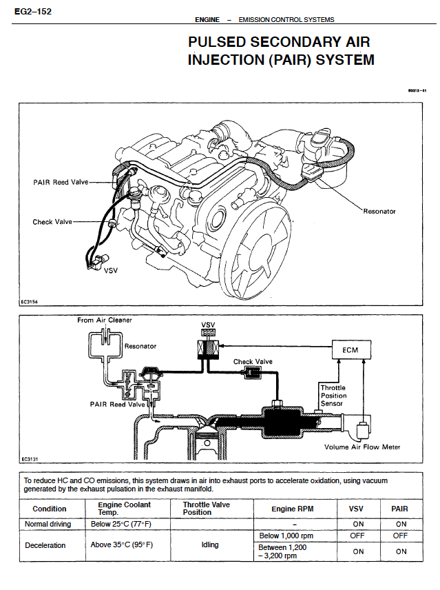

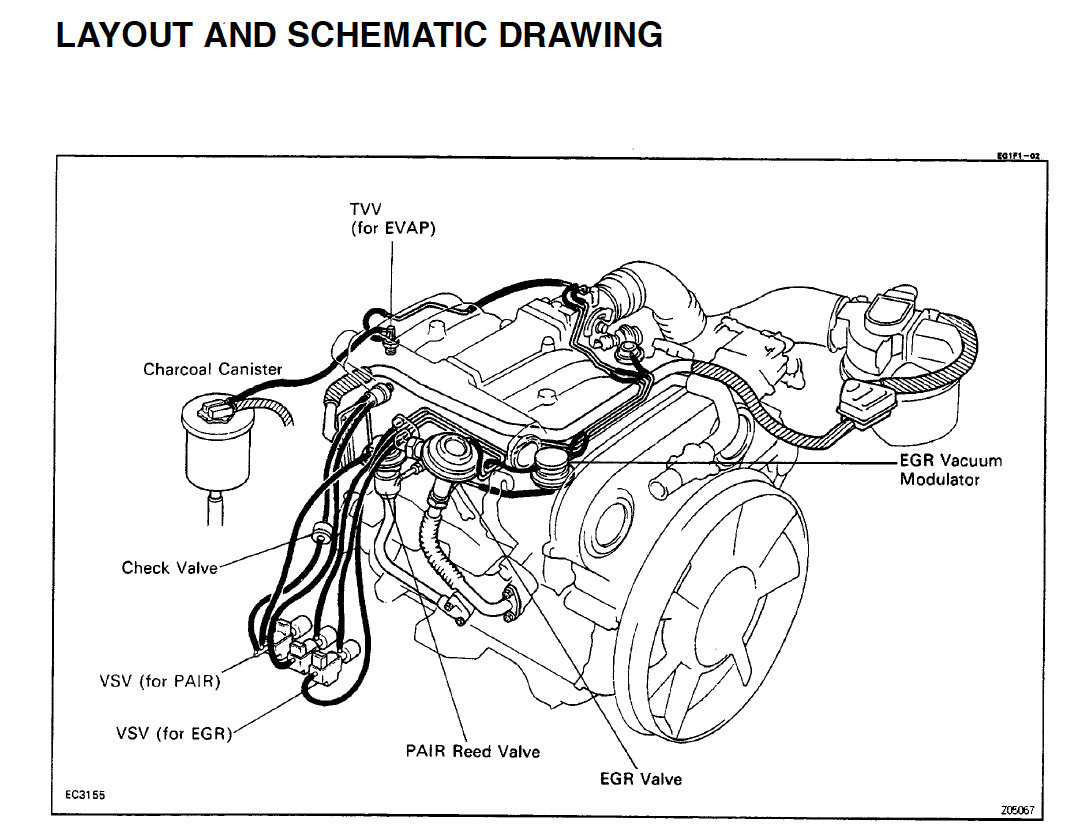

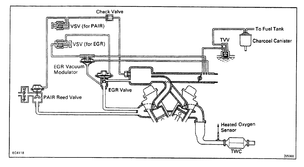

Does anybody know where i can find a diagram of where those plugged hoses go?
