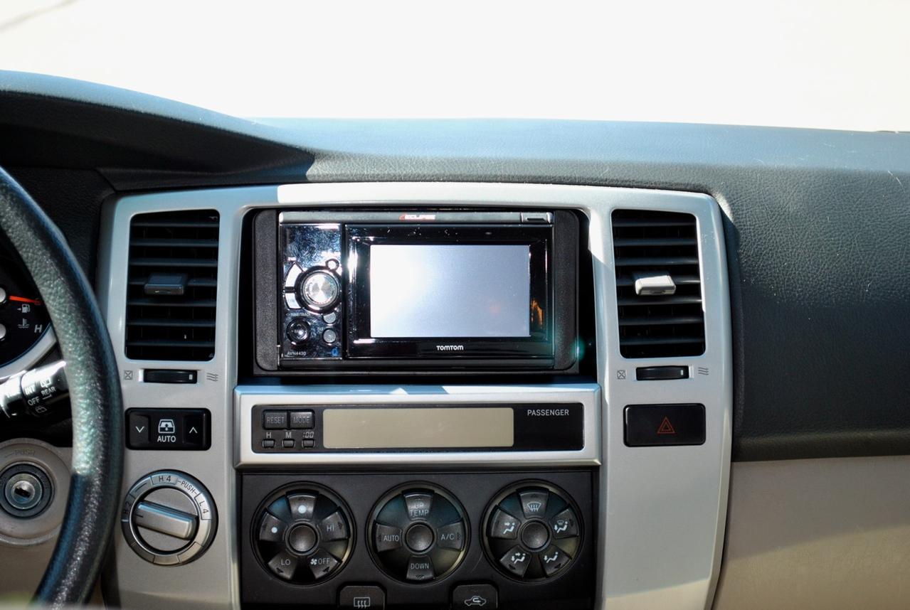

The Eclipse deck.

That looks very nice. I bet the Urban Runner trim ring would fit on that particular model and make it look almost 100% stock. Maybe I'll go with that combo.
