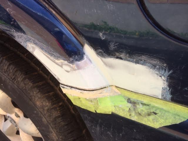

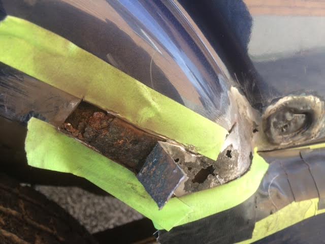

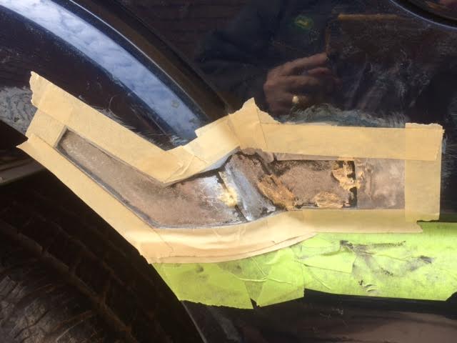

    Photo is a 2005 Jimmy rear quarter bottom, with an innocent little rust spot.
    - after paint bubbles removed...holes started to break through, metal got thin like tin foil (rusted out from back side, initially)
    - just eats up time, to fix properly & takes auto body & weld equipment...and its only one small rust spot / being rebuilt with 19 gauge metal
    - essential the patch panel repair, is now 100% water tight / and Mar-Glass Fibre-Fill Bondo is not a water proof solution, rather a waste of time
    - GMC 4x4 being cleaned up, for a flip / sold last week BTW
