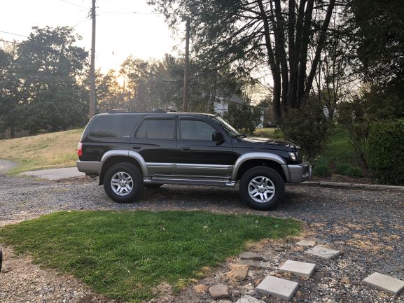

I went from FJ cruiser coils, to Dobinsons 137 recently. I detailed it in another thread dedicated to rear coils.
The Dobinsons have been awesome so far. Gave me the rake/height I wanted, super comfortable on the road, and flex enough for my needs.
I cant see any reason someone would be dissatisfied with them. For me, I wanted a 2" lift to stay within the 5100 specs, and because I only went 2" in the front to maintain as close to factory geometry as possible.
I'm not as well versed in this stuff as alot of these guys in the forum, but I took the rig on a recent trip through dirt roads, river crossings, and deep loose rock. It performed well and is comfortable even when weighted down. I'd guess I had 500 lbs of passengers and gear, and the rear didn't sag.
If anyone is curious, the Fox 2.0 coilovers, paired with Icon VS 2.0/ OME 906 w/10mm trim packer, is a great set up. Rides great on road, very little brake dive, firm, but plush, eats up bumps. Running on 265/70/17 wildpeaks on tundra split spokes
I researched for years looking for that mythical perfect 2-2.5" mild lift, this may be it.
