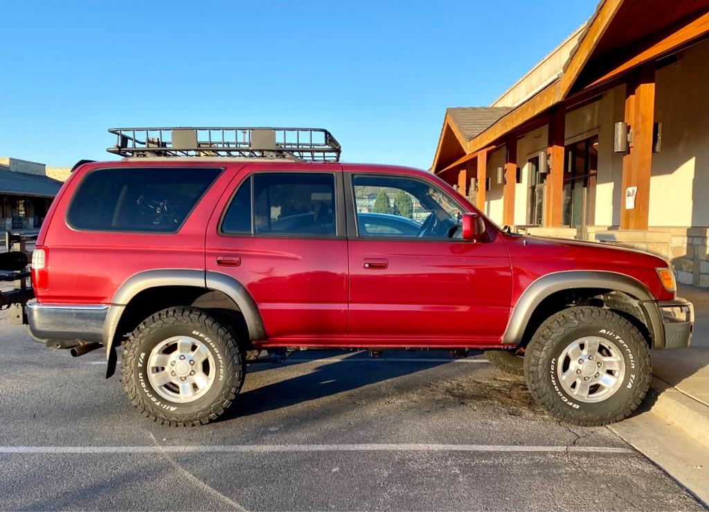

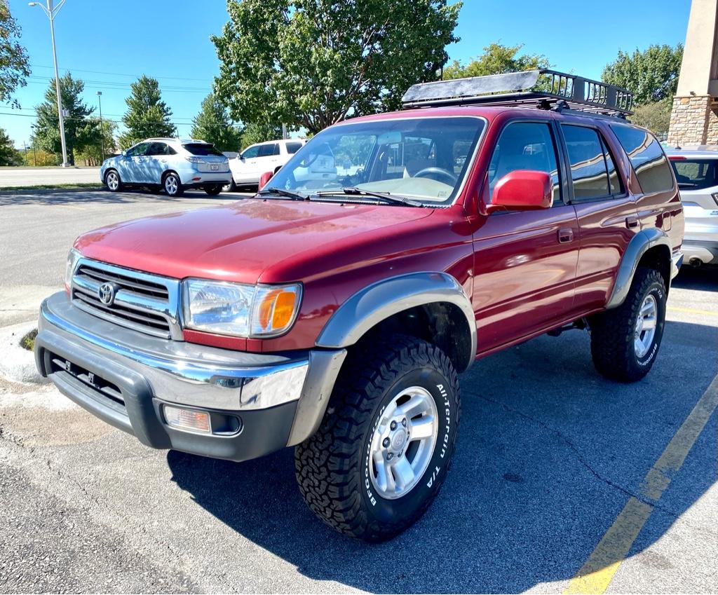

Photos for reference:
I have no idea, but your rig sure looks nice without the cladding stuff! Is there any evidence that you may have rust underneath? If not, I'd let that sleeping dog lay, personally. You do seem to have more overall gumption than my lazy ass, though.
The only pieces that are the same are the following.
1. Rear Bumper Mudguards
2. Quarter Panel Flares
3. Frt Bumper Extension.
The rest of the pieces are different.
I looked into removing my limited flares/cladding at one point before deciding it would look like Swiss cheese without them. Anyways, I believe the connection methods are the same for the pieces that overlap with the limited flare locations. You should be able to the front fender retainers by removing the inner wheel liner. I believe the fender flare on the rear door has retainers on the inside of the door (where the window track/motor is) and there is also a rivet holding it to the door lip. I vaguely remember someone with flares like yours mentioning that the retainers from limited flares work, but I can’t find where I read that.
