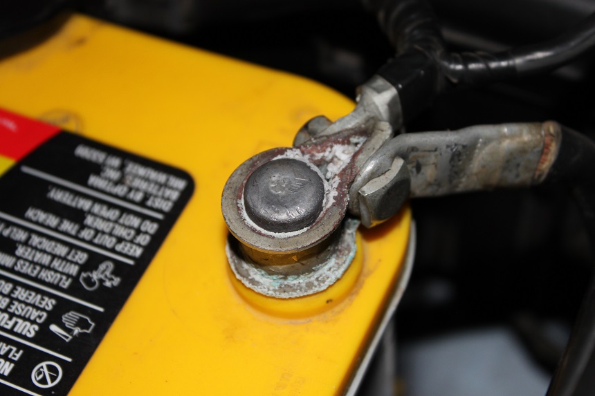

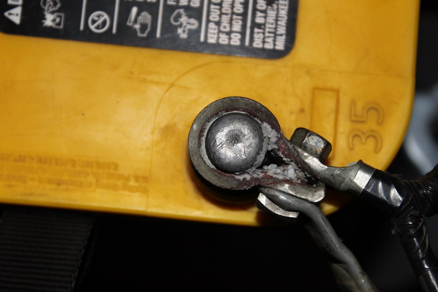

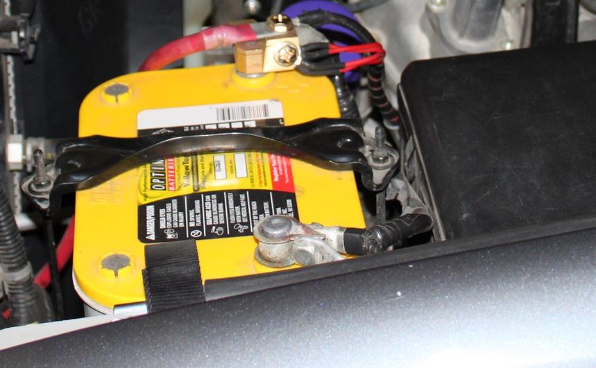

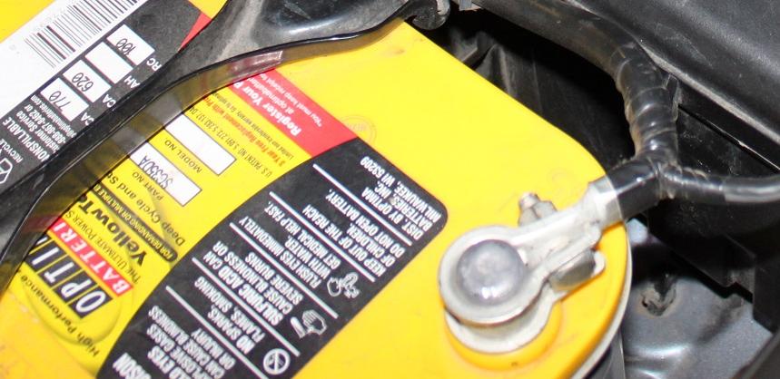

So...I bought a nice, EXPENSIVE, AGM battery because I was under the impression that they don't leak battery acid.
Guess not.
Not sure if this 10*F to 20*F in the mornings tipped it over or the one use of the winch, maybe age?
Replacement for this, almost 7 years later is $270, It seems like I paid around $200. Don't quote me on that.
sigh...
Dude that's nothing... First off it's not really a leak... it's just some minor corrosion at the terminals, certainly not worth complaining about.
You probably developed some hairline cracks around the terminal over time, due to hard use, or rough handling. Causing a little hydrogen out-gassing which leads to that corrosion.
Preventative Maintenance: You could, and should take the time to clean and grease your terminals with a dielectric as preventive maintenance and to maintain a lower resistance connection. I do it once every couple years.
7 years is pretty much about the end of the service life for an automotive battery. Its had a good run. It probably suffered an internal short. What is the voltage at the terminals?
Its also a common failure for an old cell and not uncommon to just die or give out one day.
I recommend NOT buying another Optima, they don't like em like they used to anymore.
Install these on your next battery to help with corrosion.
If it looked like this after 7 years, then I would be a bit more upset.

Haha, I guess I did sound like I was complaining didn't I.
Didn't mean it that way.
I have delt with battery acid killing a super fun little car I have, so I didn't want to deal with ANY battery acid in the T4R.
It is up into the ground cable...I can fix it.
Just had the battery out last July...so its just since then.
I have used the felt o-rings on standard batteries.
That last pic makes me cringe. (Of the foaming over battery acid)
Its reading 11.99v so I guess its on the way out.

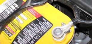

I thought this just happened like a poof but looking back at pics I can see it had started before November and after I had it out in July.
Found a pic from June and early November.
It would be 7 years old next April, so I guess its been a good battery, I just didn't think they leak.

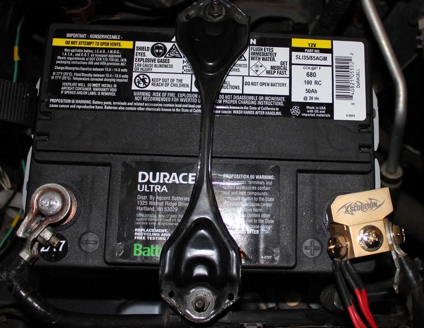

Did the BatteriesPlus, Duracell SLI35/85AGM $185.40 after the 10% online buy, store honored it, and a $10 mail-in rebate for $178.40. Seems that was more than enough money... my brain only handed the cashier $120...LOL.
Thought he said it had a 4 year warranty. Made in USA.
Is turning over faster and it only weighs a couple pounds more.
I guess I was wrong before thinking I was charging at 14.7v, its running voltage is now 13.7v +or- 1.
Sitting at 12.64v
Weight is 41.5lbs

Cleaned all up pretty good with some baking soda and water, still want to cut out the ground wire and replace it and the connection.
Thanks gang!
...And nice wiring riceandpho!
