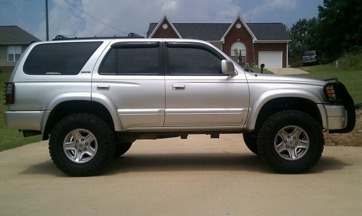

I have the 881s w/ the top plate spacer and 890s in the back. It sits almost perfectly level.....less than 1/4" difference between the fronts and rear (i think depending on how much gas i have). Here's a pic:

Well, it looks like a lot of people are running the 881's with the 3/4" spacer vs the 1/2" one. I actually couldnt find any info on the 1/2" spacer other than leveling the vehicle from side to side. I guess it will be the same except a 1/4" lower which shouldnt be that noticable.
