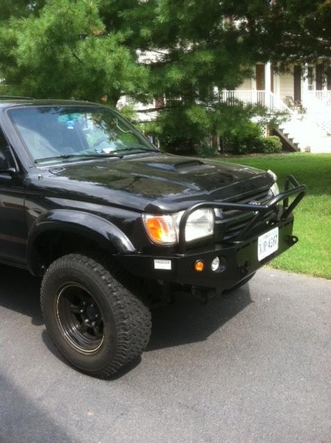

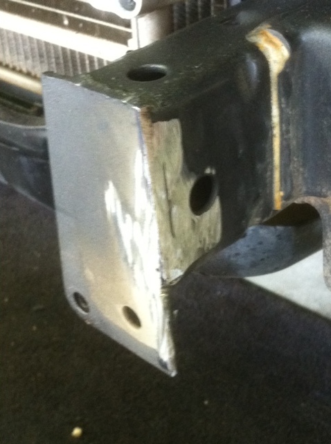

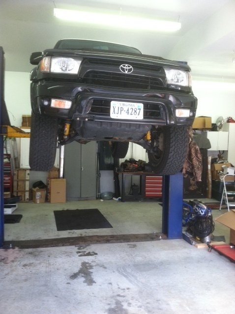

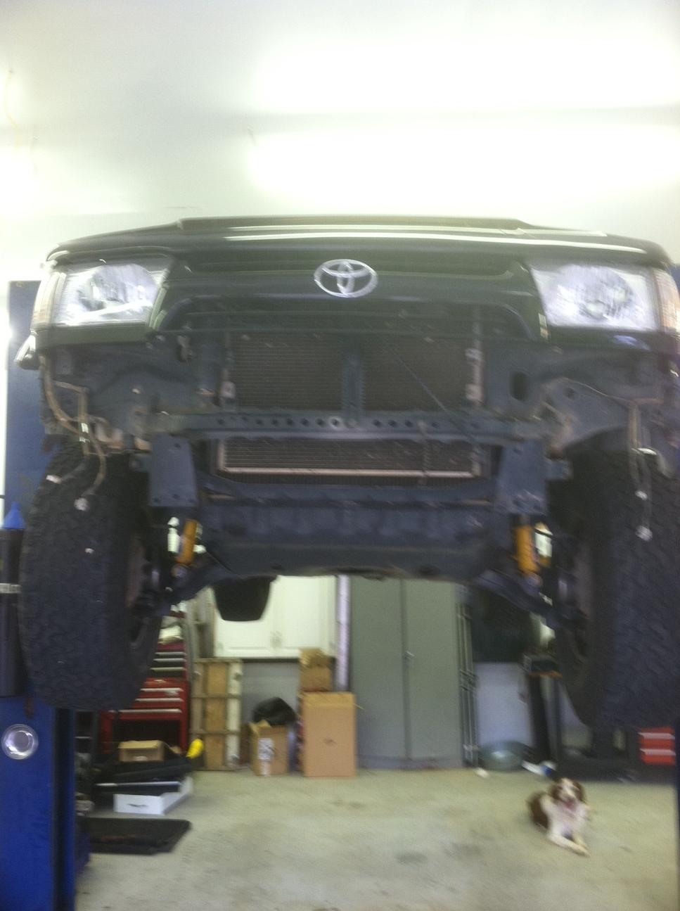

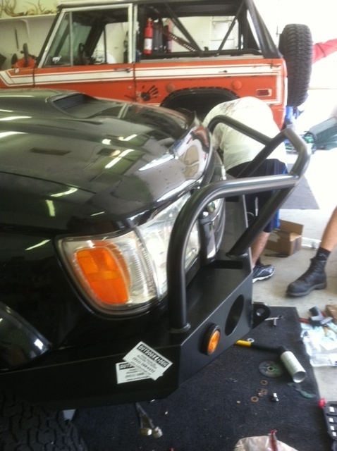

A good 1/2" drill bit, cutoff wheel, some wrenches and sockets and some electrical connectors is all you need for this project. The lift made it nice!

Thanks guys! BTW if anyone wants the stock bumper it is free for pickup. It is dented and the flares trimmed for tire clearance. Or is someone needs a blinker or parts off it. Hate throwing something away someone may be in need of.....Near Richmond, VA

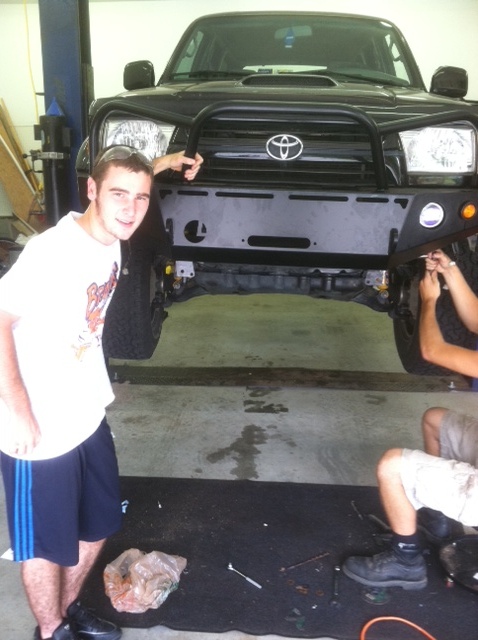

I used those slots across the top of the bumper. Used a big washer on the inside to strattle the slot. Had my son use his skinny arm to reach in the hole on top. Started the far nut hand tight then slid over to center to tighten rest of the way then added second bolt with big inside washer. Took all of 2 minutes.

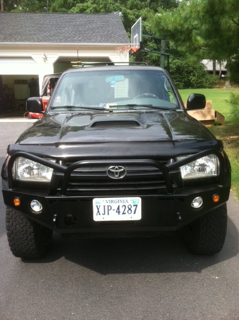

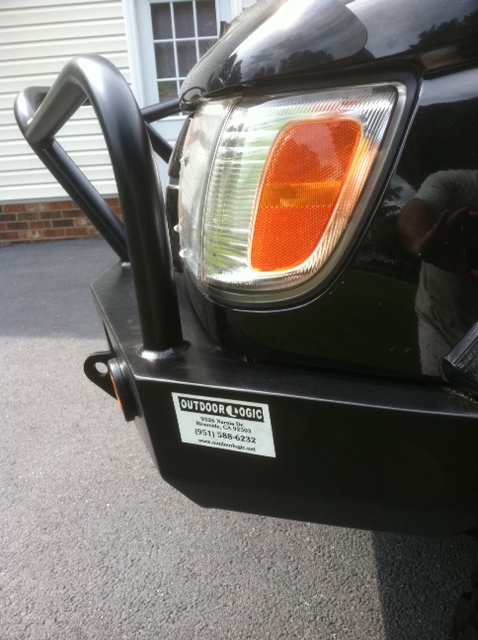

The black powdercoat matches perfect with the black runner paint! ODL exceeded all expectations-love it and recommend it. BTW at first I was thinking of going without the tubes or maybe just the front guard but the way the tubes run are so sexy and make it stand out, not to mention protection! Money well spent and the welds are beautiful!
Since Jimmy was running a sale with the saved money I splurged on the hoops, powdercoat and the lights. I went with the Halogen's Jimmy sells.
