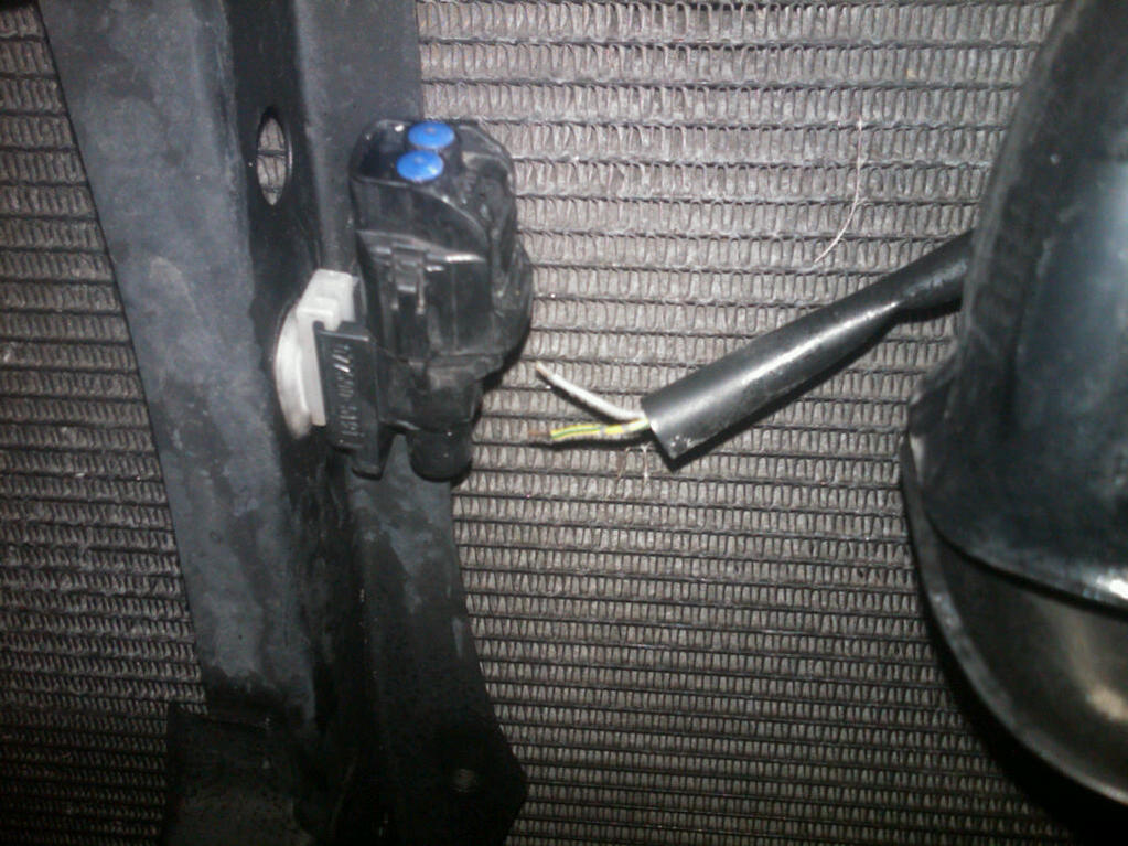

Thanks! This was a good idea and I found the sensor, I believe. Moreover, the wires are pulled from it. I've attached a photo. I could not remove the sensor from the vertical support (with my very cold hands) but wonder if anyone knows how to rewire the contacts through those blue round things that look like seals.
I'm no expert but most parts are plug in or snap in. From your pic it appears the sensor might be able to "unsnap" from the white piece attached to the support?? This would at least give you a better look at how the wires attach. I would check mine, but it's about 10 degrees here as well!!

Thanks! I'll be back at it today. I tried sliding down off that white clip last night, and spent about 10 minutes on it but could not find a way to remove it. I'll give it a fresh go and see if the device comes apart. One question I would ask for anyone who has the chance to look at theirs is this: can you tell me what order the wires connect?
Mine looks as if the colored wire goes toward the front of the vehicle and the white wire toward the rear. Frankly, it's such a cheapy, wobbly thing that I didn't want to mess with it too much for fear of mine falling apart. I have no idea how to reattach those wires--sorry I couldn't be of more help. Regards, Mike

Here is what I settled on, and I'm going to type out some detail for anyone who searches for this problem in the future. I went to the dealer and bought a new sensor, but it was just the bottom half of the object in the photo I attached. The top half, with the blue rubber circles, is the bracket. It was easy to separate the two halves, but the wires missing from the bracket really meant that the bracket was destroyed. The parts guy at the dealer was unable to locate a new bracket, but he did find two leads, each attached to 4 inches of wire, which he was able to insert into the broken bracket, essentially replacing the metal contacts inside and the washers that were behind them (the blue things). After dinner I will cut the wires and splice the rebuilt bracket onto them, and will hopefully report success. Total cost so far is $42 ($26 for the new sensor and the balance for the two new leads).
It is hard to describe the above so if anyone is ever in a similar jam, PM me.

Confirmed, it worked. All is fine now. Thanks for the help, guys, and I hope this thread is useful for someone else someday.
