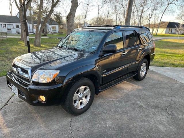

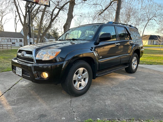

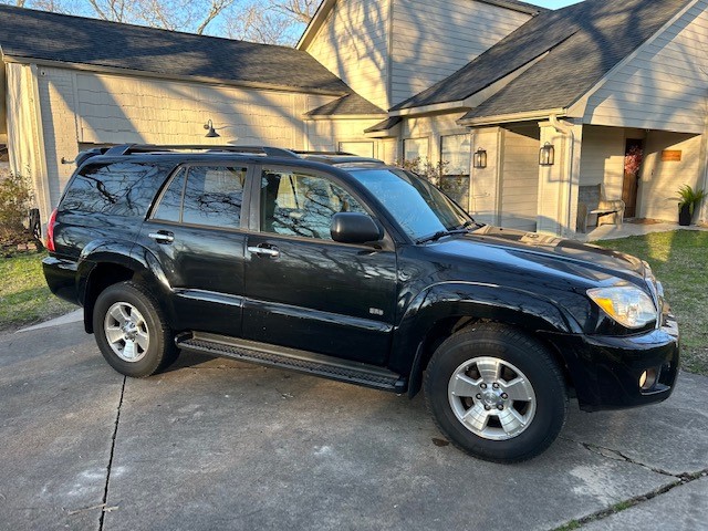

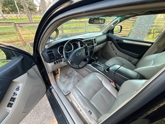

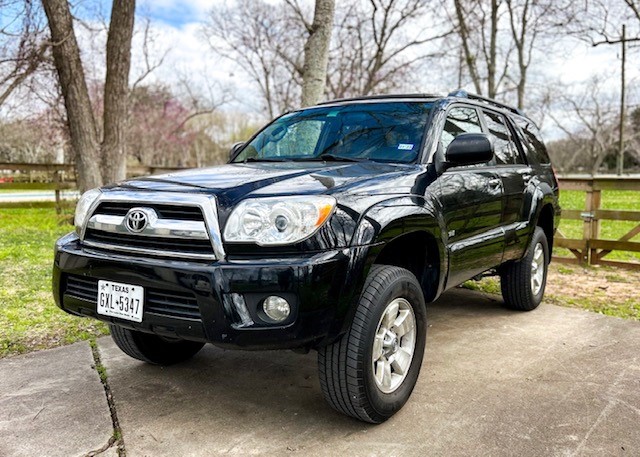

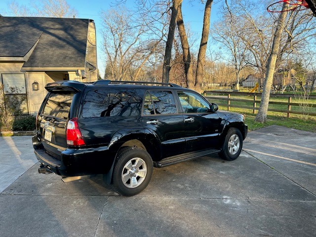

We are working with a bone stock '06. Leather interior and a sunroof top off the 'upgrades'. Grandma was the original owner and has taken excellent care of it.
The paint is decent overall, but shows its age. There are not many dings (surprisingly) but a few deep scratches. We will be looking at either a paint job or a wrap.
The tires have a little life left, but perfect timing to install a lift and upgrade.

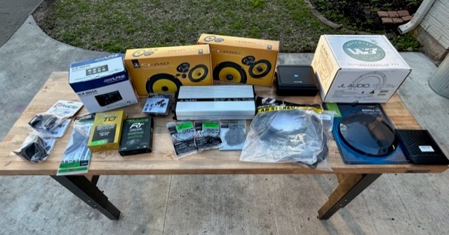

To get things started, it was decided that we would upgrade the headunit to one with Apple CarPlay, Bluetooth, and a backup camera. All makes complete sense as any one of us would have enjoyed those comforts when we first learned to drive.
So with that direction, I ordered up a full stereo system lol.
I went with an Alpine iLX-W650. My preference in h/u has always been Alpine. This is their least expensive unit with CarPlay and will do everything we need it to. I ordered it from Crutchfield and packaged it with all of the harnesses and brackets needed.
I'm pretty sure I heard some crackling in the 17 year old speakers, so I ordered a JL C1-650 component set for the front, and pair of JL C1-650x coaxials for the rear doors. These are part of their entry level line of speakers and I think they will do just fine.
I already had in possession some other brand new gear. A JL 4-channel amp, Alpine mono channel, JL 10w3 sub, and the backup camera.
We ordered a Proclip phone bracket and mount. I use their brackets in all of our vehicles. Also ordered an amp wiring kit (not pictured). The small black envelope on the bottom right corner of the table is a set of LEDs to swap in for all of the interior dome/map lights.
My son and I will build the sub enclosure, so he will not only get to learn stereo install, but he will get to help with some wood.
Total investment so far: $1035 (not including amps and sub)

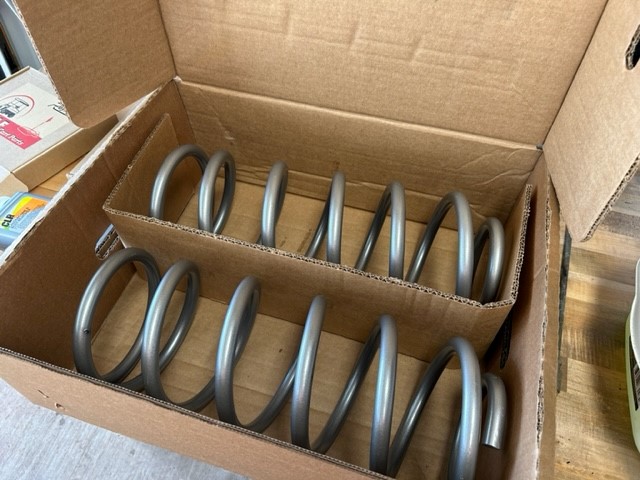

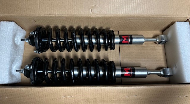

I ordered the lift today. It is the Rough Country 3" kit with the M1 monotube loaded struts and rear shocks and coils.
For my price, I think it is going to be hard to beat. Without going too far down this road, RC gets beat up for their entry level Nitro level of shocks, which in truth are the same as any other nitro shock out there. However, I think this upgraded monotube shock will ride quite nice.
I will be transparent with my actual opinion after we get some seat time with them.
Stay tuned

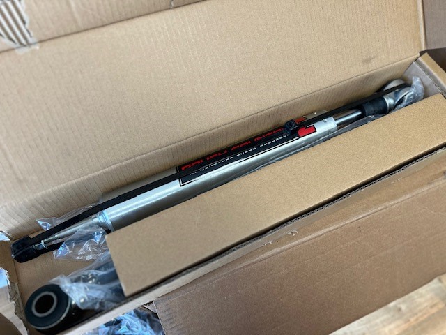

The rear shocks showed up today. Was really hoping to get everything installed today, but the front struts won't be here until tomorrow.
Still not bad considering I ordered the kit on Thursday.

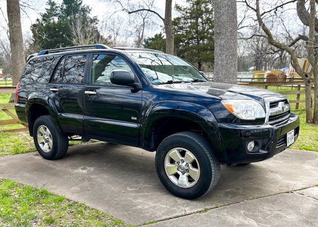

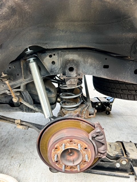

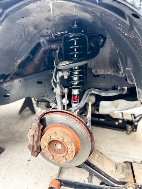

The lift install was completed this weekend. We had a good time and did not run into any issues. I did one side with my son watching and then he did the other side.
With plenty of time under the vehicle, we did encounter plenty of original parts that are worn out. The tie rod ends and swaybar links are due for replacement. The UCAs will likely get replaced with aftermarket parts, so that will take care of those bushings and ball joints.
Once done, we removed the running boards and it really set it off.
The upgraded monotube shocks/struts are very comfortable and so far are a great ride.

Nice, clean Texas frame. What are you planning for tires and wheels?
I feel like all I see is people talking about rusted frames on these things. Previously never knew it was such an issue. Certainly not upset about not having to deal with it.

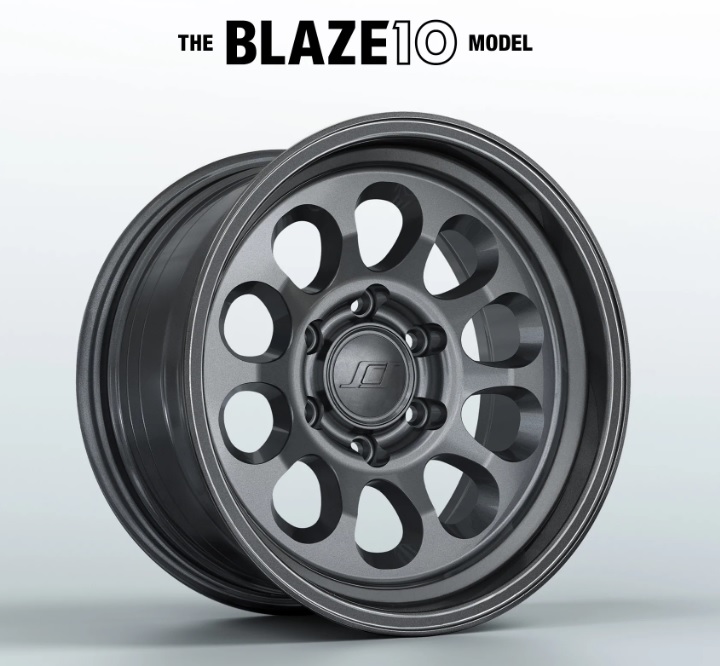

Still trying to find the right wheel. Thinking something with a -35/-38 offset would be best because we are going to stuff 35s in there. Right now, the SCS Blaze10 in black is on the list.
Also fully expecting to do a body mount chop and 1" body lift.
For tires, either Cooper STT Pros or BFG MTs. He wants aggressive.
Wheels and tires would set it off, looks great so far though, good luck!
Thanks! Coming soon!

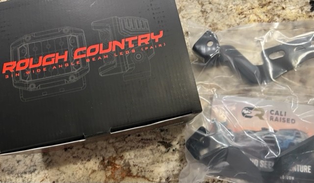

The Cali Raised low pro ditch light brackets came in today. Was planning to go with the CBI, but was intrigued when I saw the low profile option from CR.
Lights should be here tomorrow.
I also ordered the SRQ Fabrications body mount chop weld plates. It looks like their rounded style (and a couple others like them) remove the most material. They also appear to leave the cleanest, more factory look.....not that it is that big of a deal :).
