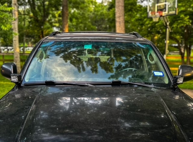

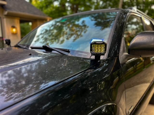

We installed the CaliRaised low profile brackets and ditch lights yesterday. No telling what the actual angle of the lights will ultimately be, but that lined up with the angle on the top side of the brackets.

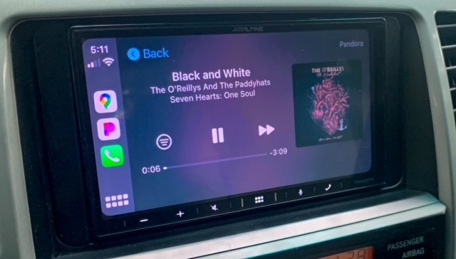

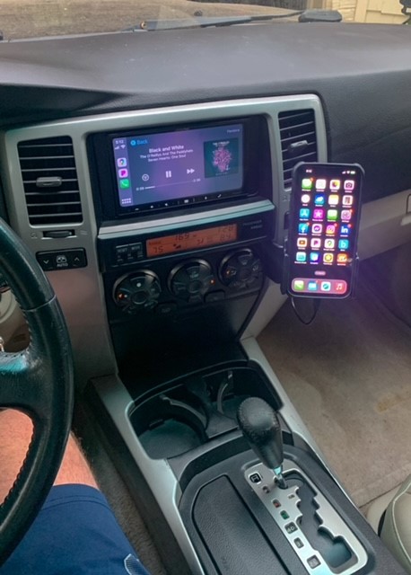

Finally got around to installing the new headunit. It is an Alpine iLX-W650. We didn't get past just the headunit, so we'll come back soon to install the backup camera, speakers, amps, etc.
We also installed the ProClip bracket and phone mount. Hands free for our teenager is the name of the game here.

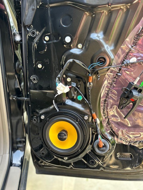

We got the new front speakers installed yesterday.
JL Audio C1-650 series 6.5" component set.
I apparently got the wrong speaker brackets for the rear doors from Crutchfield, so I ordered those on Amazon and they should be here today so we can get those speakers installed.

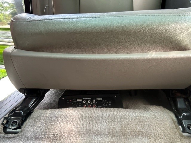

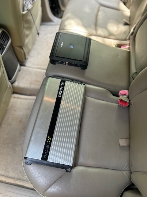

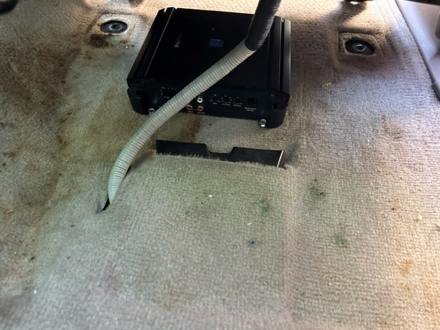

We also got the amps mounted. I wasn't sure where to hide them until posting on FB. Everyone said under the front seats. Until I unbolted them, I didn't realize they would fit.
The JL 4channel is under the passenger seat and the Alpine sub amp is under the driver's seat.

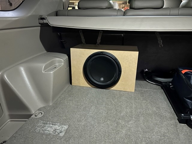

On Sunday I ran wires and built the 'temporary' sub enclosure. It will be a minute before I design and build the permanent enclosure, so I wanted to be able to use the sub for now.

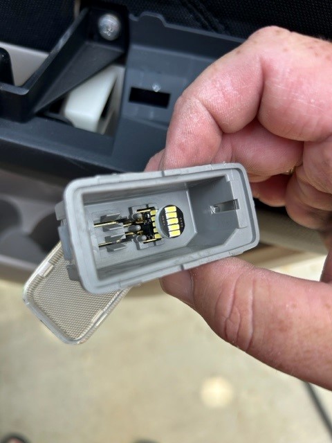

I also swapped out the interior dome light and door lights with LEDs. I still have several left from the kit that I have no idea where they go.

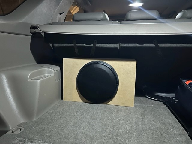

I finished putting the temp enclosure together. I have some bedliner material I will roll on next to make it a bit more presentable.
I built it to the JL specs for the 10w3v3.
I went to give it a quick test and the amp didn't turn on. I think I need to improve the ground situation. I grounded each amp between the body and the respective seat mount. I don't think I removed enough paint.
Will give it a go again tomorrow evening.
Edit: I went back to it this evening and got the amp on and the sub thumping. It sounds fantastic. Now I can't wait for the distribution block to arrive so I can get the speaker amp powered up.

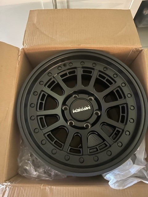

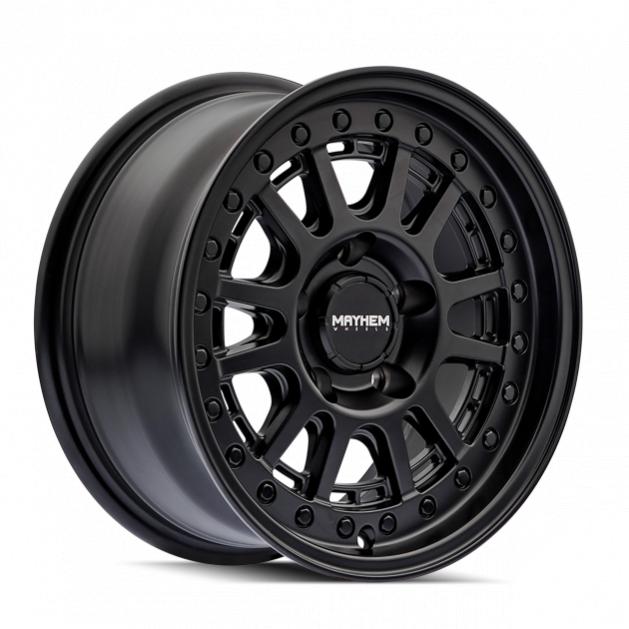

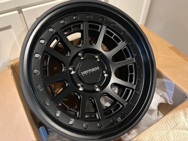

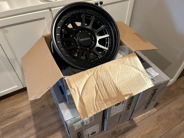

We finally decided on a wheel so I got those ordered today. We went with the Mayhem Compass 17x9 -6 offset.
It is pretty tough to commit to an offset without knowing exactly how it will fit. My biggest concern is clearing the UCAs with a 12.50" wide tire. I didn't want to go crazy with the offset and have to deal with extra rubbing issues in other places. I also find it silly to buy an aftermarket wheel just to run spacers with it.
With all that said....fingers crossed they fit well!

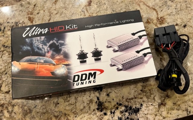

My mother-in-law gave him a set of HID low beams that I picked out. This is certainly a debated item, but I have had great success with HIDs and specifically DDM Tuning.
We got these installed yesterday and they look great. Install was a breeze. Thankfully there is plenty of room to mount the ballasts.

The wheels showed up today...tires on friday!
My son loves them so that's good!

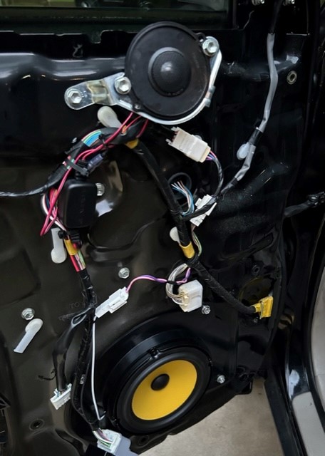

I installed the same speaker set a little while back but I'm not sure if I happened to do the tweeters correctly. Is there any chance you have more pictures of the front door wiring for that? My wiring wasn't entirely stock from a PO's install that I had removed so I want to verify things.
I don't have any close up shots, but I will have the panels off again soon to run the speaker wire to them from the amp. I'll grab a better pic then.
With the crossover that is included, there is a thin wire coming out on one end that plugs into the tweeter. The other end would essentially plug in to the mid-bass; however, you need to connect that end to the factory wiring harness that came off of the factory tweeter. What you end up with is the JL tweeter plugging in to the factory plug. If you don't do that, it will not work.
Not sure if that is your issue, but start there.
