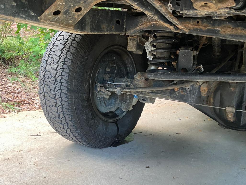

I recently drained and refilled my rear diff in my 2002 3rd gen. I do not have the greatest area to work from, so when refilling the rear diff, the vehicle was facing uphill (the rear diff was downhill). I filled it up until gear oil started flowing out of the fill hole, but squeeze a bit more in since it was facing downhill. I took out my 4runner this past weekend for the first time and put around 200 miles on it. Everything seemed fine and running smoothly.
However, a few days after it's been parked, I noticed gear oil leaking from the driver's side rear tire.
My question is, are the rear seals leaking because of a possible over-fill of the rear diff, or does my rear diff fluid exchange have nothing to do with it?
If it's just because I over-filled the rear diff, then parking on level ground and removing some of the fluid should solve my issue. Unless I've caused more damage to the seals with the leaked fluid. It's hardly any amount of fluid as you can see in the picture.
If this is just a coincidence, and my seals just happen to go bad and started leaking, then I need to look into replacing the rear seals and bearings, which I am hoping is not the case.
Let me know everyone's thoughts.

I have never seen a leak like that, it's almost like the seal is gone. Usually a little bit seeps out and gets flung around the outside of the wheel, in a radiating pattern. Your pic looks like an actual leak.

I am not 100% sure it's gear oil (I was making an assumption based on visual evidence). It's not sprayed radially like other leaking seals, so I'm wondering if it started leaking after driving and parking it. I only drive it on the weekends, sometimes every-other-weekend.

Looks like an axle seal leak to me. Put the rear axle on jack stands, remove the wheel speed sensor, and spin the wheel/axle shaft while looking at the tone ring through the wheel speed sensor hole. If it’s wet then your rear axle seal is leaking beyond any doubt.

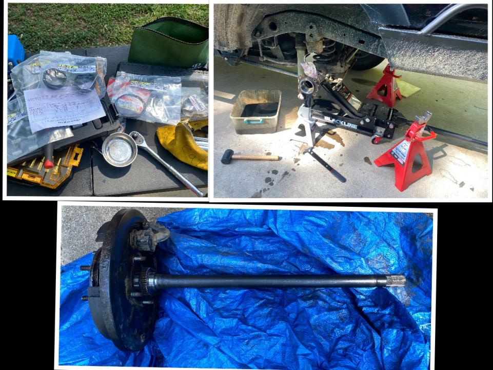

Back to the thread. I ended up replacing the drivers side rear seals, bearings, and associated parts. It was for sure a leak in the seal, there was gear oil where the seal and ABS sensor router meet up. I caught the leak soon enough, and the drum brakes were not soaked in. gear oil or showed any signs of oil around the brakes.
I took the axle and bearing to local Toyota dealership to press on the new bearings. I also asked them to use the mrcoffee method of flipping the inner bearing spacer. I also asked them to leave 3-4mm of polished axle. I didn’t perform grease test to see where seal was mating, since I’m not able to move bearing seal, I’m hoping the seal is good now. Time will tell. They charged me 1 hour of labor at $149, to remove old and press on new bearing.

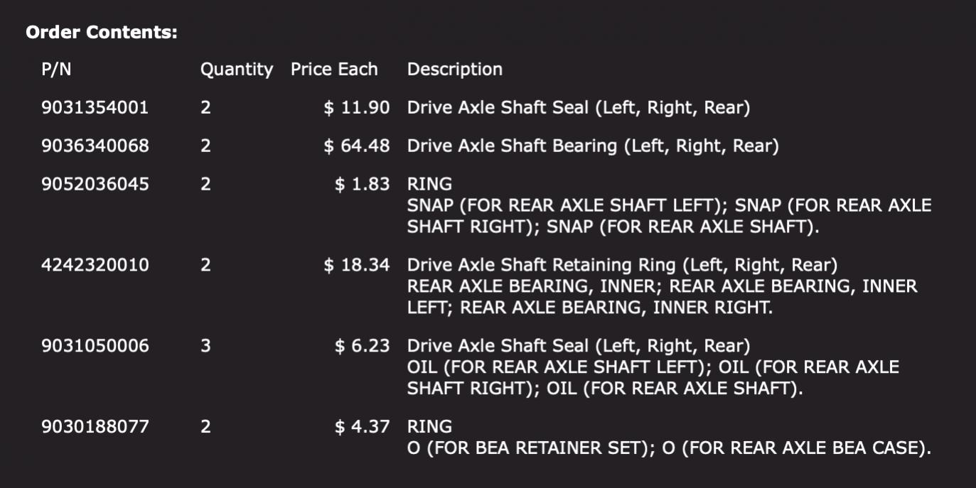

I wanted to do both sides at the same time, but my area to work only allows me to work on one side at a time. I have the parts to do the other side, but I’m just holding off to monitor the newly replaced side. Just going to monitor for now. Drove it around the block and no noticeable leaks yet. I’ll post some pictures of part numbers I used for my 2002 SR5. Be sure and checkout [MENTION=120071]mtbtim[/MENTION] videos and the description for parts for 1996-2000 and 2001-2002 a few parts for the job do differ. It cost me a total of $233.76 for parts for both sides to replace all the parts listed. I purchased 3 seals just incase I damaged one. Only need 2 (one for each side).
Plus another one $8.47 for new crush washers for the real diff drain and fill plug. Here is link to crush washer set.
I did use a hammer seal puller to remove old seal as a loaner for Advanced. The Lisle 56750 Seal Puller wasn't getting the seal out easily, I didn't want to damage the axle housing. The loaner tool pulled it out with 2-3 slides. Works perfectly. I used this tool to help drive in new seal , it worked best with the 76mm head.
Hope this helps anyone else preparing to do this job.
