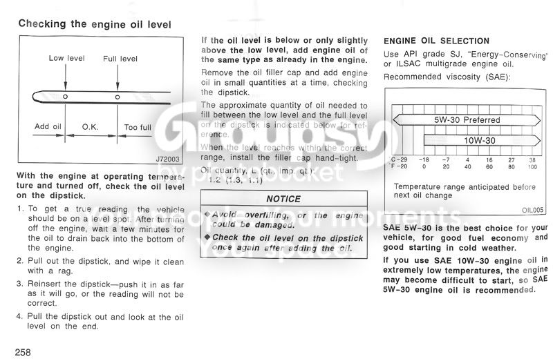

Specs as per manual
your owner's manual should state the oil capacity, with and without oil filter. just read it.
sadly, when i bought mine, it didn't come with one.
5VZ-FE engine
With filter ------------ 5.5 qt.
Without filter ------------ 5.2 qt.

Page 199 says...
"With the engine at operating temperature and turned off, check the oil level on the dipstick"
"1. To get a true reading, the vehicle should be on a level spot. After turning off the engine, wait a few minutes for the oil to drain back into the bottom of the engine."

Scanned my owners manual last night, just for this thread..... :dancin:
Oil-specs-2001-4Runner.jpg~original
