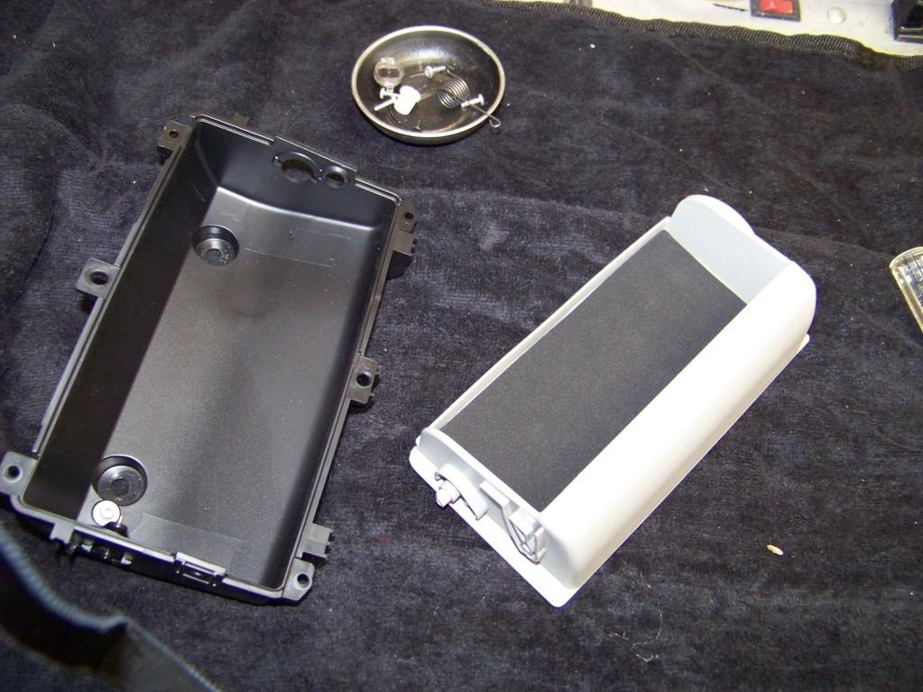

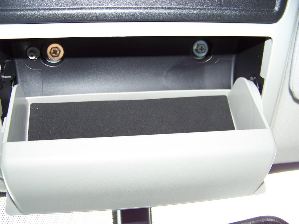

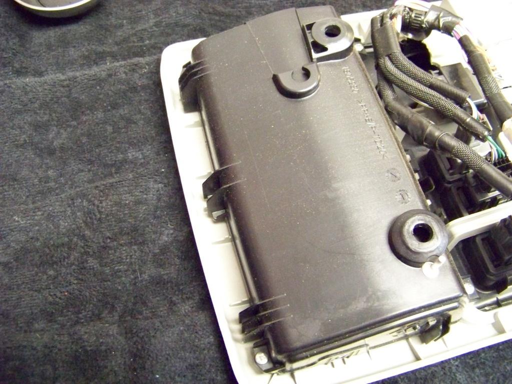

I took mine apart to mount my Scangauge in there- here are some pics...
It's not too hard to take apart or put back together, but I doubt the spring is the problem. It probably has something to do with the latching mechanism, or somehow the console is "racked" and the opening isn't square with the lid. There is a cam that fits into a slot to keep it closed, along with a friction mechanism.
I think you should take it out and do some trouble shooting.
Post some pics and we will get it fixed!
