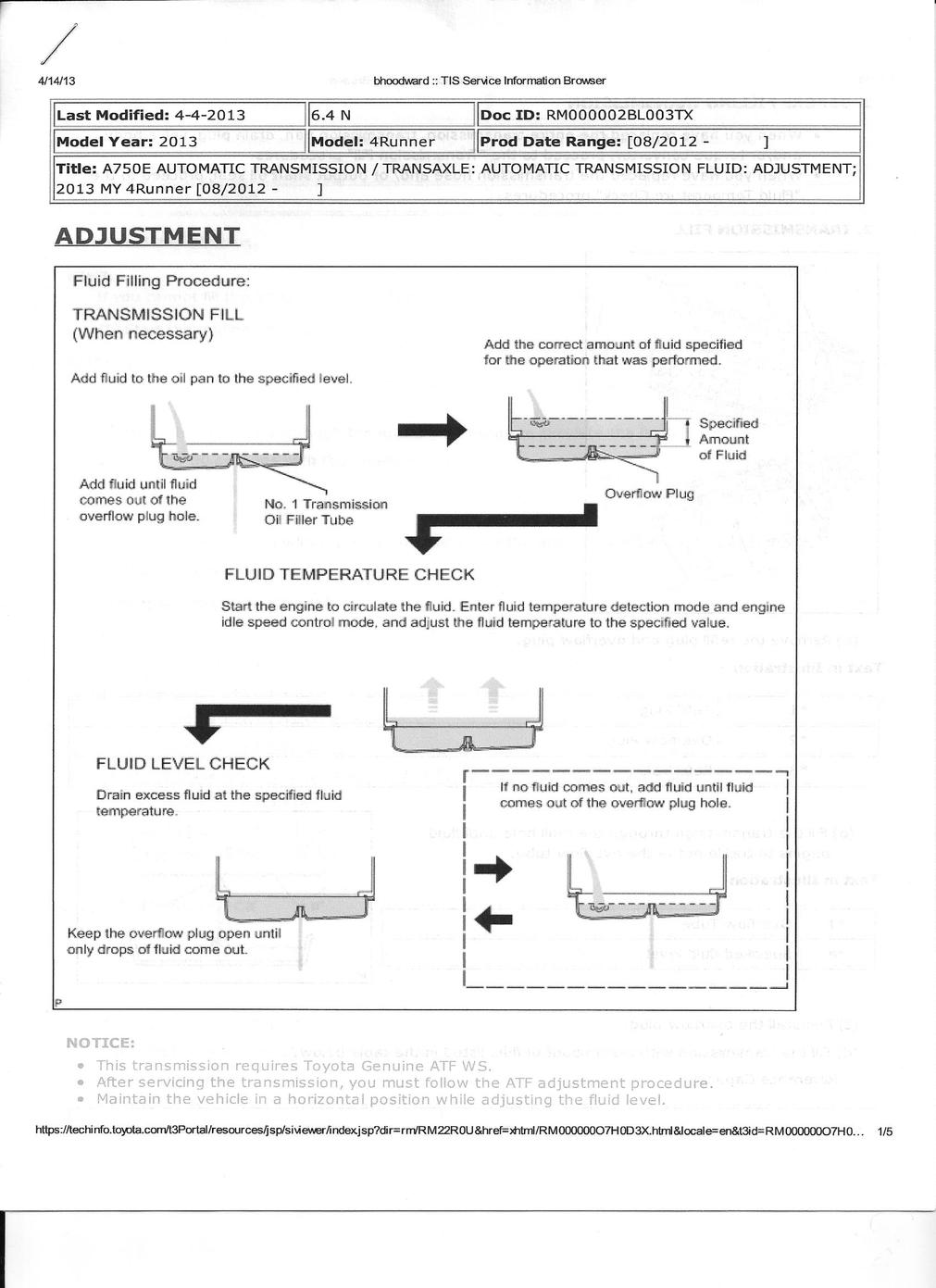

Just did first drain and fill I've done on my 4Runner's transmission at ~76k miles. Easier and less time than an oil change. Almost as easy as transfer case fluid change. Also replaced brake fluid, the rears are so easy since the pump prevents the brake cycling.

Transfer case and transmission is something I need to learn to do ...
Transfer case is as easy as changing diff fluid. Transmission is the tricky one with fluid levels, here is a good overview.
