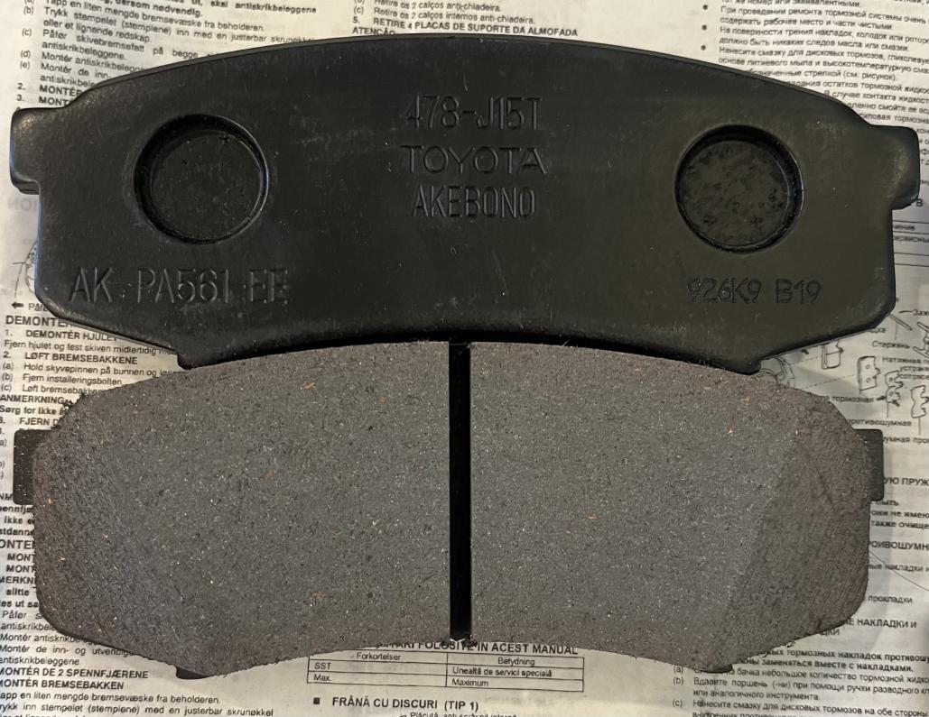

I’ve been trying to order rear pads part no: 04466-60140 but they are listed as ‘Part Is No Longer Available’ at the Toyota parts sites I use and others I have checked. One place has a TRD replacement option for double the price ($90). I also found 04466-AZ103. This appears to be a ceramic pad option.
What replacement rear brake pad part number should I be using?
Can the ceramic pad be used with the stock rotor 42431-60311?
Listing parts as “no longer available” without superseding is a disturbing trend. They did this with spark plugs awhile back but they were made available a little while later. The OEM air filter is still listed as unavailable.
Personally I would not use the TM or AZ Part numbers, they are lower priced parts to make dealer repair more price competitive.
I would lean towards Advics or Akebono if I went aftermarket.
The OEM fronts are Advics and the rears are Akebono.
