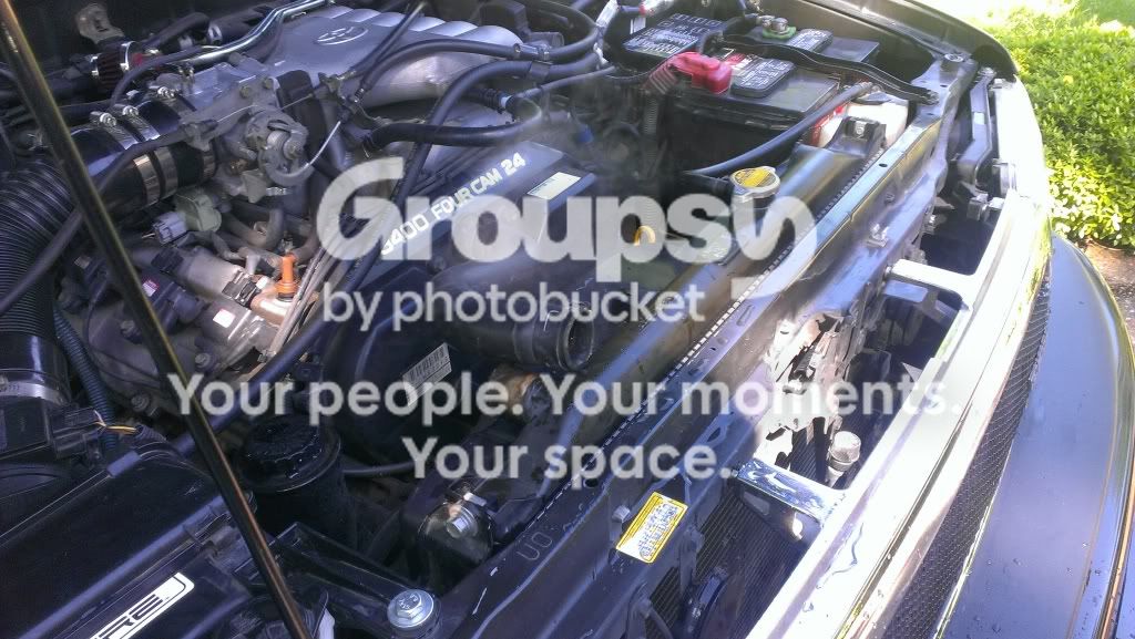

So last night I threw a little coolant in my radiator because it seemed a little low. This morning I pulled in my school and one of my friends points at my truck and says its smoking. Sure enough it was. I popped the hood and it was the radiator so I figured it must be leaking right? I mean why else was it low last night? So I pulled of the skid and I dont see any sign of leaks. I pulled of the top radiator hose and an a*s load of steam came out. I'm letting it cool down now, but I'm at a loss. Could I have over-filled the radiator IDK I'm at a loss here. Quick response would be much apreciated!

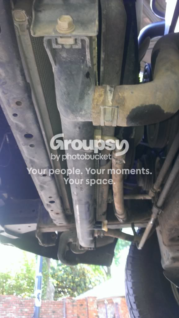

Heres the underside of the radiator. As you can see its bone dry. Ignore that bit on the hose, that was me
If it's smoking out the exhaust, bad joojoo. Blown head gasket. Best case is a pinhole in one of the hoses. Check the passenger floor board for moisture, blown heater core.
Yeah headgasket is fine, that was the first thing I checked for. Thanks, I'll look. In the meantime, any more suggestions would be greatly appreciated!

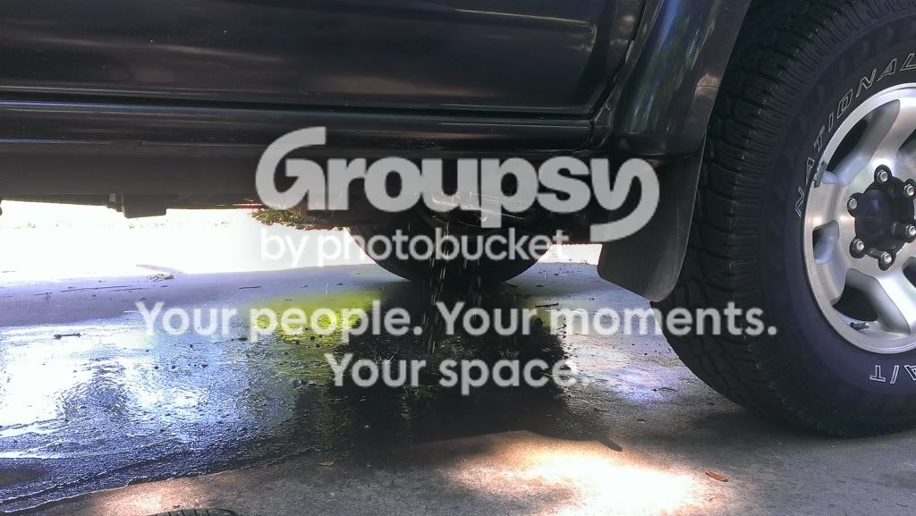

So I started pouring coolant in the radiator. I only had one gallon so I used the water hose to fill it up (I was going to go straight to autozone) anyways the damn radiator doesnt fill, instead it stats pouring (and I mean pouring) out from underneath the car. WTF! So I followed the water. It leads up to the back of the engine. Right under the manifold. There is a hose that runs into the block and the contecting peice seems to have coroded. Have any of you had this happen before? I have never heard of this problem on the 4runner. Help!
Pic of water running out of the truck:
I found your problem. :D
Well, I was going to tell you to put out some cardboard to find the leak...
Make sure that the hose is the culprit, and not something above the hose, leaking down onto it. Have someone pour water through your system, and diagnose it that way, so your not wasting coolant and polluting. Good call on just using the water. Thats one helluva leak my friend. Is there a physical hole in the hose?
Follow the entire hose and tell me where it starts to finish. Your going to want to fully remove the hose, and track where the factory ran it through. You'll want to reinstall it the same way. This is because of hot components in the bay, it might burn a hole straight through the hose if its ran incorrectly, and sits on a hot surface. So follow the experts.
Take the hose to your nearest auto parts store, and they should have a roll of various hose sizes in the back. Get the same diameter, obviously. The Advance Auto by my house has Goodyear rubber for their hoses, so I trust it. Just get the identical length and replace it. Get new clamps for the hose as well. I'm sure their rusted up, or at least insufficient at this point. Get some metal hose clamps that screw tight, like these:
220px-Hoseclamps.screw.agr.jpg~original
Check for a waterfall underneath your vehicle, and then go from there...
