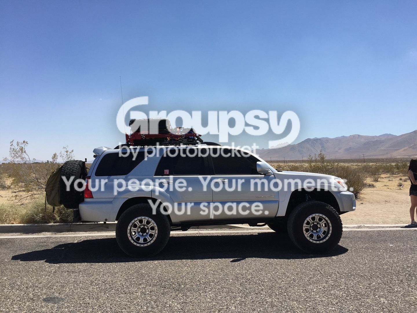

I updated the parts list and added new photos (page 3 and 4)
Heres my 2008 Limited 4x4 v8 build.
Enjoy.

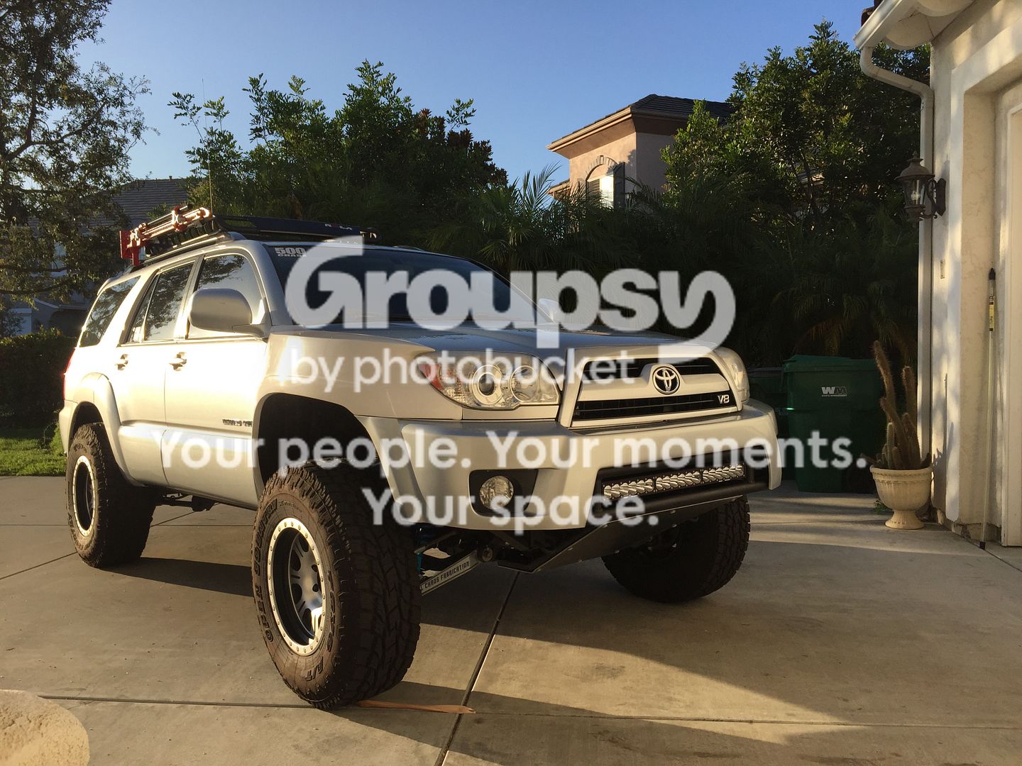

Front end

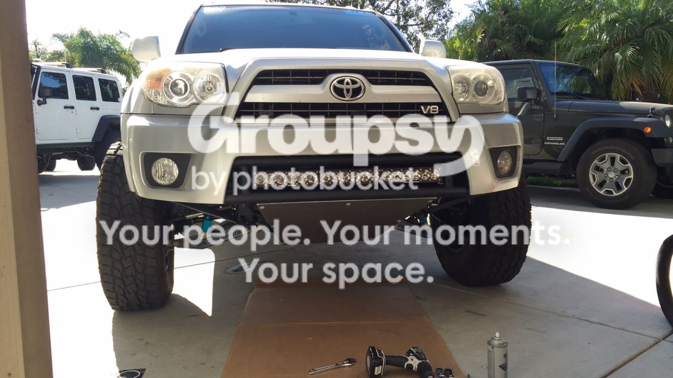

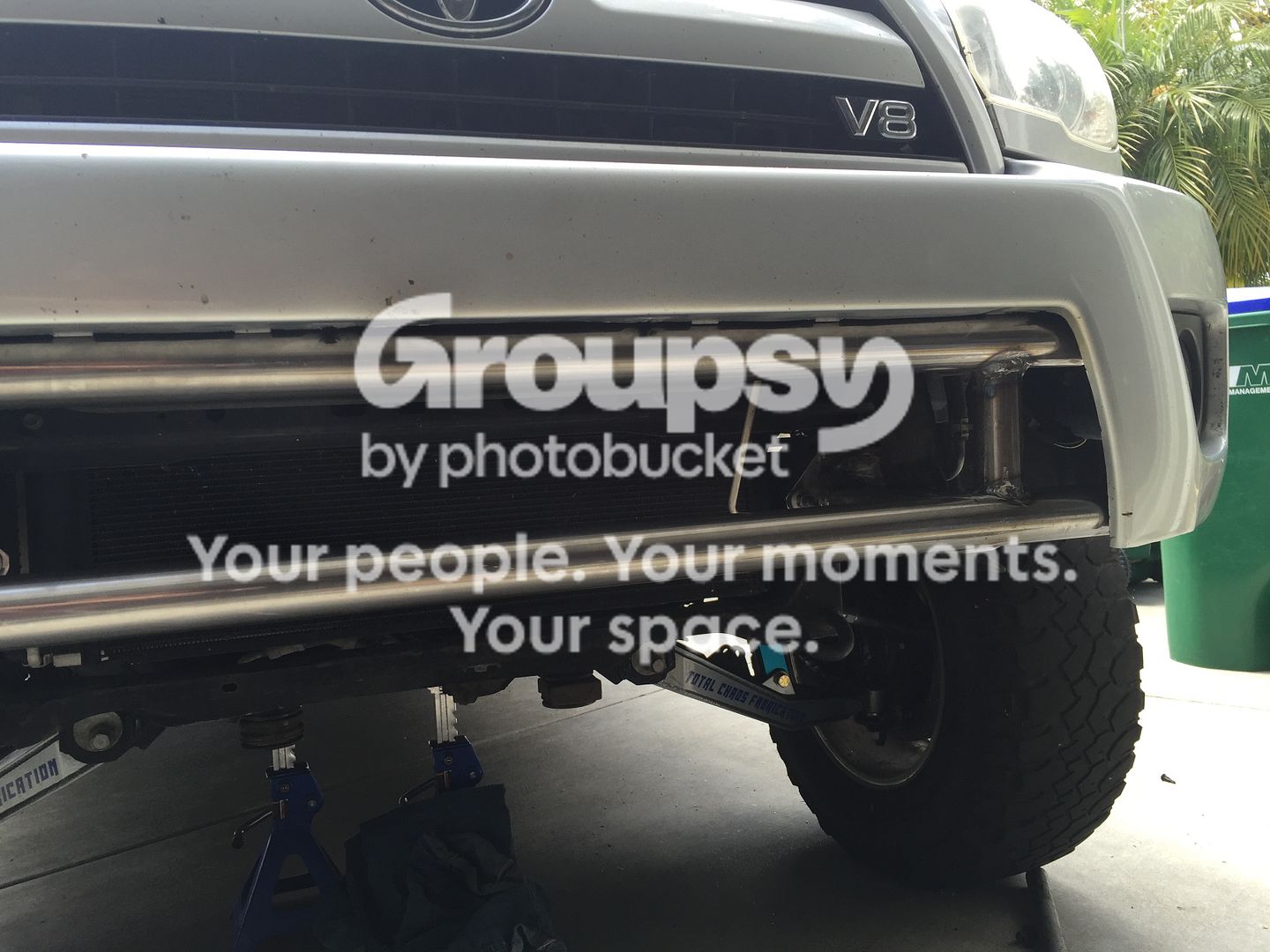

Garage built custom half hidden tube bumper/skid
Baja Designs OnX6 30"
Baja Designs XL Sports
EBay brand rock lights
Fiberwerx fiberglass fenders

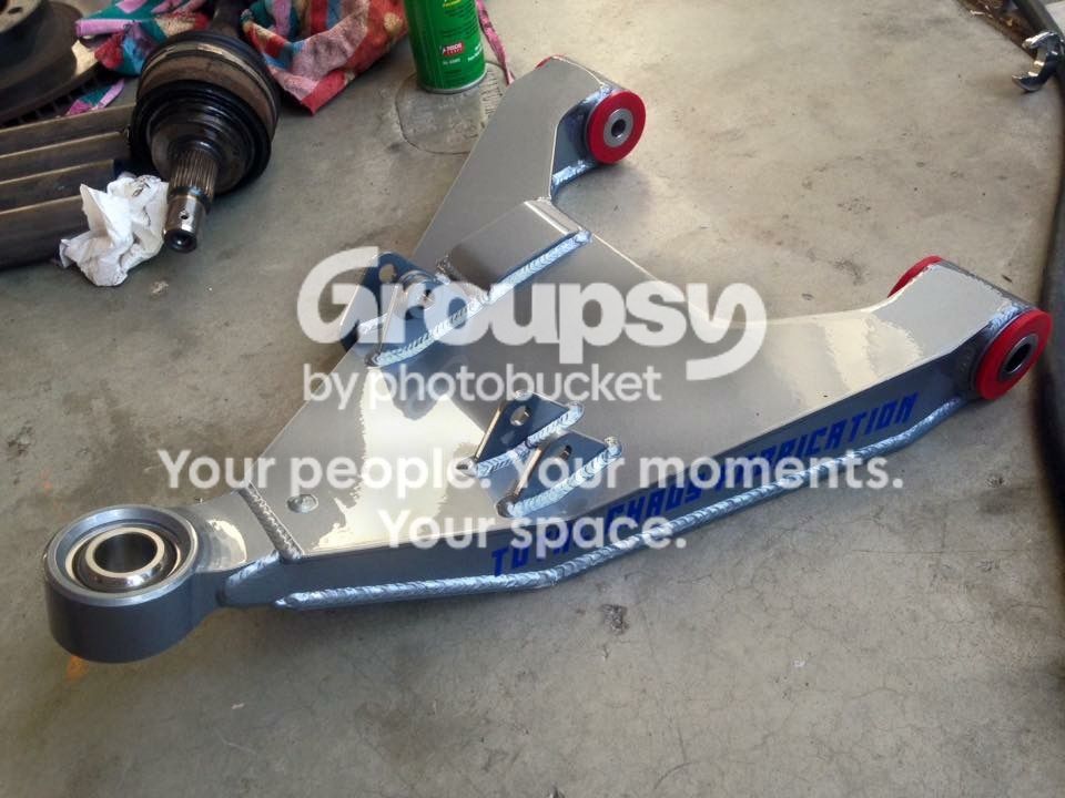

Total Chaos Fabrication 3.5 over race kit
8" king coilers
Fox 2.0 hydraulic bump stops
Secondary shock hoop
Spindle gussets
Shock tower gussets
Alignment tab gussets

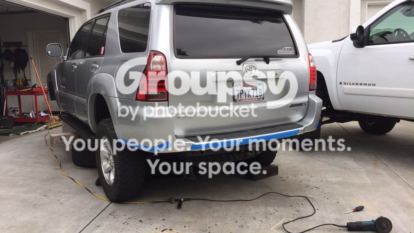

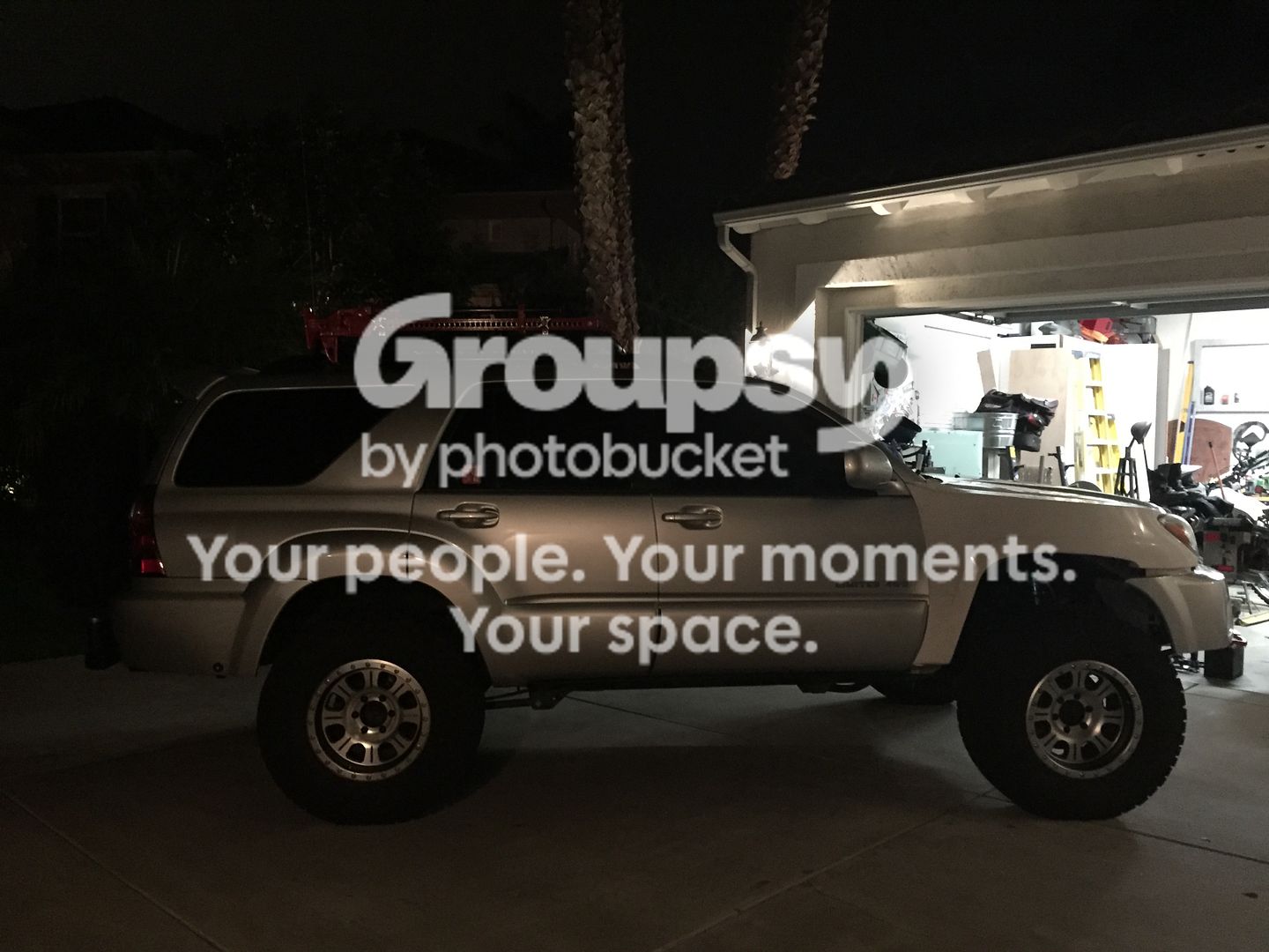

When I picked her up :D :
IMG_5935_zps1utzlx4z.jpg~original

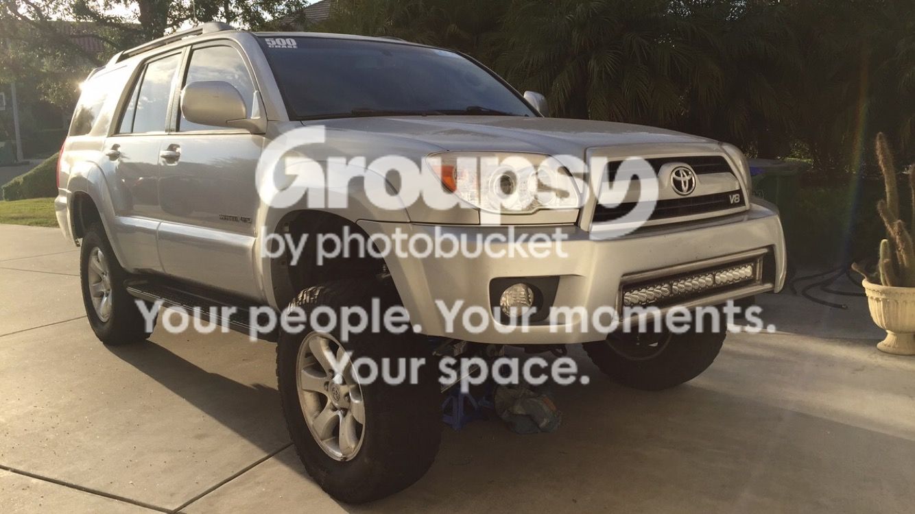

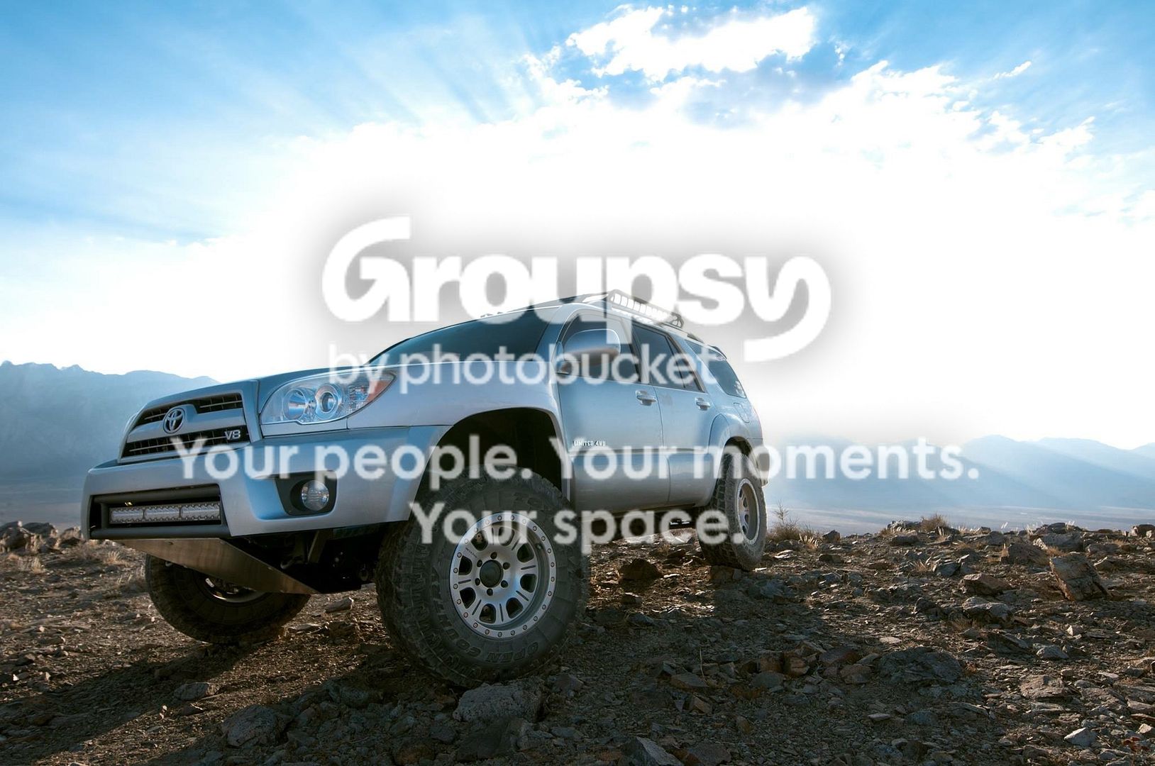

Current look:

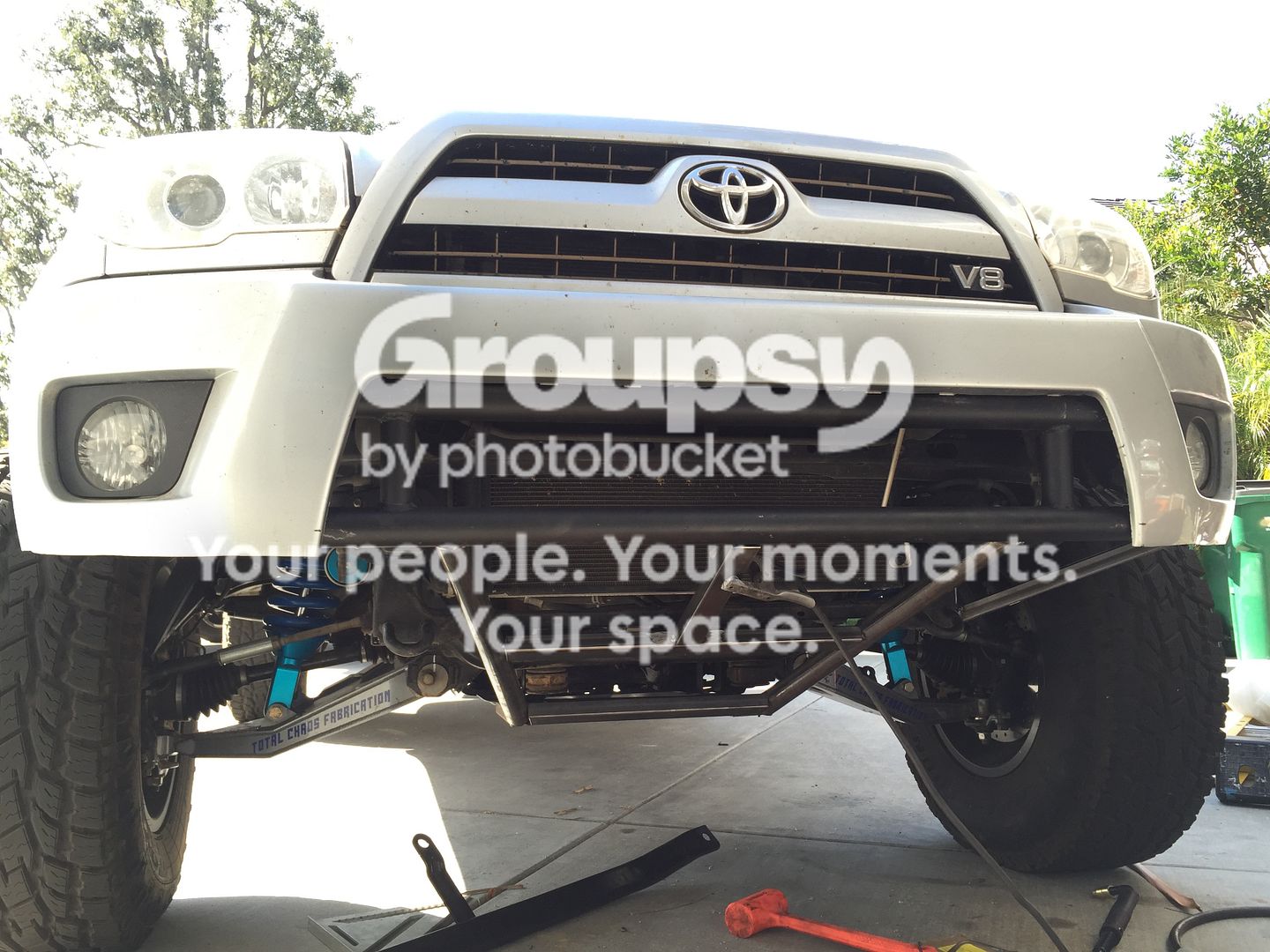

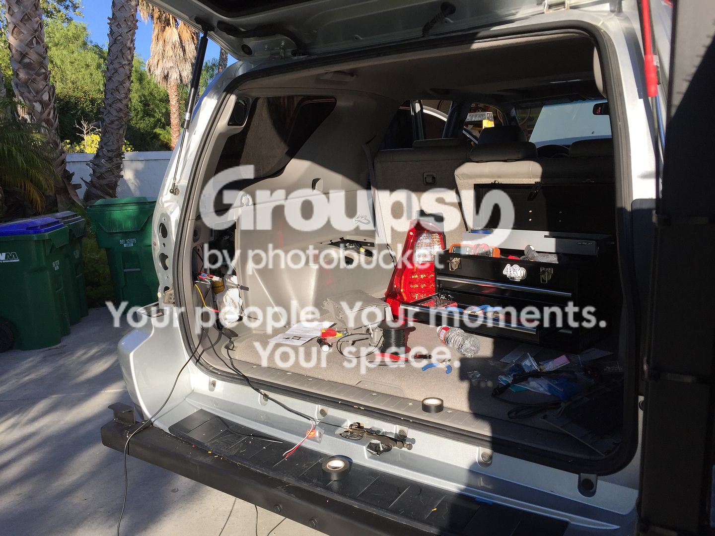

A lot of photos to come!! From the beginning on my life with her to the present. Now lets start.
IMG_5917_zpsn2szi5a7.jpg~original
IMG_6160_zpschufqadq.jpg~original
IMG_6161_zpsjxeqbrmm.jpg~original
IMG_6132_zpsixqhymkh.jpg~original
IMG_6138_zpsiduqtdn4.jpg~original
IMG_6163_zpsaxliqbxv.jpg~original
IMG_6120_zpsu9tzobql.jpg~original
IMG_6119_zpspdaanec5.jpg~original
IMG_6118_zpsgpfgiwry.jpg~original
IMG_6174_zps7u9kbnq1.jpg~original
IMG_6175_zpsfkkyok96.jpg~original
IMG_6189_zpsf9zdpyfz.jpg~original
IMG_6177_zpsk0wgshrz.jpg~original
IMG_6195_zpsvqrnlxud.jpg~original
IMG_6197_zpswzdbyojs.jpg~original
IMG_6196_zpswoylldkk.jpg~original
IMG_6199_zps4ymr2vop.jpg~original
IMG_6217_zpsv1vg6itj.jpg~original
IMG_6218_zps4pedrtdy.jpg~original

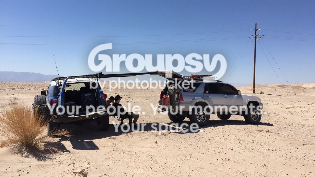

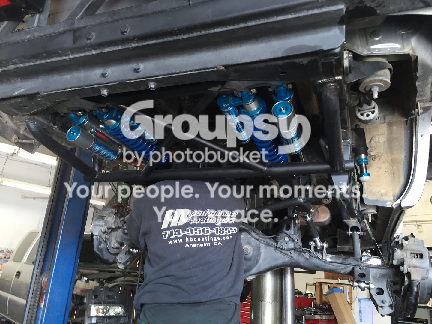

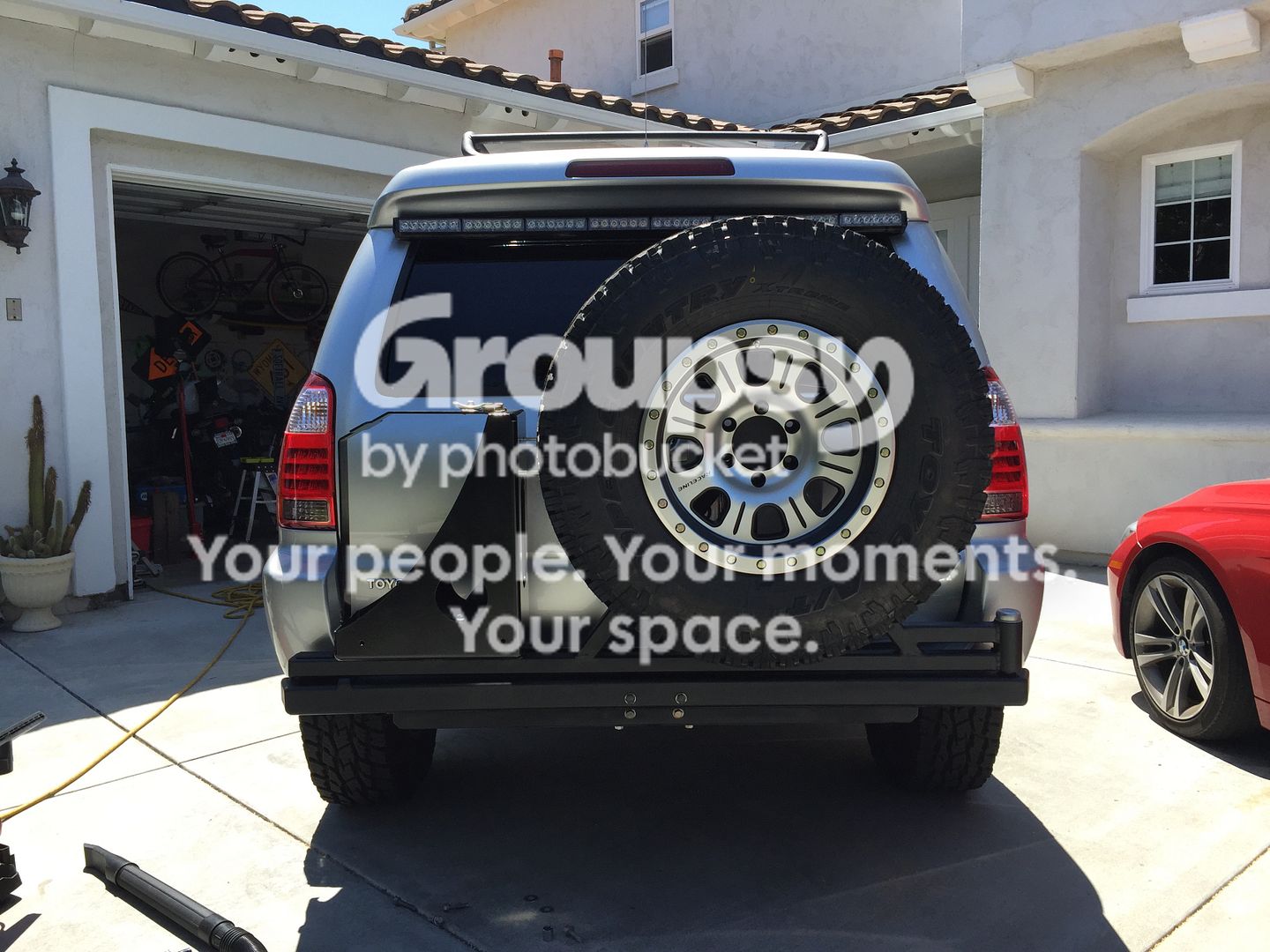

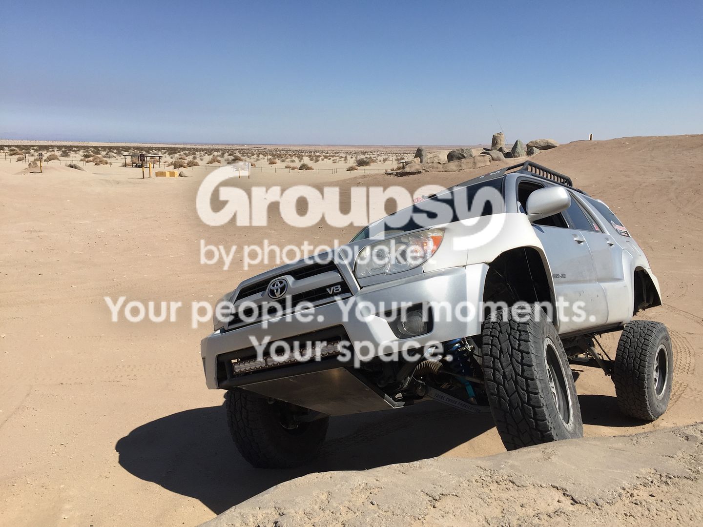

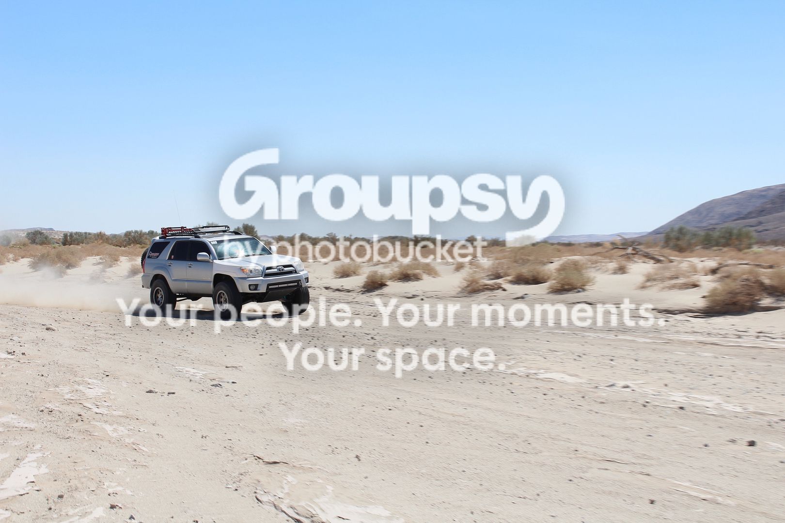

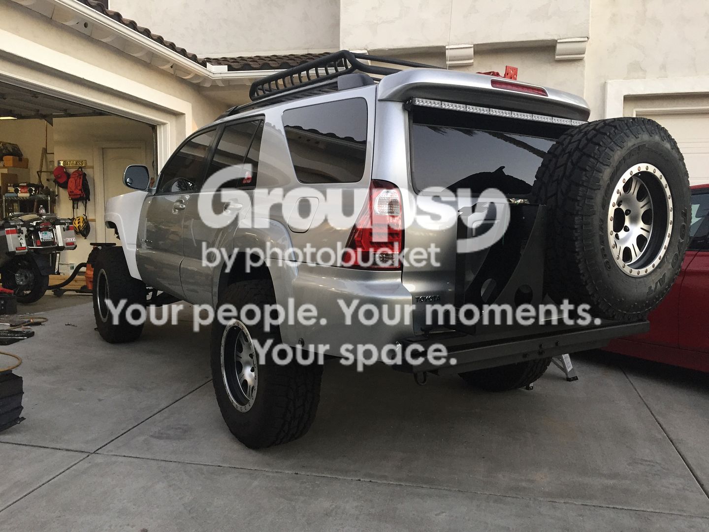

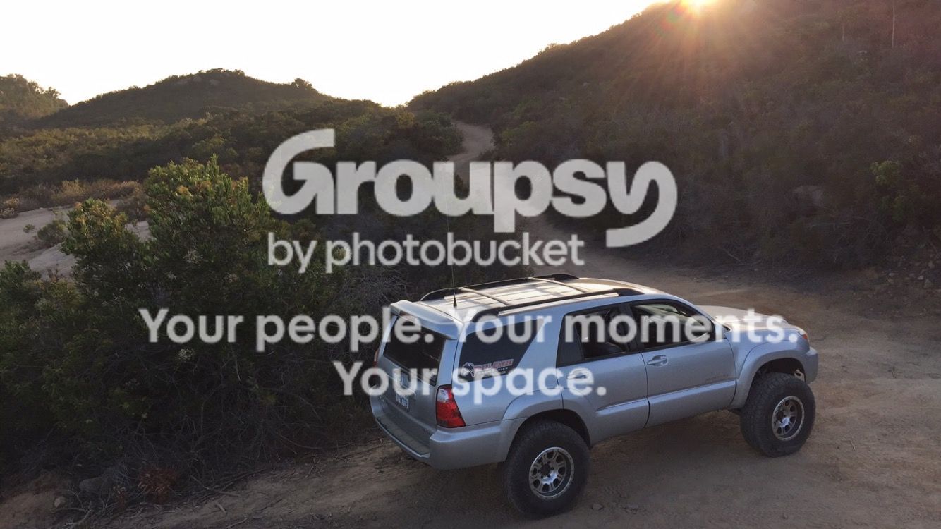

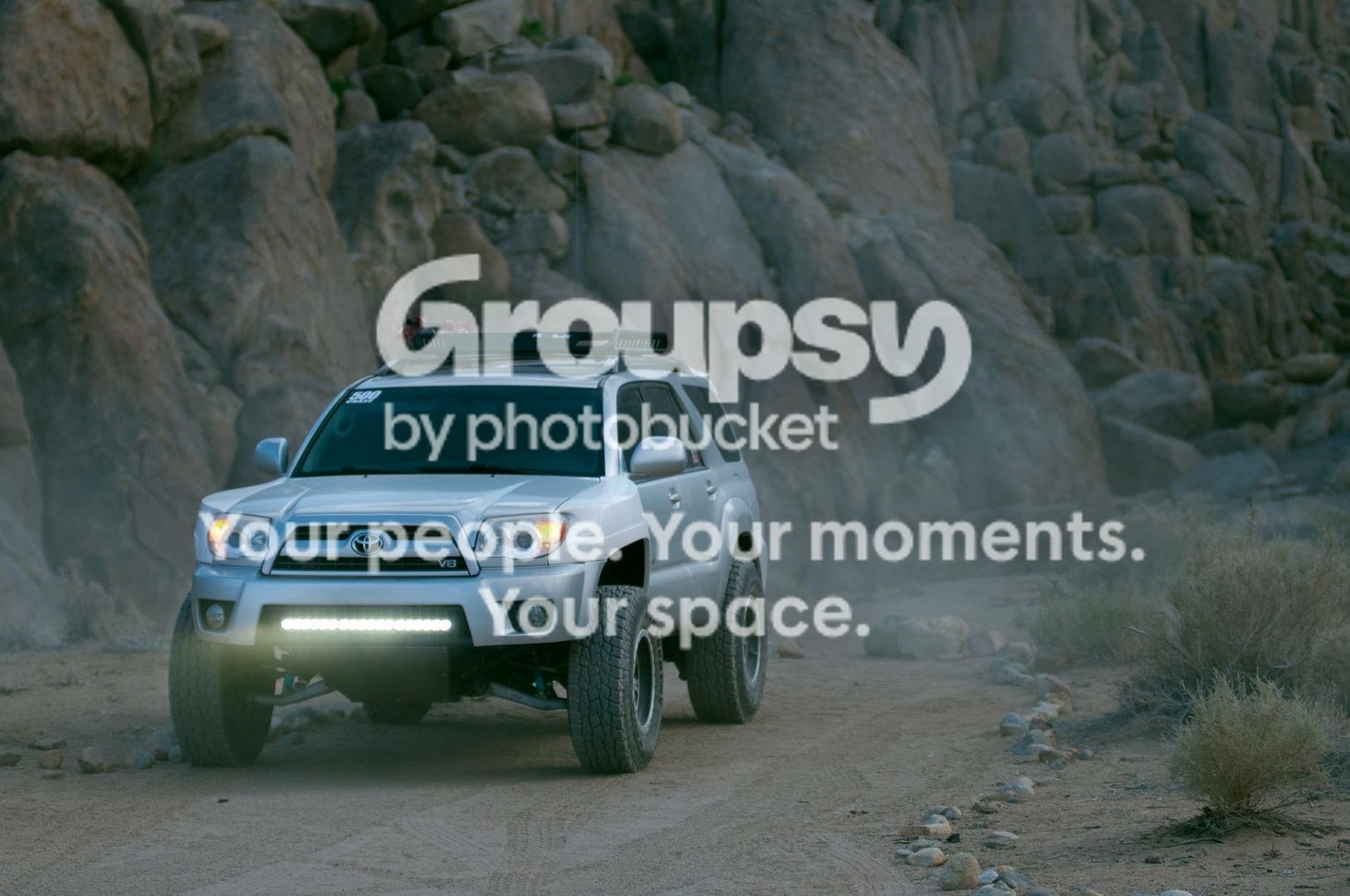

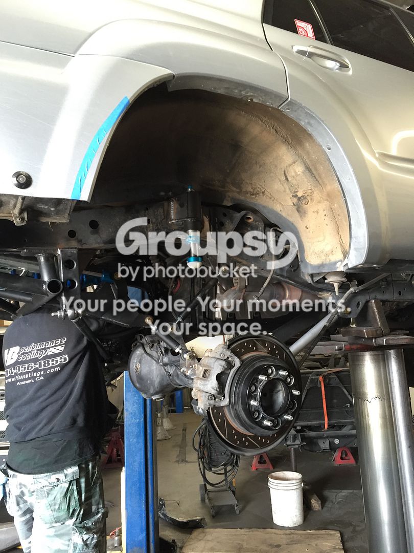

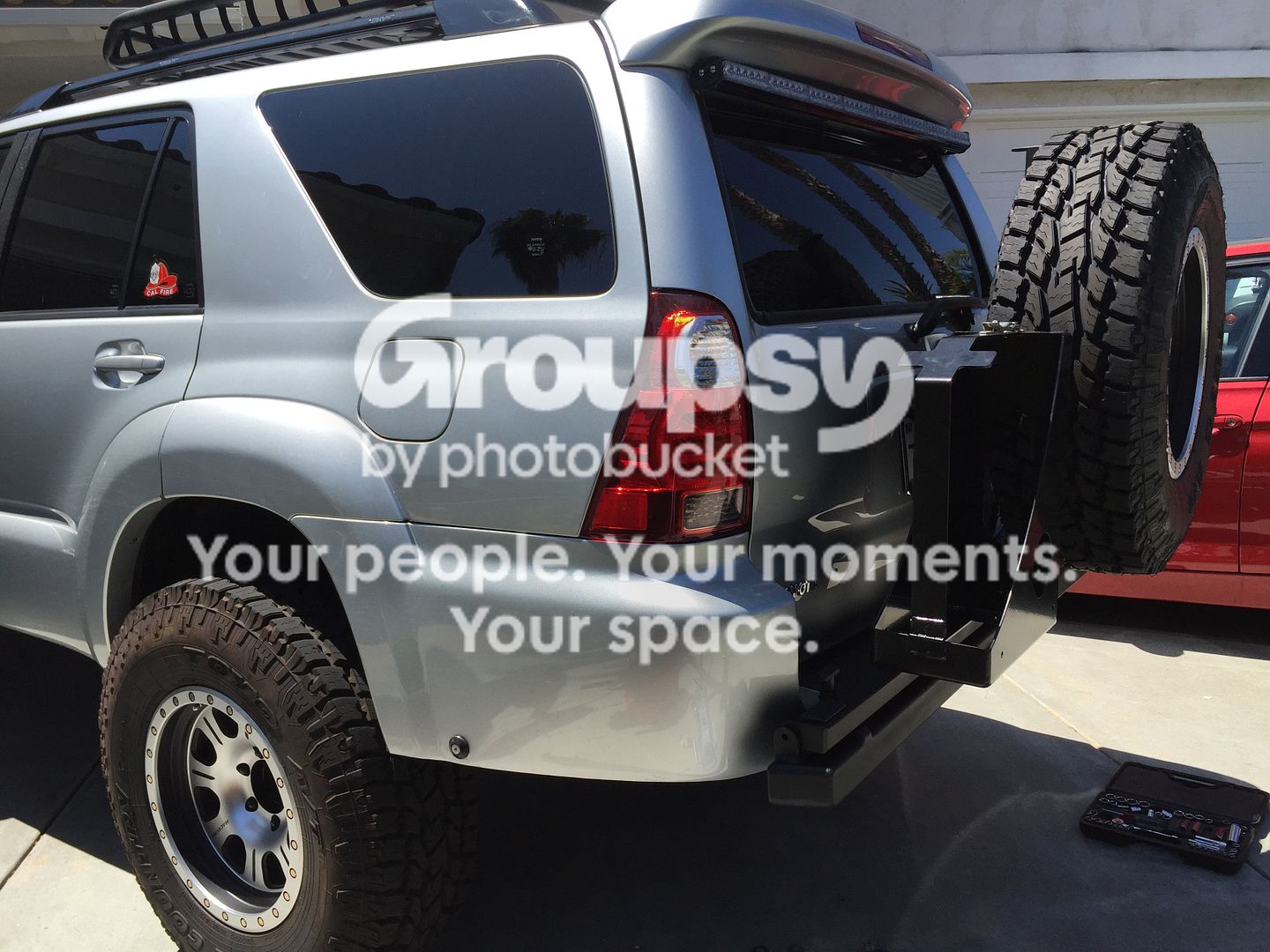

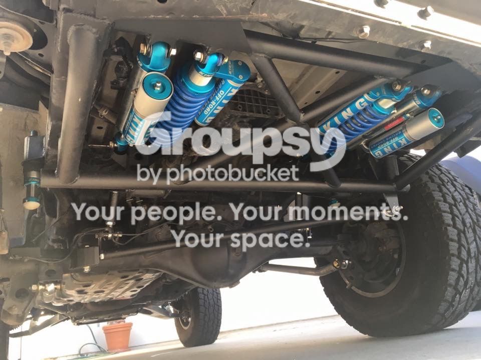

Now for the rear. Just got it wrapped up a few weeks ago. Still gotta do some shock tuning.
Also pics from an day ocotillo trip last weekend. iPhone beauties
IMG_6874_zpsyxa1ssug.jpg~original
IMG_6875_zpsbrxojdjy.jpg~original
IMG_6876_zpsdwbgdyzd.jpg~original
IMG_7036_zpsidlmjun9.jpg~original
IMG_7039_zps97c05ccv.jpg~original
IMG_7038_zps90b3dv5o.jpg~original
IMG_7041_zps35dtaaai.jpg~original
IMG_7037_zpsjhpi9jhe.jpg~original
IMG_7043_zpsd9ygydwg.jpg~original
IMG_7054_zpstiexmfao.jpg~original
IMG_7076_zpsxd6bmnyz.jpg~original
IMG_7089_zpslcgcvnhq.jpg~original
IMG_7087_zpsr2lqtl3h.jpg~original
IMG_7086_zpsmhrwntnn.jpg~original
IMG_7063_zps64c4eqi2.jpg~original
IMG_7065_zpsfcdfab4a.jpg~original
IMG_7064_zpsby4hwszc.jpg~original
IMG_7072_zpsisfsjkar.jpg~original
I decided I didn't need fiberglass fenders; until I saw yours. Love the custom touches, fantastic stuff! Very unique.
Holy christ on a bicycle. This build is AWESOME. Love the custom fab work. What a transformation from the beginning! Definitely going to be following this one.
Awesome rig!
Was looking through pictures excited to go back and see what front bumper you had. Saw it was custom, cried...
You have dimensions or anything of it?

Man, you've been holding out on us with this build. Can't wait to see where this goes.

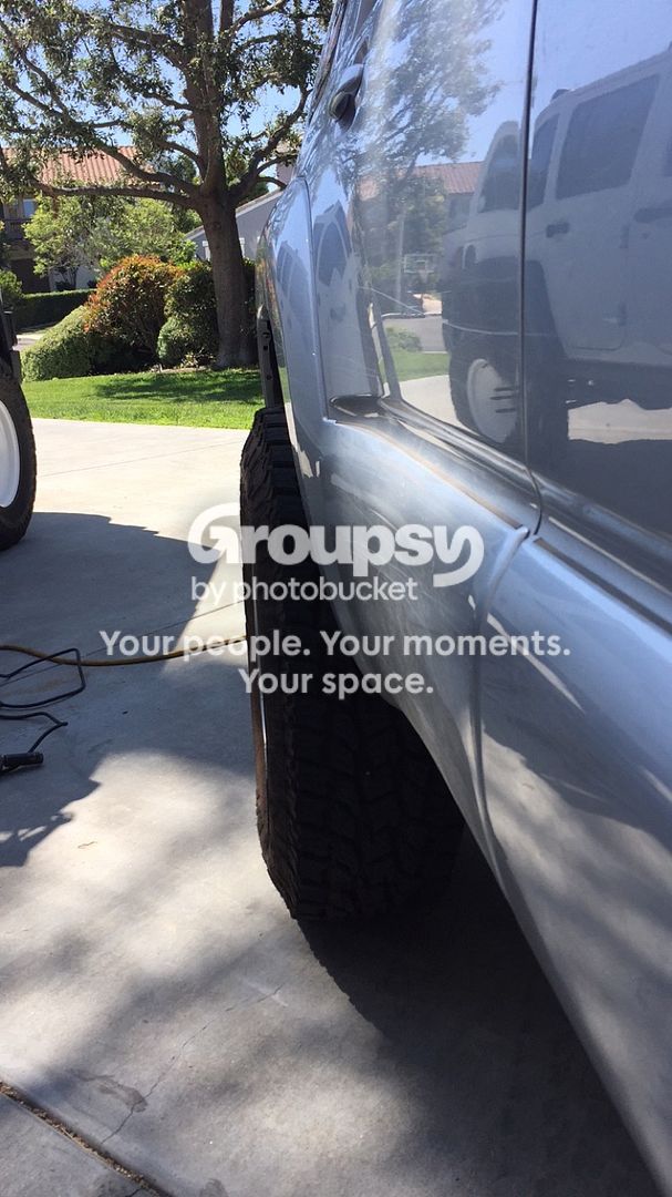

I do have a question though, how bad do the tires rub in the rear when stuffed?

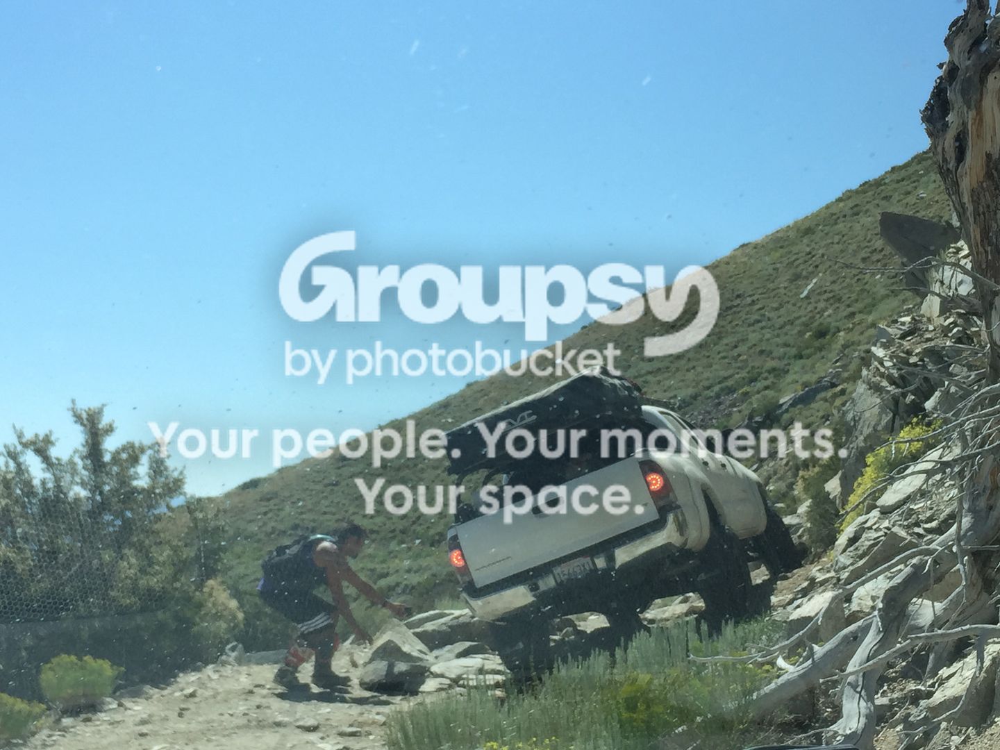

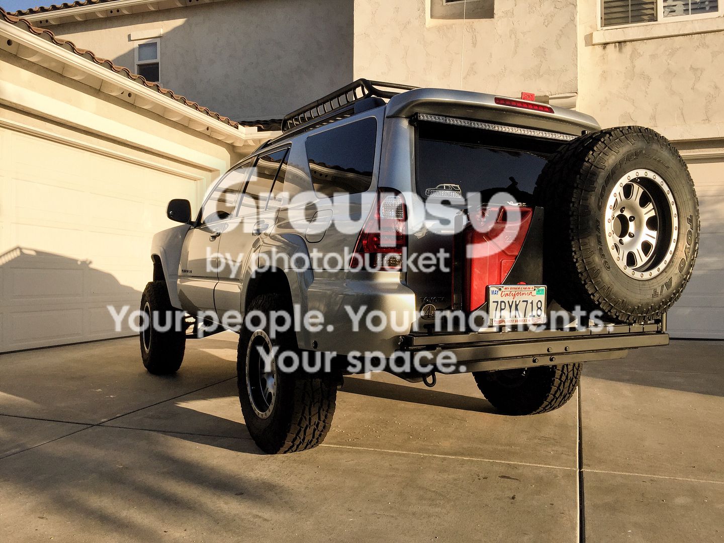

Not going to say anything different than the 15 comments before me...except.........quit your job and start mass producing the rear bumpers already? Also several questions from your pictures(which i love the photography), but did the Tacoma lose their RTT on a trail run? Also what are the wholes on the lower end of your rear bumper side skirts in the plastic?
