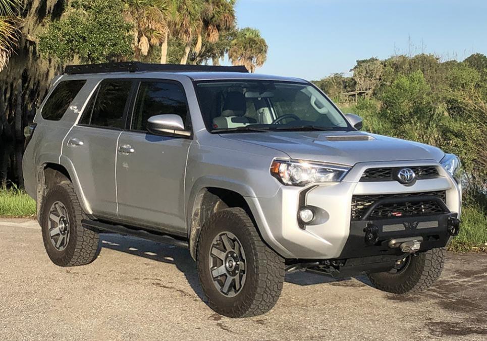

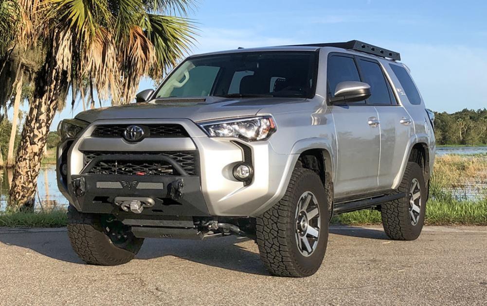

An aluminum bumper can be more than just for looks. I went with a Victory 4x4 winch blitz bumper in aluminum. The recovery tabs are 1” thick and they go through the bumper and are fully welded to the part that bolts directly to the frame. The rest of the bumper is 1/4” aluminum and has all kinds of reinforcements. If you don’t need armor for bashing into rocks the Victory bumper is plenty strong for winching and recovery.
Weight of my Victory bumper with the Warn VR8-S winch is about 85 pounds minus the weight of the factory bumper that it replaced for a net gain of about 65 pounds.
Only had the setup installed for 10 days and I already winched a very stuck 2wd SUV out of a ditch and everything worked just fine. The aluminum bumper didn’t melt away or turn to dust and the Chinese made Warn didn’t burst into flames. :biggrin2:
