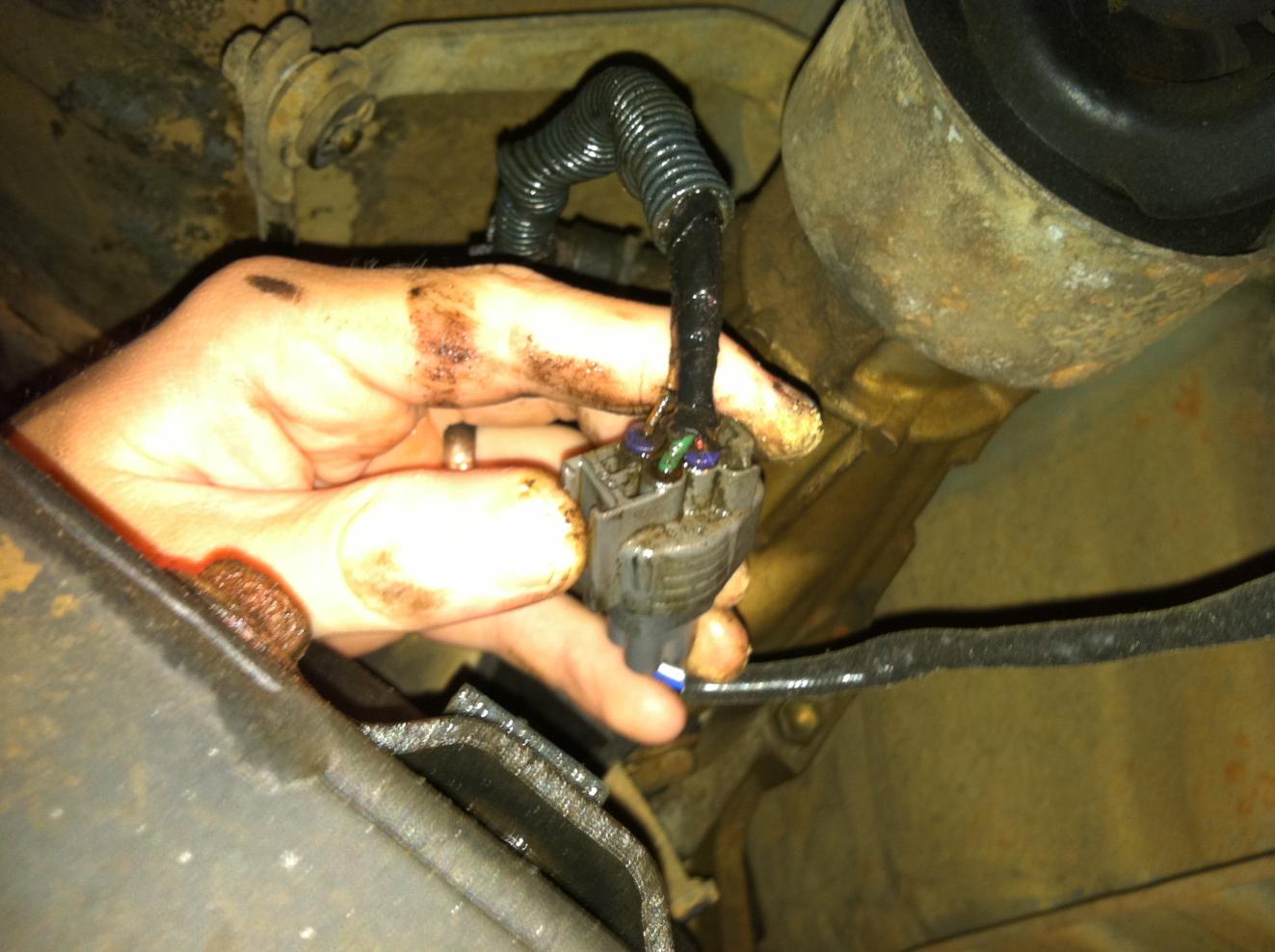

I'm having almost the same problem.
I'm throwing a P0136, "O2 Sensor Circuit Bank 1 Sensor 2." I replaced this post-cat sensor in January 2011, haven't even driven 3,000 miles since then.
I replaced it with Denso 234-4153.
I inspected the sensor wiring and the only thing that caught my eye was the presence of fluid on it. But this shouldn't cause it to fail right?
Should I too diagnose the same way with an ohmmeter? If so, which wires are B+ and HT?
As I understand it, (since I have not done it--only read about it), The URD sim will not correct a P0136. The sim requires a functioning rear sensor. It will only correct a P0420--Catalytic Converter Below Efficiency.
Try cleaning plug and connector with contact cleaner. An oil soak can definitely screw up a connection. The P0136 is an anomaly in the sensor voltage, not the heater circuit, so HT+ is not involved. An OBD scan tool will show you the output curve of the sensor. You need a '96 FSM to get the pin-outs at the FSM. Sorry, I don't have one.

Thank you for the info, I cleared the code today.
If it pops up again I'll clean it up and cover the junction with some conduit and electrical tape. I'll go from there..
