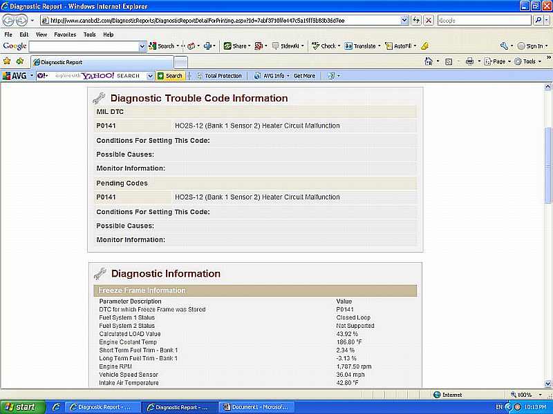

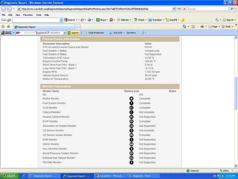

The first time I use the OBD2 I read P0136 and P0141 and I forgot to saved it and I erased it clear and I never seen P0136 again went check engine goes back on. This P0141 has been going on for awhile I did a research on P0141 I found out it's the 02 sensor after the catalytic. I want to be sure it's the right 02 sensors I’m ordering. Here is the report on my OBD2. Where can I get good price

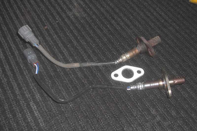

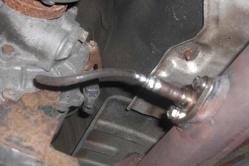

got the 02 sensor
Since nobody reply where I could get good price I ordered it here in Canada. Maybe someone up here in great white north need to know where to order there needs. Auto Parts Online Canada

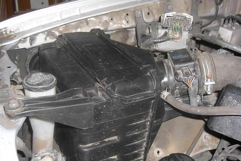

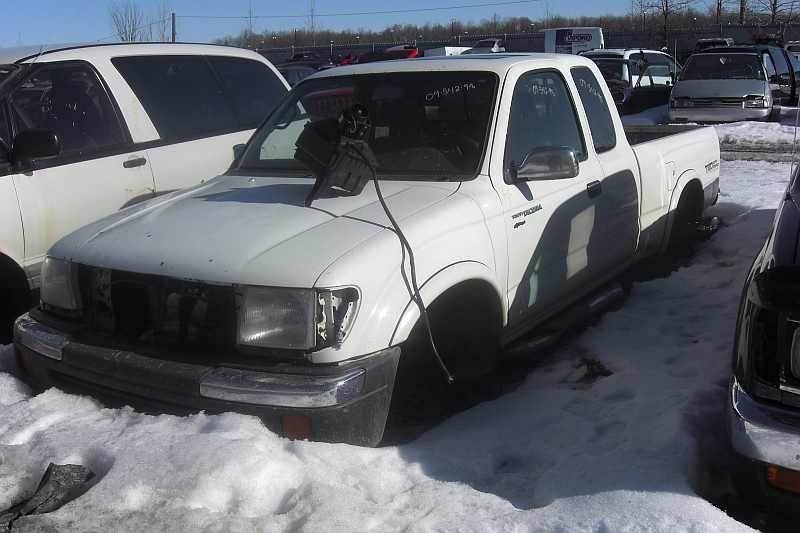

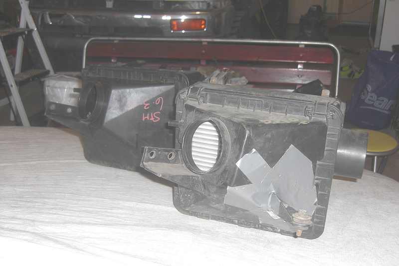

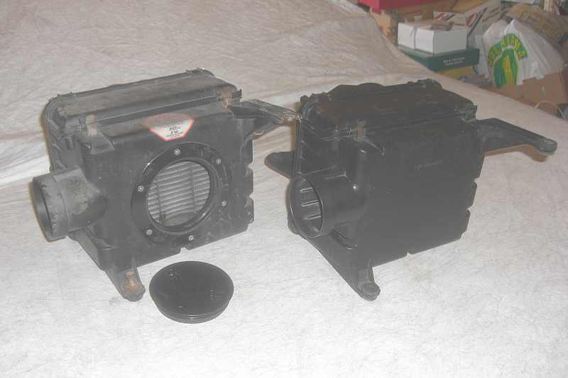

Some pics that I fixed today. I when to scrap yard I saw '98 Tacoma everything is gone but the one I need air filter box already unbolted and paid $50 Can. and stealers want's $700 +.....what a rip off.
