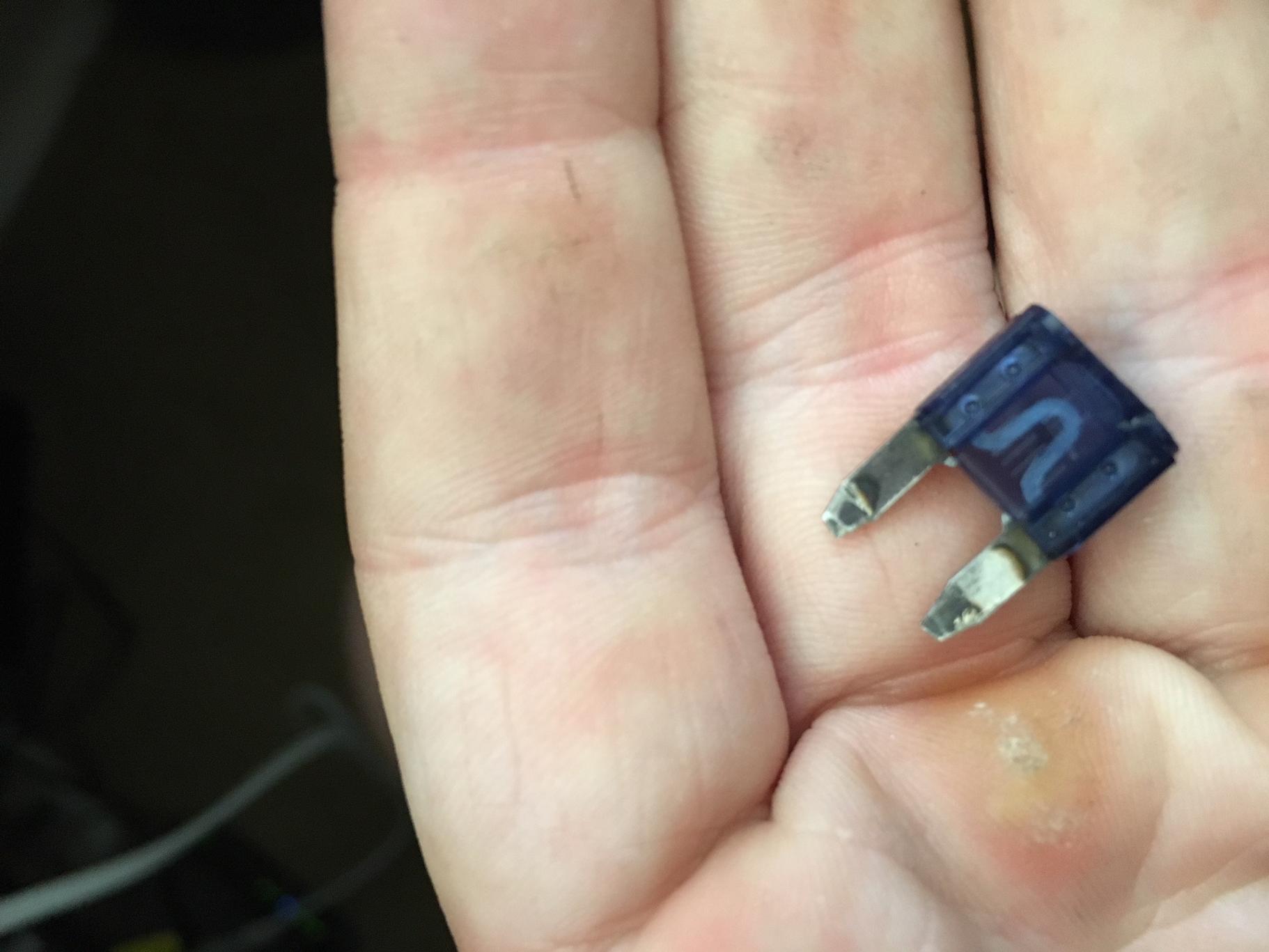

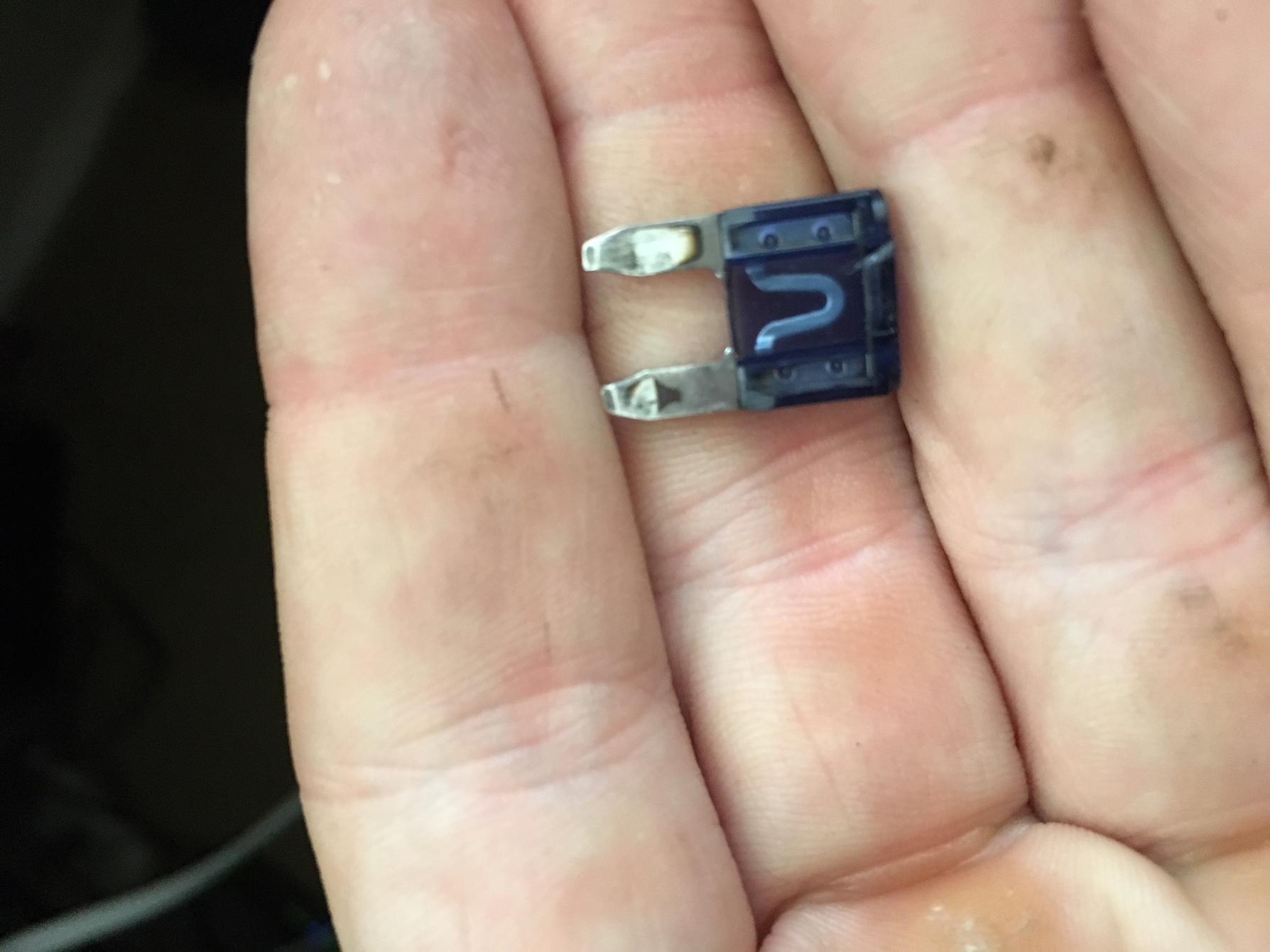

I replace it and the problem disappears. How I got to this conclusion is this:
Truck had a misfire. I pulled EFI fuse after I thought I had fixed it (spark plugs, wires, etc.) and it kept coming back after maybe 20-30mi of driving. In a moment of desperation I just tried a spare fuse I had laying around. No CEL for ~700 miles.
Then it came back and I put a whole new fuse in. Little 15's. Blue ones. Here ( image2.jpg)(image1(3).jpg) is a photo of the original fuse, I think I threw the 700 mile trooper away after swapping it out with a new one. It doesn't look /too/ bad to me, but I haven't seen any CEL yet and it's been over 100mi.

Both those fuses are OK and changing one for another shouldn't make a difference, other than perhaps resetting a computer thingie or something. Either they look like that (the u-shaped wire in the middle is intact = good) or they don't' (the u-shaped wire is obviously not intact=bad).

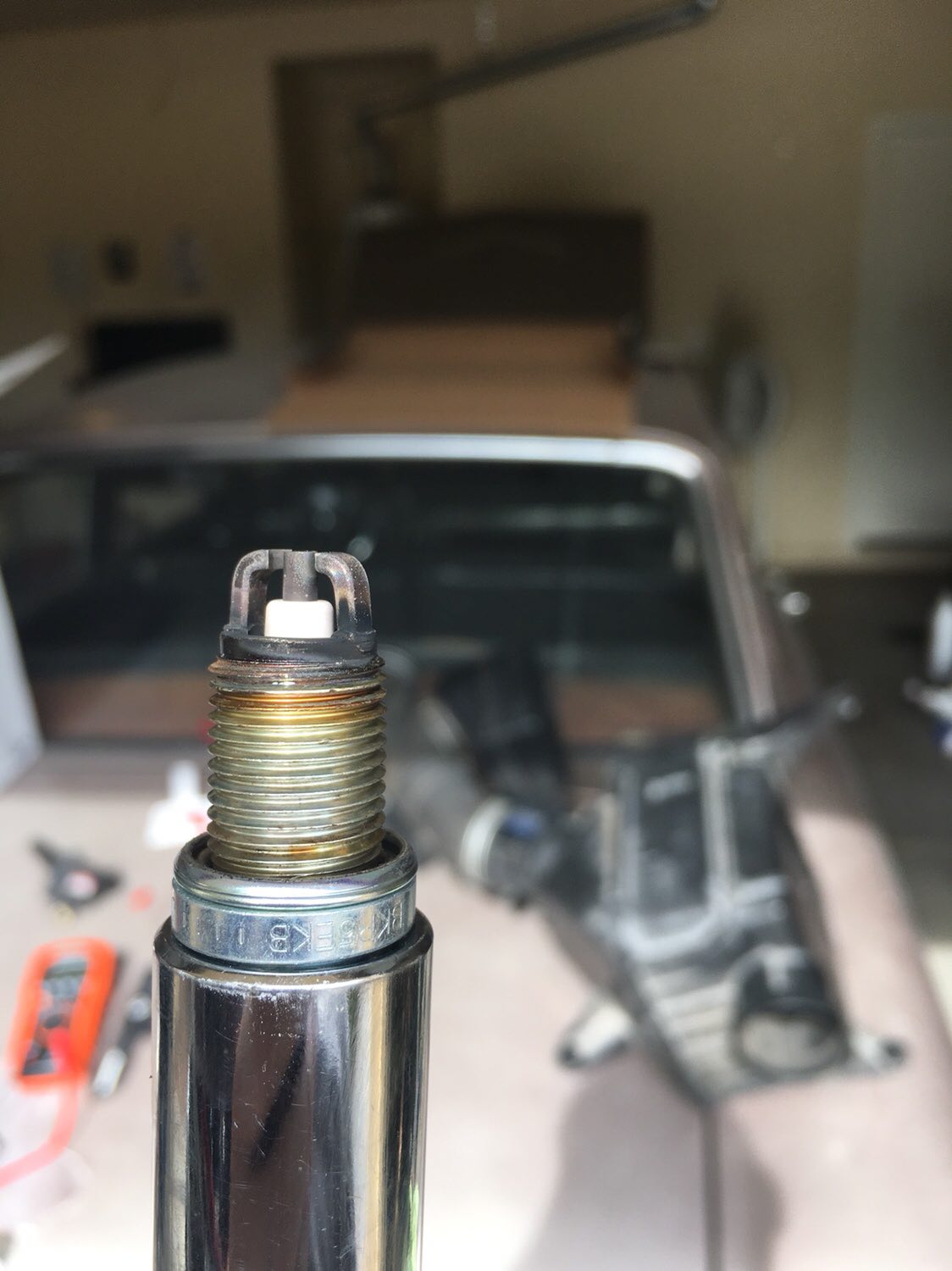

Ok, here are pictures of cyl 1 spark plug: IMG_2240.JPG

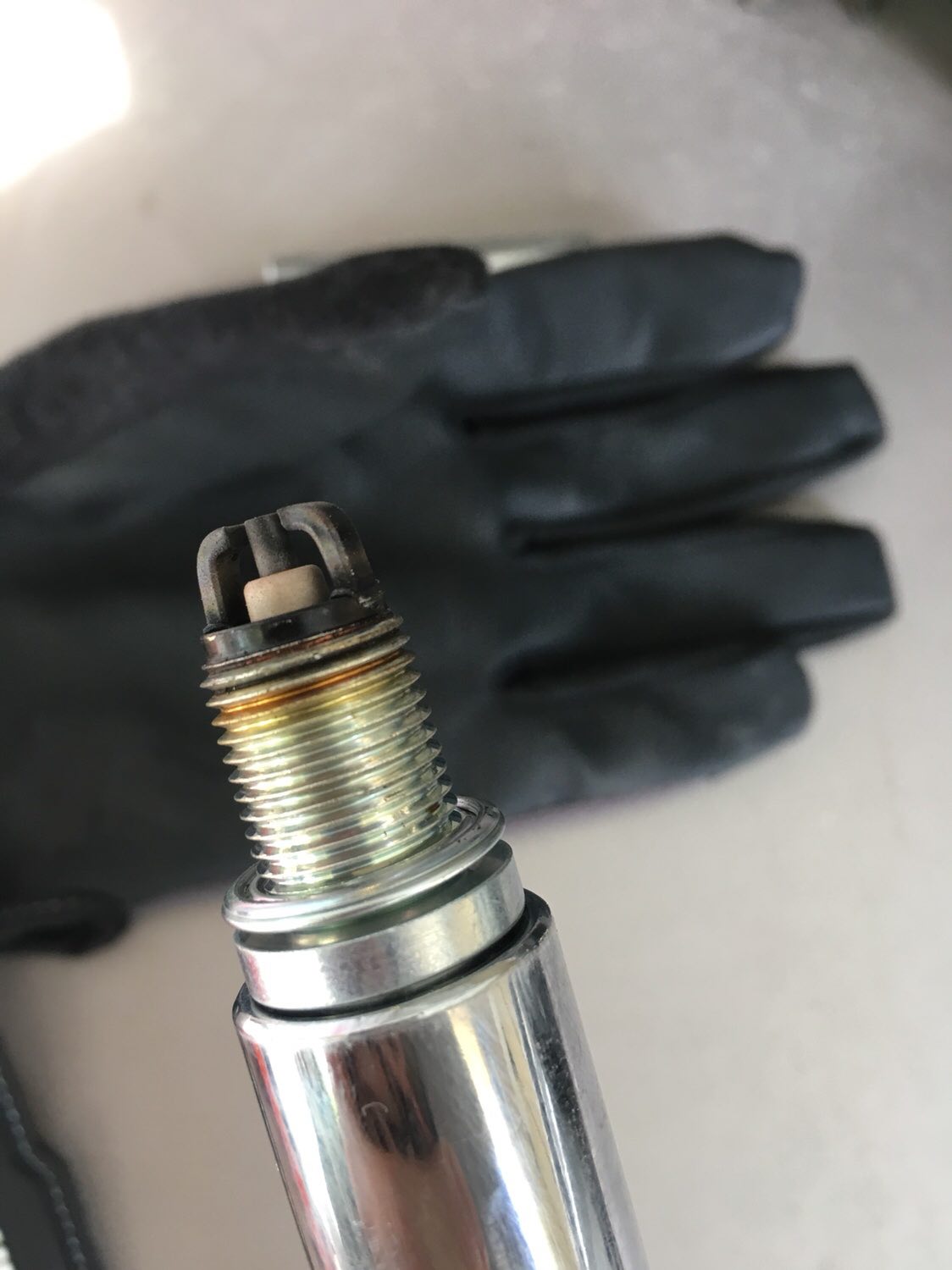

And cyl 5 spark plug: IMG_2243.JPG

See how on the cylinder 1 there's a powdery buildup on the two ground straps? That usually indicates a lean condition in the cylinder, not enough fuel.
