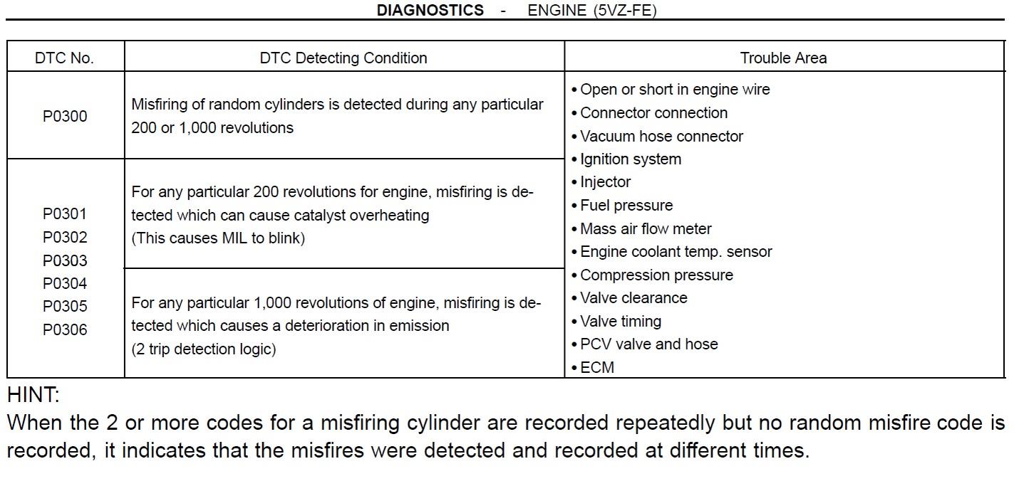

Today I threw 5 misfire codes, all in one instant:
300 (Multiple CYL, I think)
301 (CYL 1, I believe)
302
303
304 (CYL 4, I believe)

The last number of each code identifies what cylinder misfired. So 301 = cyl 1 302 = cyl 2 etc.
