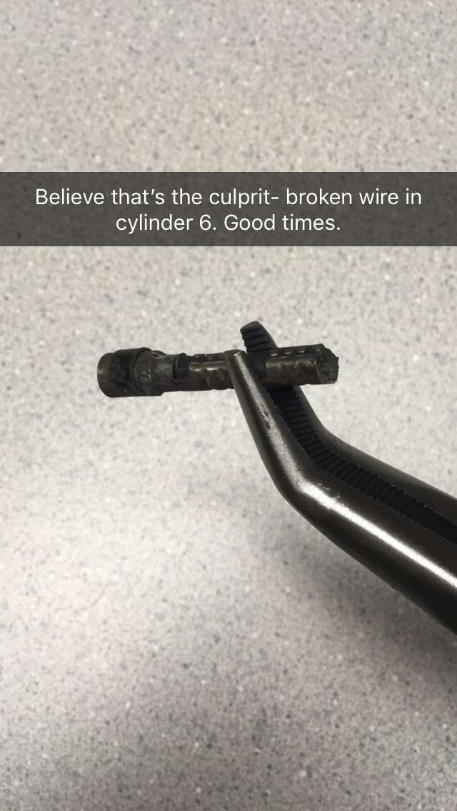

Much appreciated! Tried that, but had no luck. Pulled it again, this time pointed my light down the hole and noticed this:
