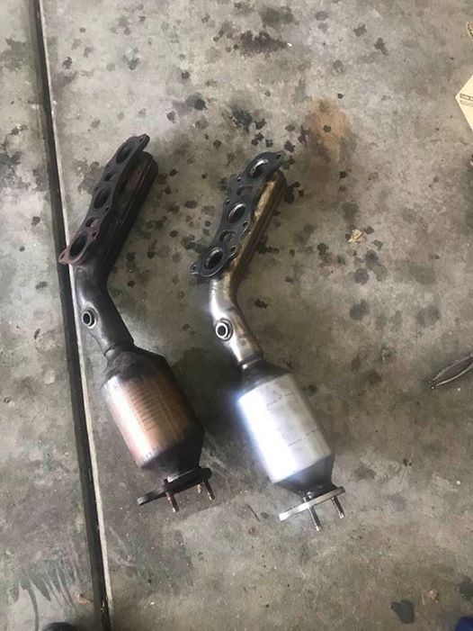

Changed the converter today, prices weren't bad which I bought at Steven's Creek Toyota and they had the parts ready. Took the whole day job and I was going to film it for youtube but camera died. I'll post later on when the vehicle reaches 200 miles and see what happens.
Okay, 1,500 miles later, looks like the P0430 code isn't popping up yet. I checked both gasket on the front and the end of the manifold/catalyatic converter so looks like this issue has been resolved. Hopefully the vehicle will continue up to 300,000 miles.
