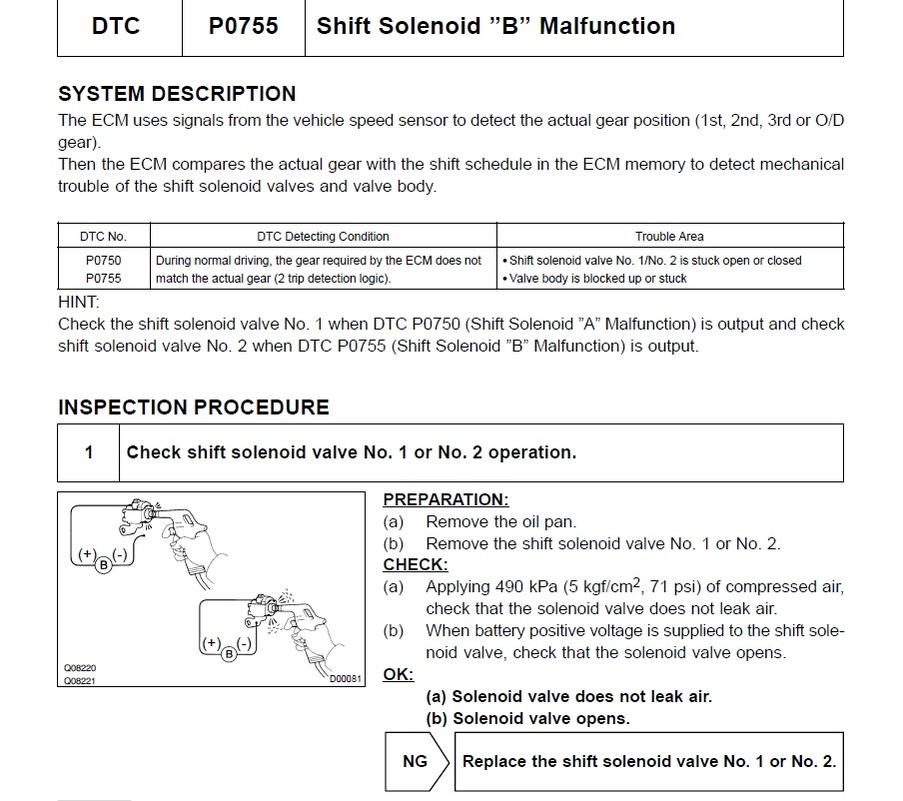

Hey guys, does anyone know which of the three solenoids is shift solenoid B. If I were to take an educated guess I would say its the middle one, but just to be sure I thought see if someone who may have dealt with this code before has any more information. Thanks.
Between the FSM and this thread I'm linking hopefully you can figure it out. I think the P0755 points to solenoid #2. Where that's at on your valve body depends on what year your runner is and your sig doesn't say.
The thread I linked has multiple pics with numbers on the solenoids. I'm not sure that they are right so venture at your own risk...
http://www.toyota-4runner.org/3rd-gen-t4rs/92433-trans-shift-solenoid-sl-identify.html
